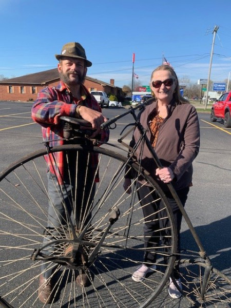

I have ridden high wheels since I was a teenager but this one is going to take some practice. It is completely different from a regular high wheel.
. I hope that the attached picture loads but if not, look up an American Star High Wheel bicycle. There are a couple of videos on YouTube.
