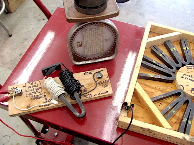

Here is older thread with good info.

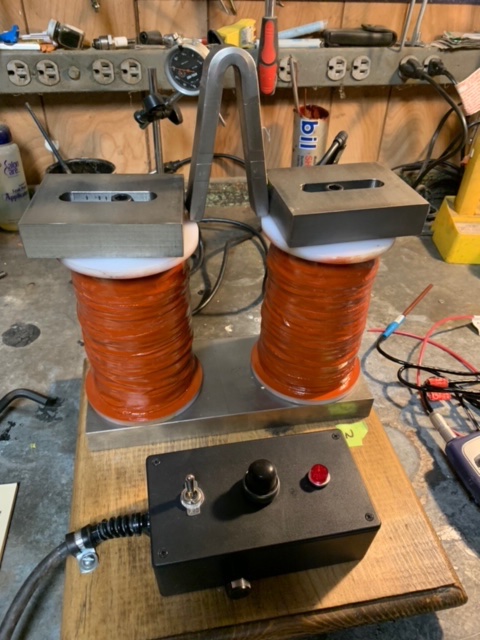

Have built a simple reverse coil wire wrap, 2 coil charger that the horseshoe magnet slips into. Wire was sourced from a 20amp circuit Romex cable, about 4 layers wrapped over a support tube to fashion the hollow coils about 5” long.
Used 10amp 12v Battery Charger for power source. 10 or so quick flashes provided enough energy absorbed to allow a single magnet pull 4+ lbs. up and hold.
Click on link:
https://www.mtfca.com/phpBB3/viewtopic.php?t=26511
Click on link:

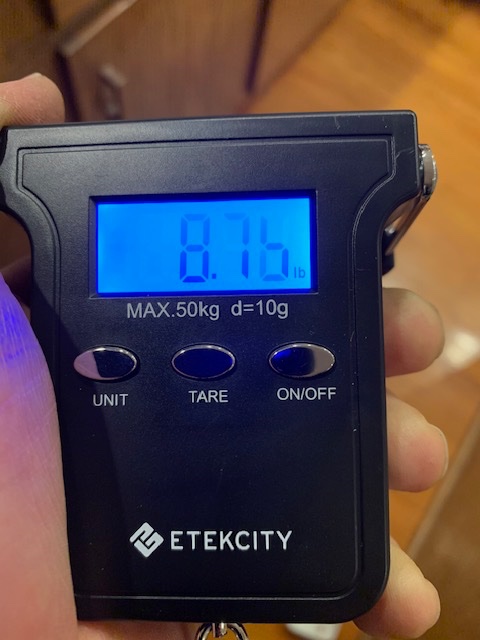

I did some experiments for myself and found the following solution. I got the best charge with a coil made of a thick power cable. I supplied these with a DC welding system and charged the magnets. I now use a larger welding system than in the picture.
The magnets immediately lift about 11 pounds, which is a lot.
It takes some patience. The cable gets warm and needs a break every now and then.
There are certainly other solutions. I think a device made of strong rare earth magnets would be interesting.

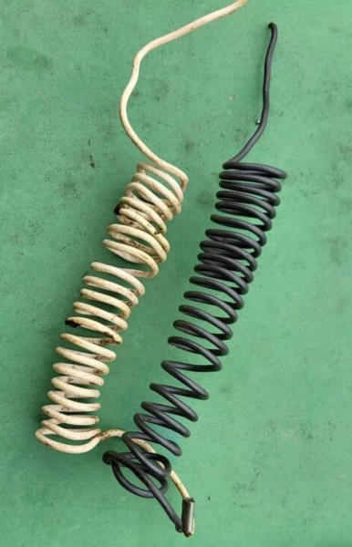

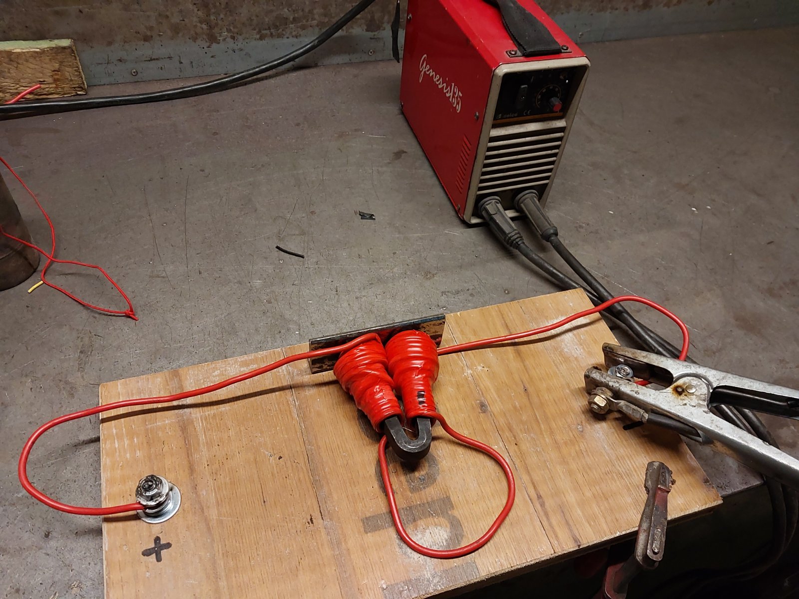

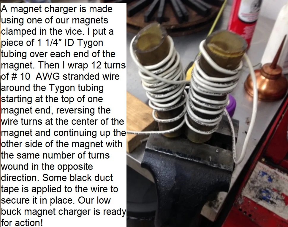

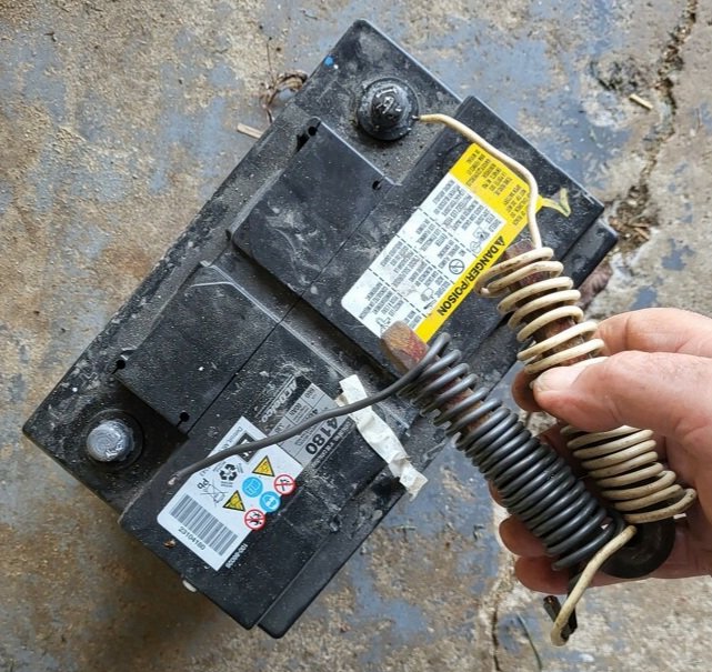

I charged my magnets using number 12 house wiring and a car battery. The individual insulated strands were stripped out of the Romes covering. 21 turns on each side of the coil. One side of the magnet has black wire, the other side has white wire in order to keep track of polatity. Used a 12 volt car battery to give it a quick flash. I tried 18 volts and all it did was melt the end of the wire and it didn't improve the strength of the magnet strength. The results have been very good. The engine starts easily on magneto when hand cranking.
I would post a picture, but don't know how. Again, maybe Tim wrenn can assist.

And indeed I will!!Art M wrote: ↑Thu Jan 18, 2024 7:26 pmI charged my magnets using number 12 house wiring and a car battery. The individual insulated strands were stripped out of the Romes covering. 21 turns on each side of the coil. One side of the magnet has black wire, the other side has white wire in order to keep track of polatity. Used a 12 volt car battery to give it a quick flash. I tried 18 volts and all it did was melt the end of the wire and it didn't improve the strength of the magnet strength. The results have been very good. The engine starts easily on magneto when hand cranking.

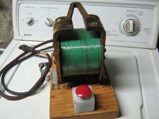

- Posts: 5589
Re: Building a magnet charger, looking for information

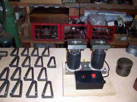

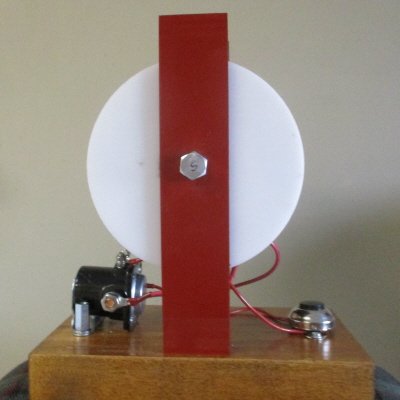

I built mine up many years ago from plans by the fellow named Gingery - does a great job !
- Attachments
- magnet charging.JPG (33.04 KiB) Viewed 9560 times

- Posts: 3743
- Last Name: Wrenn
Okay here's two pics from Art!

Geee Art,
That is a dangerous way to flash your mag coils, have you ever seen or been near an under load or being charged battery when a naked spark has ignited the acid gasses put out from the battery ? My magnetiser would on the end of a set heavy duty jumper leads with my safety glasses on. ....n
JohnH
- Posts: 377
- Last Name: Hunter
- Board Member Since: 2002
I was just going to say the same thing. Sparks at or near terminals of lead acid batteries make me nervous.Poppie wrote: ↑Sat Jan 20, 2024 4:32 amGeee Art,
Art M
- Posts: 987
- First Name: Art
- Last Name: Mirtes
- Location: Huron, Ohio
Your right about the dangers of gas generation. I have a friend whose car battery exploded sometime while using a battery charger.
When charging by my method jumper cables should be used.

- Posts: 5528
- Last Name: Hatch
- Location: Alabama

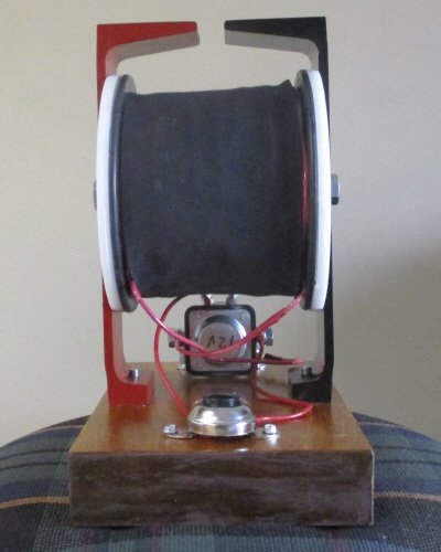

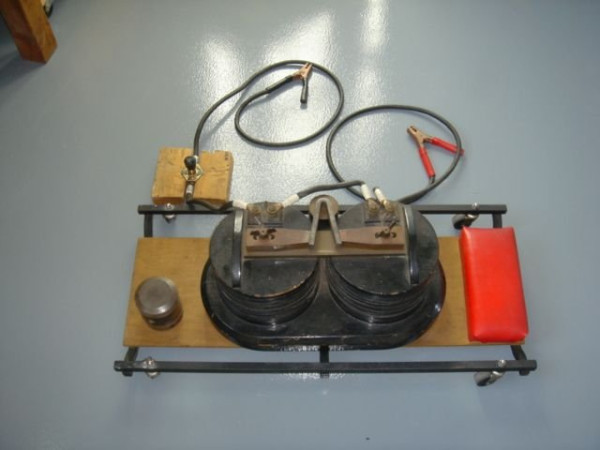

Here is mine
I didn’t make it. Got it from Hank when he quit the T game.

I still like my method of charging magneto magnets, with thr exception of being too close to the battery. I recommend using jumper cables between the battery and the charging coils.
The coils are easy to wind. The required material is easy obtained and is very affordable. Pictured are shown above in a January 19 posting.
My car starts easily on the magneto when cranking by hand.

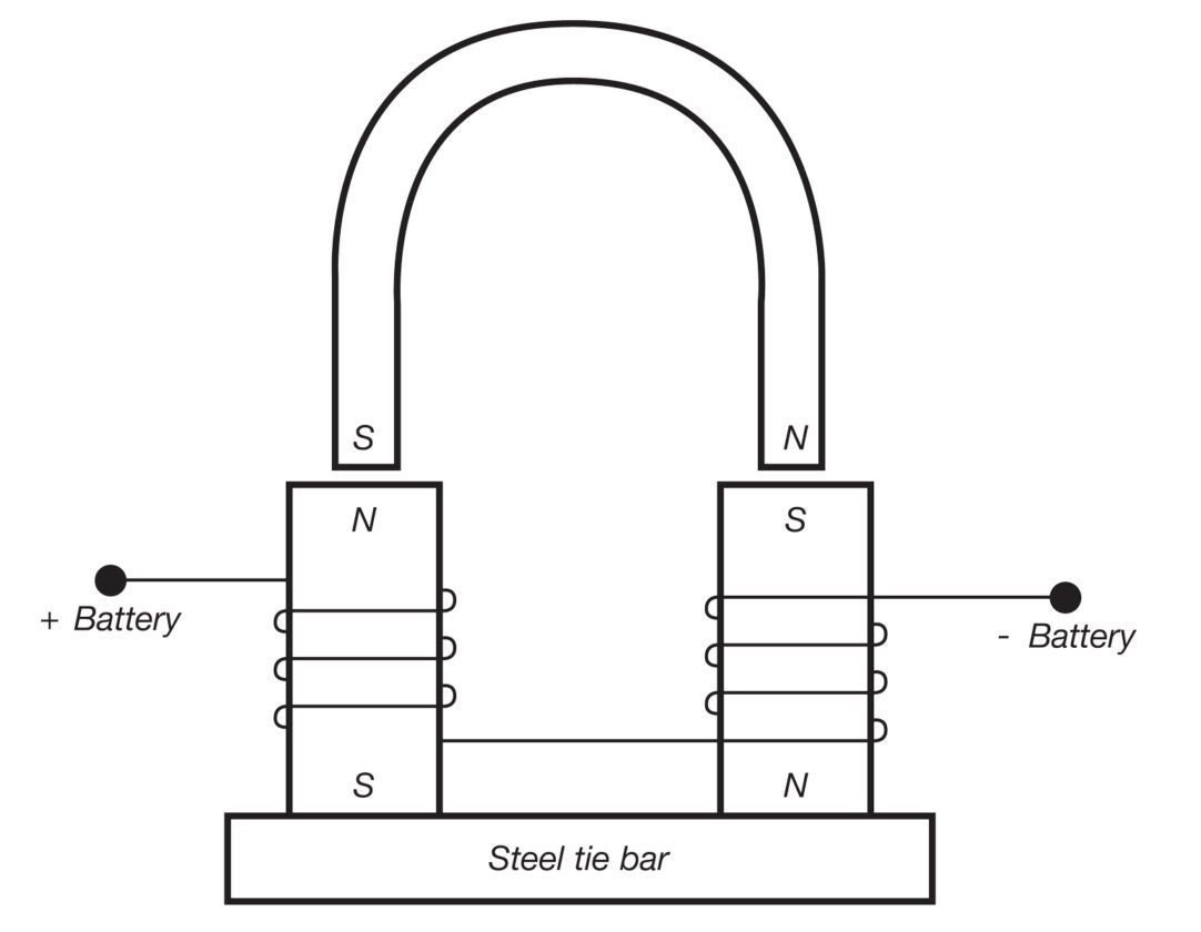

Here is a sketch of how to wind the coils on the charging electromagnet.
Respectfully Submitted,
Be_Zero_Be
Be_Zero_Be

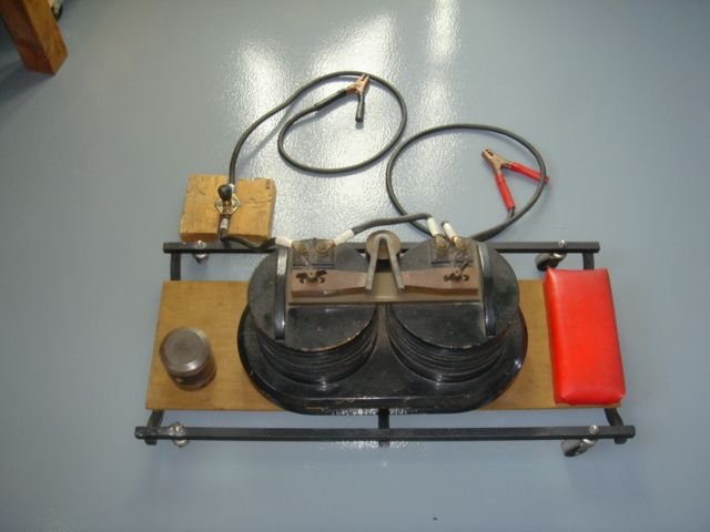

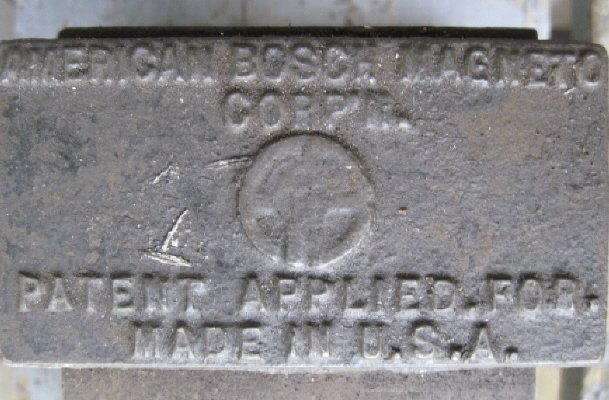

Ron Patterson

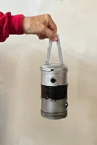

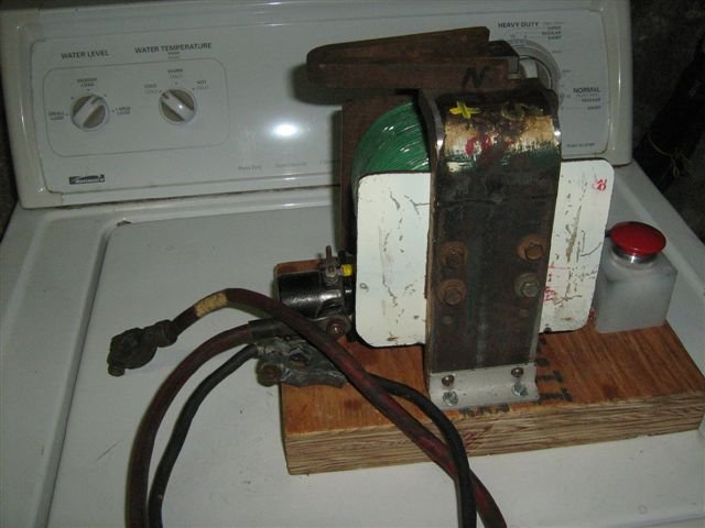

Here is a photo of the American Bosch Model T magnet recharger I had.
The critical issue fully saturating the magnets. Ford recommended a 5000 Ampere/Turn recharger
When we applied 24 volts DC to the device in the photo and measured the ampere/turns it was over 11,000 A/T per electromagnet leg.
Ron Patterson
Ron Patterson
J1MGOLDEN
- Posts: 1322
- Last Name: Golden
- Location: Bowie, MD

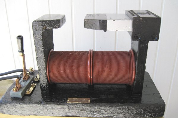

I have an American Bosch Magnet Charger too!
This came out of an old Ford garage in Maine about 40 years ago.

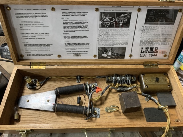

TFan
- Posts: 415
- First Name: Jim
- Last Name: Riedy
- Location: Sandusky,Ohio

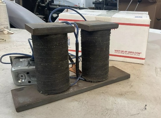

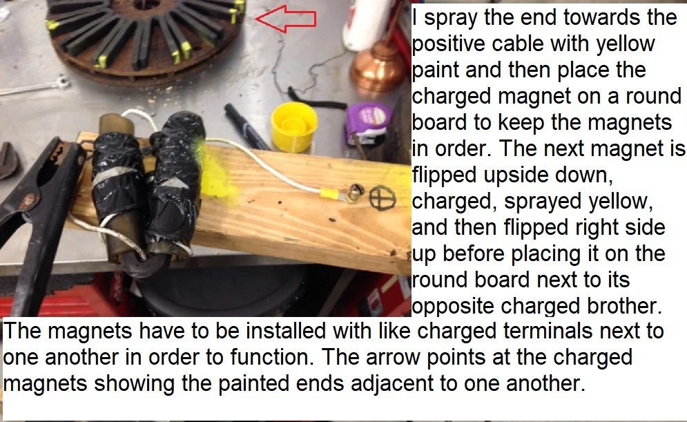

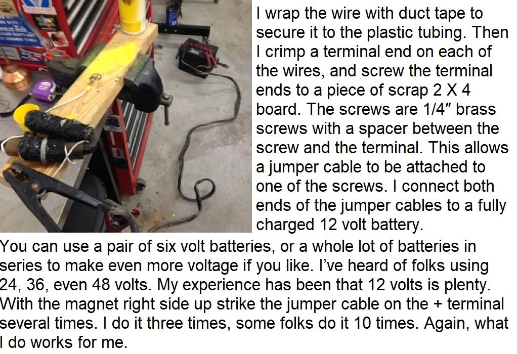

Well since everybody seem to be showing theirs I might as well also. I charged my magnets after first demagnetizing them it seemed to work much better that way. Got em all charged up and are in my newly rebuilt engine and running super. I used a 36volt golf cart battery charger for juice. Jim

I’m enjoying seeing all the different chargers out there as well. Here is the charger I built, each coil ended up with 1700 turns. I’m running this off 120v AC with a 25Amp rectifier so coils have 120 DC on them, takes a few seconds to reach peak and measured she is pulling 6.3 amps.
According to plan the coils were to have 7.5 amps peak x 1600 turns=12000 amp turns however I measured 6.3 amps with 1700 turns so mine measured 10,710 amp turns. So still should be plenty.
I do measure the pull on each magnet, there can be a little challenging since the contact surface is not flat. I bent a strip of steel to try to make best contact, then hang a digital meter and pull until the magnet breaks. I typically see them saturate at around 8-10lbs but they will settle to 6-8 lbs.
Anyone else measuring the pull on the magnets? Would be interested to see what everyone else is getting.

Here’s my mag charger that I just bought. Haven’t used it yet, looks like it should work fine.

Jim, this is one I made, and it works with a 12 Volt battery.
I was told I should not have used plastic coated wire and should have used wire coated with a non-conduct metal.
If I give three quick zaps with the magnet like you are showing, then flipped it over for three more saps, and then stood it up for three more zaps, the magnet worked fine in an engine.

- Posts: 7411
The traditional test is holding a cast iron piston (two pounds). My second charging, with a pair of coils and the magnet inside, resulted in holding four to six pounds. I figured that was good enough. The link Mark posted is for a page that shows both occasions, the first with a single coil and the second with two.
https://dauntlessgeezer.com/DG88.html
This photo was one of mine.

This may just be a rabbit hole but once seen something about using a diode in the supply line of a growler to charge magnets. I suppose you
could do the with a magnaflux yoke but that's a $600+piece of equipment you are fooling with not $40 swap meet growler. Any truth to that??
