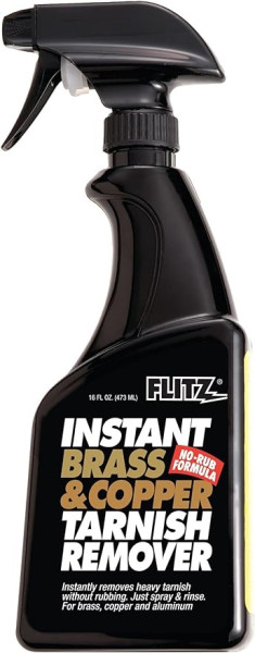

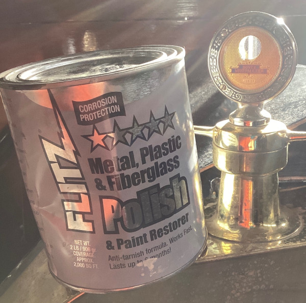

As usual....pictures? I mean like, are they THAT bad!?? No offense...maybe they were painted? When you say "black"...all I know is in all my not so perfect experience with abused brass, and I'd like to think I've seen my fair share, I've never seen any so bad and black that it's that problematic to bring it back up. That said, I'd love to see how that "Flitz" works that Ed sent you the pic of. Try it, you be the guinea pig and let us know!! My last "brass rejuvenation" on my former Torpedo took me two tubs of Blue Magic, a full week at about 6 hours a day and a lot of sore fingers!! But man did that brass look good when I got done. But, it wasn't "black" either!

I’ve used the Flitz tarnish remover, and I was pretty happy with the results. I really love their polish. It is an excellent product. Be a little pricey.

The Flitz stuff is simply amazing. Spray it on, tarnish disappears. It has to be throughly rinsed with water, then the parts polished. I have not tried it on extreme cases of tarnishing, but am thinking it would work well.

I have used Flitz polish for close to 20 years but the lamps that I got with the car have never been polished since day one, that is why they were black. I simply don’t have the time or ambition to bring the shine up properly as I would like, that is why if they were done professionally, I could maintain them. I will call the company in San Diego today.
