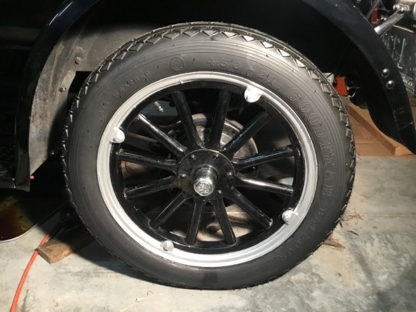

the wheels are 21 inch with split rims on a 1926 model t ford it is good to have someone to ask thank you bernie

Have you had the rims off of the tires? You have 21” split rims. When you change the tires for new ones take car how you treat the split rims removing the tires off and on. The split rims can be sprung and out of round when using pry bars the wrong way. They not the same as a modern steel wheel and fairly flimsy! ! Today’s tire shops aren’t familiar with these types of rims so they need to be careful!
If the tires haven’t been off for many years they could be rusted and pitted. That usually happens for most T’s with tires that haven’t been replaced in a long time. Good luck with your T!

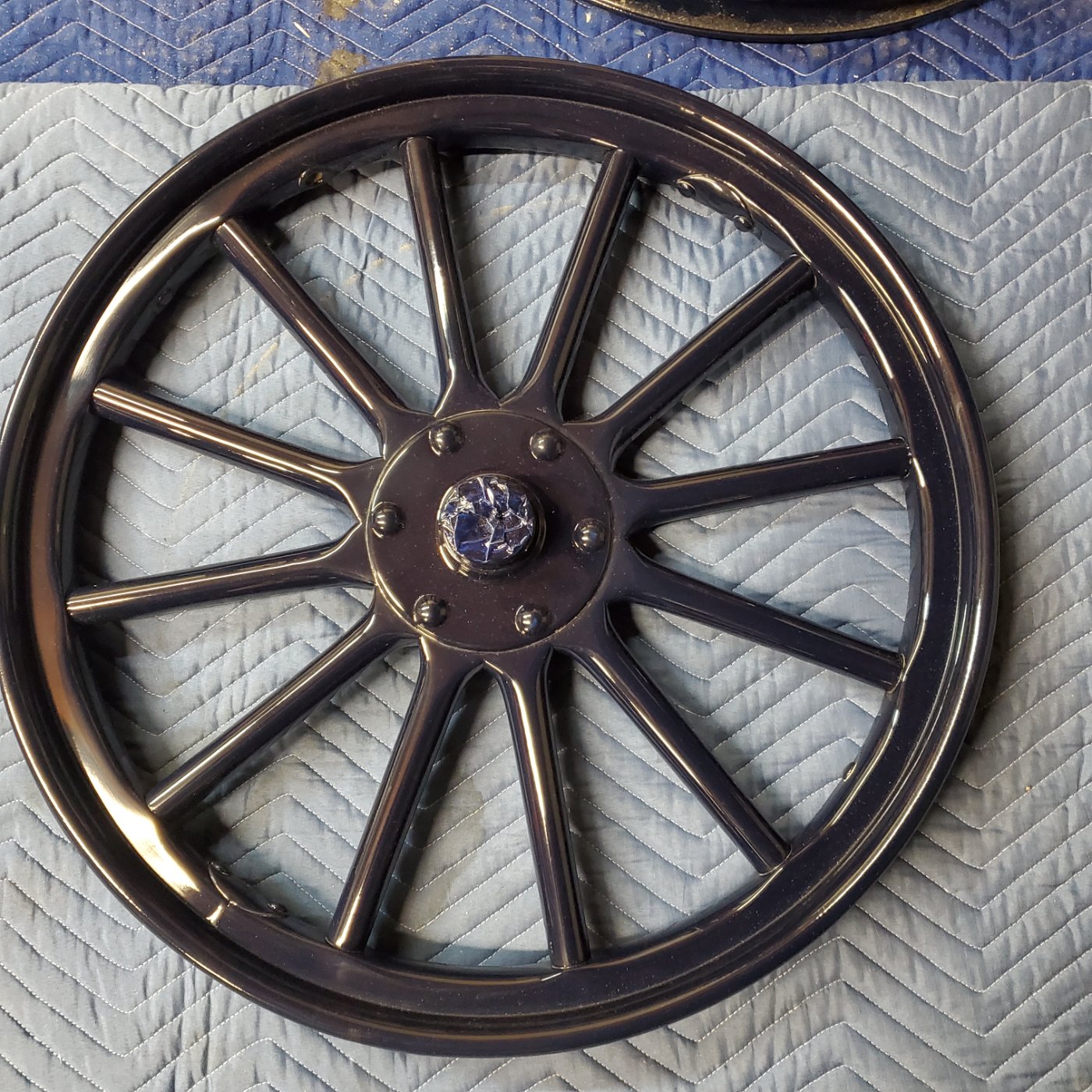

Wood felloe wheels can be restored if the wood is sound. There have been a number of posts explaining the method. All four wheels on my 12 roadster are reworked originals. I personally agree painted wheels are more attactive than stained, but they are a ton more work.
