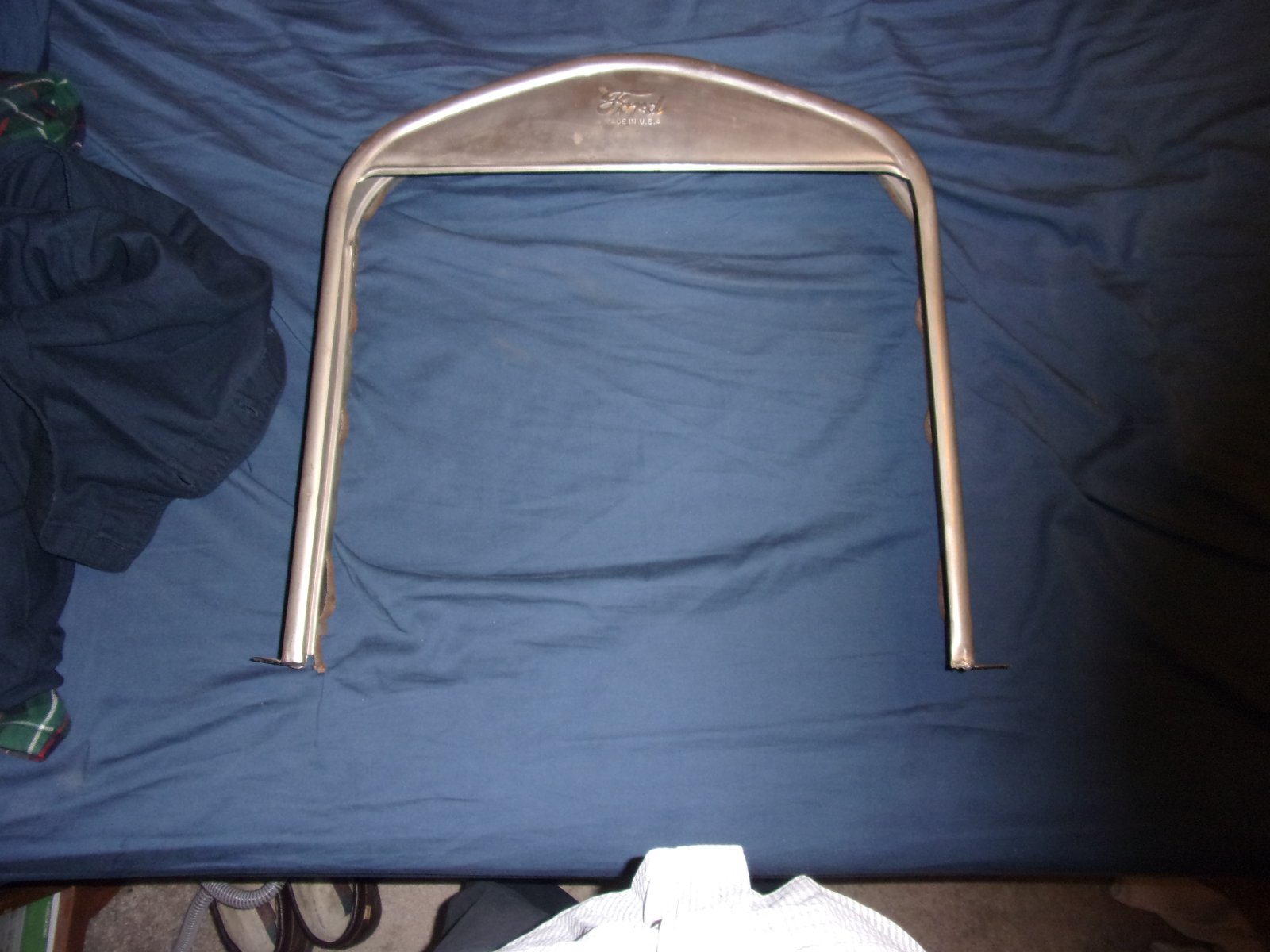

Dave, I lost yournumber call me. I have a decent, one blister, nickle plated shell that I was going to paint over for my ambulance. Seems a shame to waste this under a coat of paint. If we can figure out how to cosmetically fix your crack, I'd swap you shells as I'm just going to paint over it. You can have my shell and it might be acceptable as is or simply a plating job away.
I'll try to take some pics, but it may show up in my Utube stuck valve videos on another thread.

Dave, pics sent to email. I think you'll be happy with this one.
