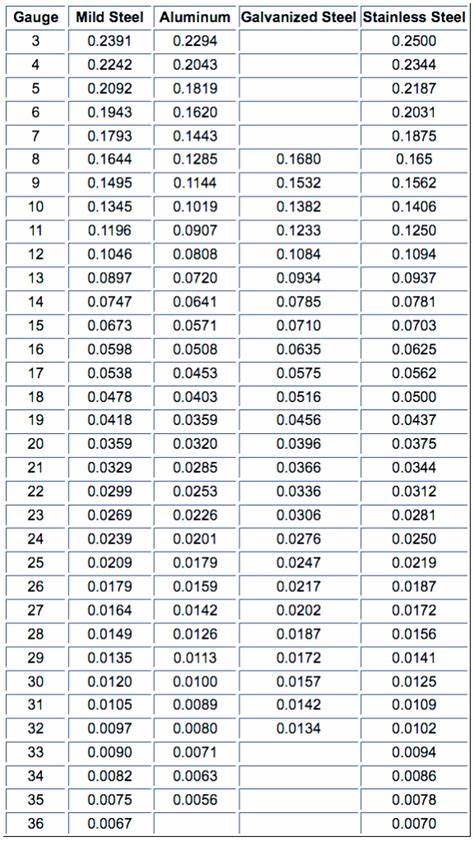

I have to repair my fender and I was wondering what gage is the steel?

I read where the fenders are 18 gauge. You can be sure by using calipers to determine the exact thickness and, using a conversion chart, determine the gauge. The lower the gauge number the thicker the steel. Jim Patrick

.041 steel is 19ga. Used for automotive fenders for a number of years, but not commonly available at tin shops today.
.069 is 15 ga
.087 is 13 ga
Typically most steel supply houses stock the even gauges in cold rolled steel, like 20 ga, 18 ga, 16 ga etc
