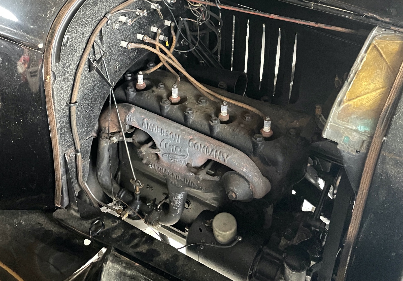

So, had engine running a few years ago and then put the 27 Depot Hack away for body restoration. Bringing it back to life as WWI ambulance and want to get running chassis as good as I can before all the wood work.
Reconnect everything, engine mounted coil box, throttle and timing rods connected and combination priming choke rod and lean adjustment rod connected. Initial attempts indicated fuel pouring out of gaskets in Holly NH carb, so replaced all the gaskets and gave carb good cleaning but not a total rebuild.
Current attempts cause backfiring at carb on a regular tythem stroke. I tried to read a little about back firing causes and I get lost.
Is it all adjustment combination related and if I don't burn the shop down first, I'll trial and error the adjustments? Or, is it a valve remaining open and ignition getting back to carb instead of staying in cylinders? I will gladly pull the head if I have to, but don't want to if we think there is another direction to go in.
I can have the wife go down and take video if that helps ID the issue, but I really don't want to run this too much in this condition.
I'll monitor post and respond to any questions and will gladly report back results of further testing or correction.

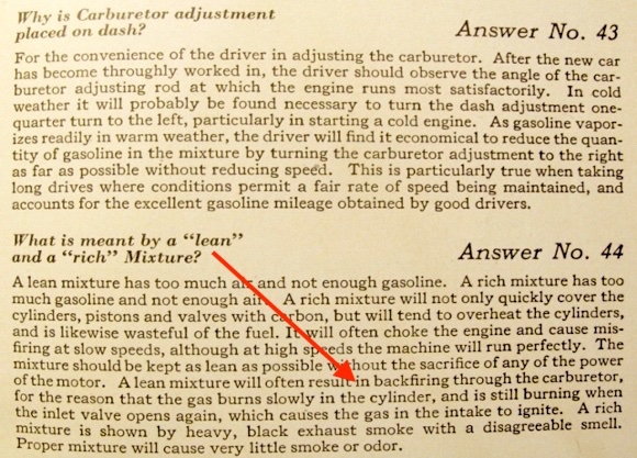

Spitting through the carburetor is usually caused by too lean and popping in the exhaust is usually caused by gas going through the exhaust valve and then firing when it hits a hot manifold. Also a vacuum leak in the intake manifold can cause some cylinders to be lean while others are too rich. So check for input leaks on the manifold gasket.

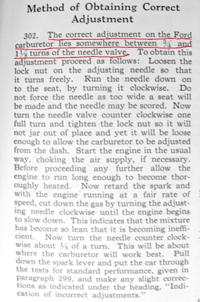

Likely the carb is the issue. If leaking, the float may be too high, and the gas puddle isn't right or the valve mixture is off.attempts indicated fuel pouring out of gaskets in Holly NH carb, so replaced all the gaskets and gave carb good cleaning but not a total rebuild.

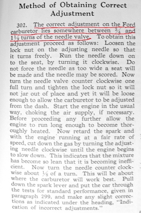

For at least a good in repair NH, initial setting is 3/4 to 1 1/8 out. Too lean with cause backfire, or sputter on starting.

Good info from Dan on the carburetor adjustment! Most every T is in that range of adjustment or pretty close to it but not all are the same. This is an important point to learn when learning about Model T’s. I have 3 T’s and each has a slightly different adjustment but they are somewhere between 1 1/8 to 1 7/8 turn but that’s my cars others may be different.

John, that's true. Some carbs have worn down needle or seat, that can make a larger range needed.
Also, important instruction by Ford is to secure the nut on needle valve shaft, or your adjustment can walk away on you!
Helped a fella couple weeks ago, his nice '22 from is grandpa is now his. So learning was needed. He claimed it started up fine but now runs real bad. So I took a look after starting, and let the motor warm up some. Yep, ran a bit rufff!
So twisted the carb needle flange a bit, and the motor smoothed right out. Then tightened the nut for more resistance to drift.

Here is Utube link of attempting to start. Battery is 6v with 00 cables and good ground, so bogging down of starter feels like compression, not battery. I probably won't be able to do much testing until Saturday but I did disconnect 2 and 3 plug and no difference other than it did seem to spin more freely. Connected 2 back up and left 3 off and same as original condition.

If you want to check the valves in #4, you can remove the spark plug to see if the intake or exhaust valves are not working. If the intake valve is not closing, #3 would not give any power as well.
This has happened to us when the #4 intake valve retainer failed. If either intake valve fail, both 3 and 4 quit working even though the other intake valve is ok.
If the intake valve is stuck, rotate the motor by hand and push down the stuck valve several times as you rotate with some lubricant and it should eventually start to work. This should be easier that opening the valve cover.
Nick
Nick

So, we were able to get back at it today. Pulled valve cover and gasket and, yes, intake on 4 was stuck open. I got the job of cranking and my son put a screwdriver blade between the bottom of the valve and I would crank it over and it would rise and not come down, then he would tap a wood dowel through the plug hole and tap it down, spraying liberally with penetrating oil each time. After about, what seemed, like fifty rotations, it would finally seat on it's own. Did not do a compression test, but the finger over the hole test all felt the same to me.
Buttoned everything up and gave it a electric start. Started on first crank. Turned off and grabbed video phone. Still need to tweek settings and yes, the wiring harness for the generator and the radiator, so not running but a few seconds. I'll keep hand cranking it over once a day until I'm ready to test fire again.
Thanks to ALL who helped hold my hand. I was getting worried and heading towards pulling the head, but you guys talked me off the ledge.
