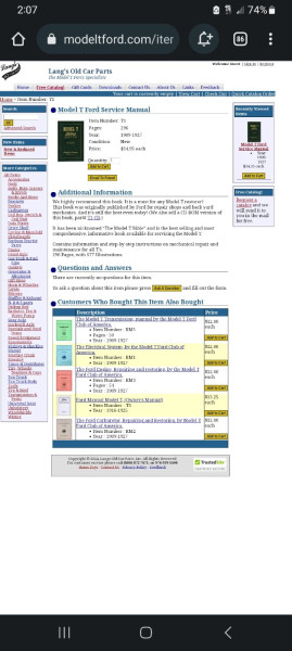

I would suggest buying the Model T Encyclopedia by Bruce McCalley and the Model T Judging Standards by the MTFCI.

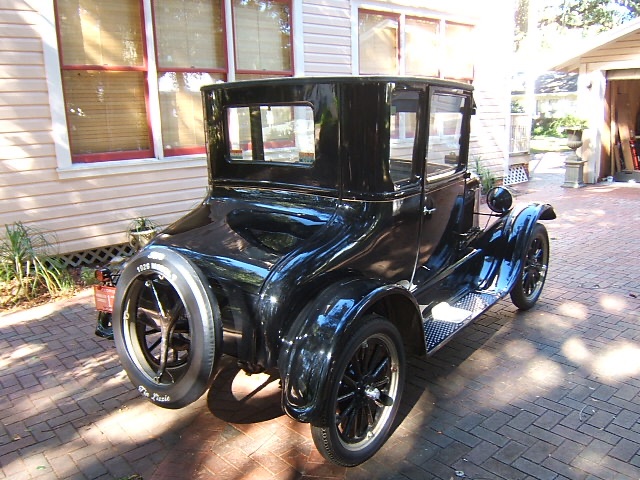

Many of us, including me, are also interested in old crank wind, outside horn Victor and Edison phonographs, Polyphon disc Music boxes, and antique clocks. Maybe it is because they are all wound by cranks and keys or remind us of a less complicated era in America.
Model T’s were manufactured for a little less than 19 years from 1908/09 to 1927. Until 1925, they had a body frame made of wood with sheet metal body panels nailed to the wooden frames. These wooden frames had complicated curves and joints and are very rarely found without the wood being dry rotted or damaged from having been left out in the elements for decades. Unless you are good at woodworking, you may want to consider buying a later Model T manufactured in 1926 and 1927. These are the only ones that were made of “improved” all steel bodies yet they still have the look and charm of the earlier Model T’s. I am including a picture of my 1926 coupe. Also, since so many were made (15,000,000) and so many still survive (probably hundreds of thousands), they are not very good investments for prices are still very low and the selling prices rarely compensate the owner/restorer for the years of work and cost of parts he has put into restoring his Model T. Restoration costs can easily exceed $20,000.00 so it is best if you can buy one that is already restored. Jim Patrick

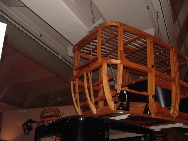

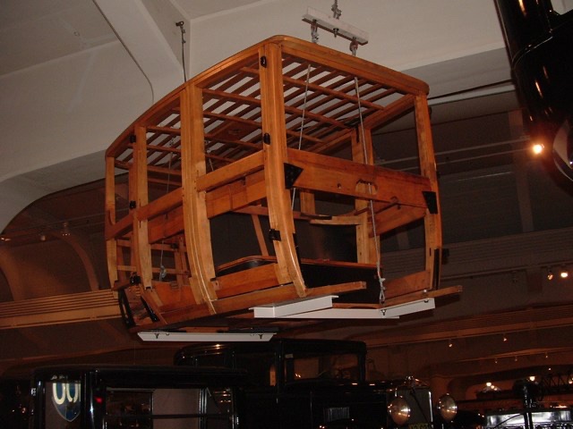

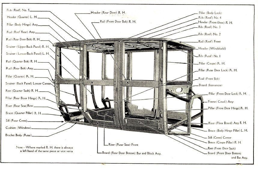

PS. For reasons unknown to me, the 1926-‘27 Fordor had a wooden frame underneath the steel body panels and is extremely difficult to restore if the underlying wood is rotted.
