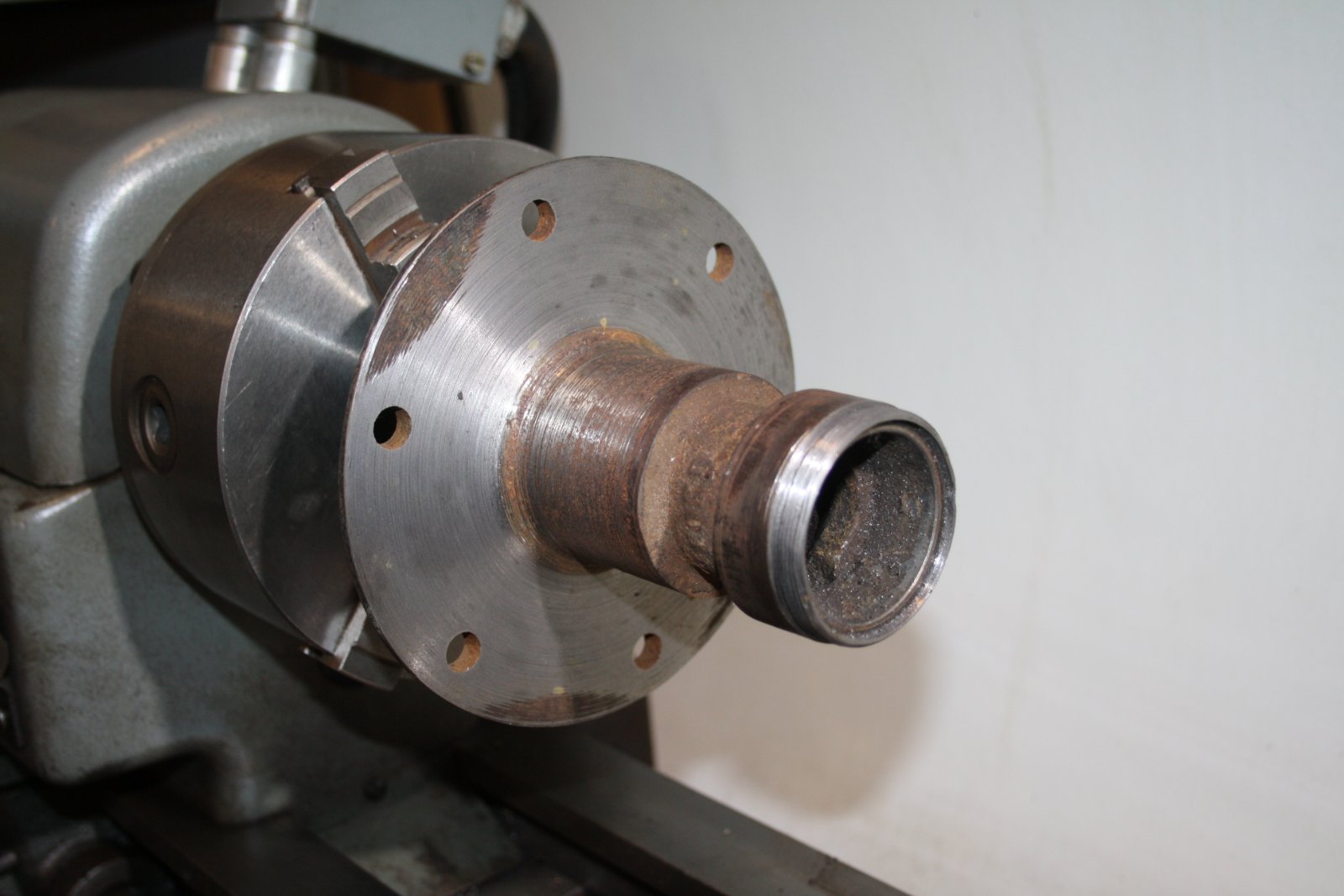

I just recently disassembled 120 wheels to assess and process them for reuse. I discovered that most of the plates and hub flanges are warped. That is caused not by tightening the hub bolts but, that the lateral movement over time causes them to be bent, or flared, outward by the spokes. I also discovered the hub flange flaring when I trued them on my lathe. The cutting tool makes contact with the flange near the hub and at the center point of the bolt holes, it goes clear of the flange. I found the need to remove up to .050 to get a flat flange. I then used my press and a sanding block to get the plates flat. I believe those steps are all necessary to get a good wheel rebuild.

To add to Allan's post and to clarify mine, I believe the hub and flange get warped not by tightening the bolts but by the spokes levering left and right for many years. Given the hardness of the hickory and steel plate, the bolts would strip pulling in that far so I say the warp is not from the bolts.
First, I remove the inner race and leave the outer race in. Then I chuck the hub snout and barely clean the large bearing face (lip) to get a good face surface for chucking. I have found that I cannot always rely on that face for absolute accuracy so, I fit the tailstock with a drill chuck and then with one hand holding the two (the wedge into the race), I tighten the jaws outward. Check for true until it is accurate. Back the tailstock away. With a fine point, kiss the inside lip to remove any small irregularities that may restrict the small race removal. This will help to avoid splitting the thin threaded area. While the hub is spinning, I use a wire wheel in a hand drill going in reverse to the hub spin to clean the hubcap threads. With the lathe stopped, I carefully follow with the Stevens T-181 thread chaser.
I cover the lathe bed and clean the flange by cutting from center out. Take only an indicator cut first, this will show how much you will remove. I have removed from .010 to .050 or more.
To straighten the plates, I use my 30 ton press between the bolt holes and use the sanding block only to indicate my work.
