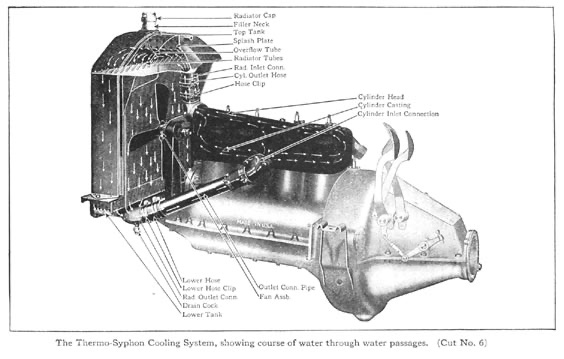

The answer to his question is yes. Remove the water pump and install the original metal pipe from the bottom of the radiator to the water inlet and install the old fan belt to see what it does. If your radiator is good, it will cool the engine through the thermo-siphon system without a water pump. The thermo-siphon system works in the following way: As the hot water leaves the engine block through the water outlet at the head, it enters the radiator and flows down through the radiator. The forward movement of the car and the pulling force of the fan forces the wind through the fins of the radiator, cooling the water. The cool water leaves the radiator through the bottom and flows up into the block through the water inlet where it cools the block. The water moves through the system in a continuous motion as the water is heated and cooled, forcing the water ahead of it to flow through the system through convection.
If you need a water pump to circulate the water and cool the engine, then it is time to get your radiator flushed and serviced, or spring for a new radiator. I believe there is a waiting time for new radiators so, if your radiator is bad you might have a long wait before it arrives. In that case, if you must use the water pump, do so, but when the new radiator arrives, ditch the water pump. Jim Patrick
