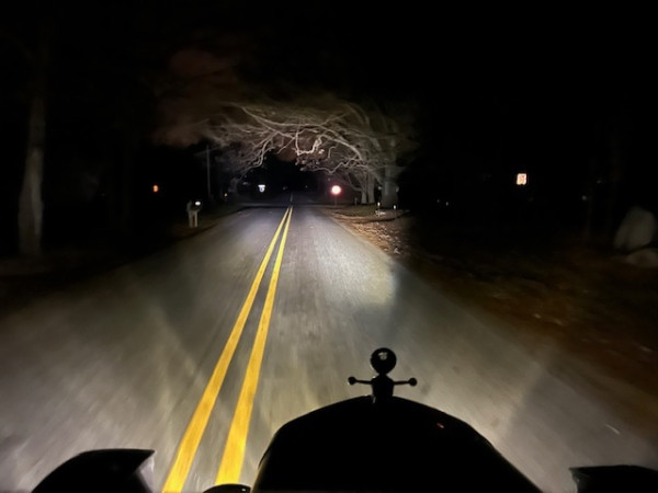

Just sharing a night drive photo using LED’s.
My ‘23 Touring is 6v. The LED’s will run on 6-24v. No difference in brightness with higher voltage but mentioned it since they do have an input range. These make driving at night actually fun and you can see the road. Don’t forget to refresh your reflectors if they are dull or tarnished.
The best part is they draw less than 2 amps. So I run my generator at 4 amps and have a voltage regulator so little stress on generator and battery.
Good luck!
David
Good luck!
David

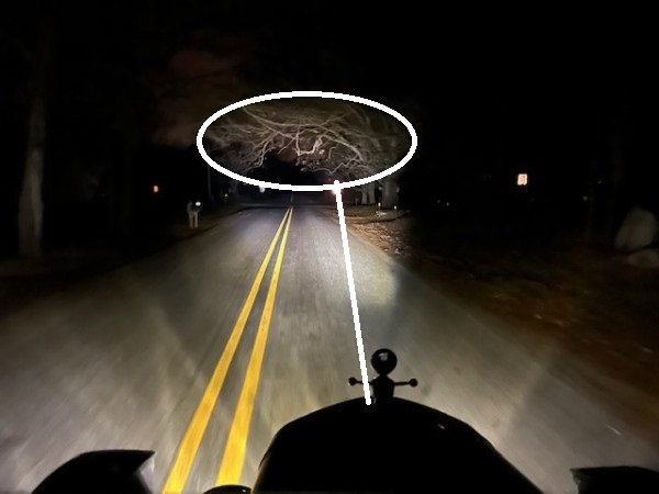

I would hate to be driving into David's lights. As far as focus goes, the led's cannot be focused as that relies on shifting the globe holder so that the reflector can focus the light output. They can be aimed, but that does not concentrate the beam. The led's throw light forward, so the reflector has no function. Some led "globes" have rings of led's to throw light sideways onto the reflector. There are banks of them, so the light is scattered about when projected forward.
What the led' bulbs do is emit loads of ill directed bright blue/white light with little current draw. The latter is a positive in a T. The former leads me to ask, are there design rules on auto lighting in the USA? If so, have any of the replacement led bulbs been assessed to see if they meet these design rules? In Australia many of the conversions for use with standard parabolic reflectors, [like T's], are for off road use only.

Luke, I agree with Allan on his statement about the picture of David Wood's LED headlights not being aimed properly as I stated above. I have commented on several LED bulb designs in the past, some good & some bad. These were the best I have seen, with the exception of a lack of cutoff.Luke wrote: ↑Tue Jan 30, 2024 2:57 pmAllan,

Normally focused low beam headlights cutoff height so that don't reflect into the driver's compartment in front of them. Now we don't know if the picture was with Low Beam or High beam. Just that the picture would bother drivers in front. So any bright light above the white line is a distraction. Illumination the tree branches is a bit too much above the cutoff --
Now Model T headlights are not the easiest to aim. One screw to get the bulb into the focal point of the reflector for maximum brightness. The fluted lens is what actually bends the light pattern. --
Matching new technology to old has always been a challenge. The first electric headlights had a flat glass lens just like the early brass headlights. It wasn't long before the brightness of th new electric light (like today) caused some laws to eliminate the glare to on coming drivers. This cause numerous aftermarket headlight lens patterns

Allan may have initially mentioned David's lamps, but he went on - as I read it - to condemn all LED lamps. I enquired as to whether that's what he actually meant, and commented appropriately.
My view is that in order to be critical of David's beam pattern I suggest that:
(1) the headlamps should be shone upon a suitable board or beam setter
(2) there should be a reference pattern determined with early incandescent bulbs
(3) following this the reference pattern should be compared with LED lamps installed
(4) the results shown here
Obviously correct focusing for such a test would be necessary, and a comparison of output might also be useful; headlamps need to actually work for the driver too, feeble yellow light with a 'perfect' pattern vs usable bright light with a slightly less than perfect pattern...?

Perhaps I may have been a little too harsh in my opinion of Led conversions. If there are available led bulbs which do meet vehicle lighting standards, I would be interested to hear of them. I would like to know how they are engineered to work with a parabolic reflector.
For off road use, aim and focus are not necessarily of great concern. Modern cars with Led lighting are specially designed units to address these concerns. As a previous poster said, marrying modern technology to old time technology is difficult.

Allan, I'm not sure you understand how these LED bulbs actually function in a T headlamp. What if I told you it really makes no difference if the reflector is silvered vs. if it is painted Black? The Intensity or lumen output is basically the same. Also, the idea of focusing the incandescent bulbs was because you had one wire inside of the bulb and you were using the reflector to project that. When you study the shape of the LED bulbs we are using, the chips are aimed forward and outward but are generally shielded from around the axis area where the bulb base is located. No need to focus an LED retrofitted bulb.Allan wrote: ↑Tue Jan 30, 2024 6:11 pmPerhaps I may have been a little too harsh in my opinion of Led conversions. If there are available led bulbs which do meet vehicle lighting standards, I would be interested to hear of them. I would like to know how they are engineered to work with a parabolic reflector.

So let me fill in a few gaps here.
I purchased these LED’s from “Classic Dynamo & Regulator Conversions” in 2015.
Link: https://www.dynamoregulatorconversions. ... -bulbs.php
This was before any of the vendors were carrying them and they are custom made by these guys, so none of the vendors in the states will have the same model.
These are called “ 6-24v Double Dipper Bulb” BA15d for negative ground.
I did install the reflectors from the T vendors, the brightest they carried and have stock lenses.
I have not tried to focus them yet but I need to. The original thought was to run these during the day for visibility around traffic since I had cars pulling out in front of me all the time and they do help during the day.
I did try the original 32 candle power bulbs or whatever they are but they seem to be more of a marker for other cars than being able to see the road so the first time I took the car out at night I was hooked.
In the photo I’m actually on dim because one bulb has a failed LED used on the bright circuit but oddly enough there is not a huge difference in brightness between dim and bright. I think bright is a bit wider pattern since both sides of the bulb are on.
I have the car out many times at night and never had oncoming traffic flash high beems ( I do get a lot of oncoming drivers flashing me in my Equinox on dim). So these are not as bright as a modern car but as you can see from photo I have not done anything to adjust the pattern.
The photo was taken with my iPhone so that may have made it a bit brighter but I don’t think much. You can still see the reflection on the street signs further down the road.
I can tell you it’s a blast to drive at night and would not ever go back to the incandescent bulbs. The best part is I run my generator at 4 amps so even with the headlamps and tail light I still have a 2 amp charge.
