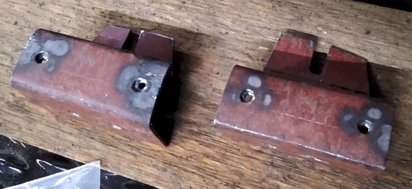

Made two A-pillar brackets that support the door check strap and the kick panel.
Square nuts welded on the back side.

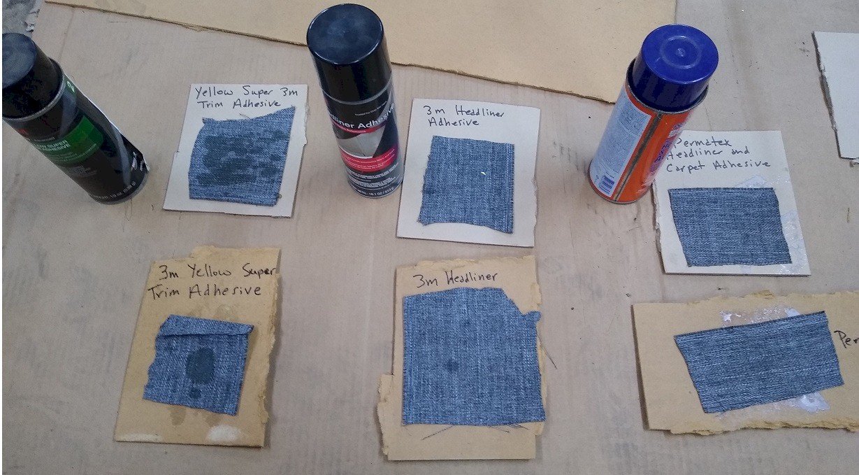

Wife did an adhesive test with three different products on two different types of scrap panel boards.

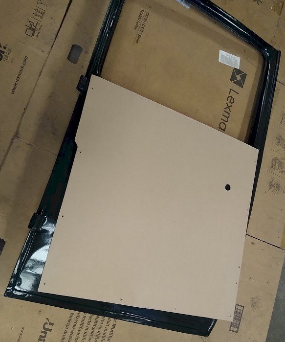

Cut out and trimmed nine panel boards so far. Drilled holes.

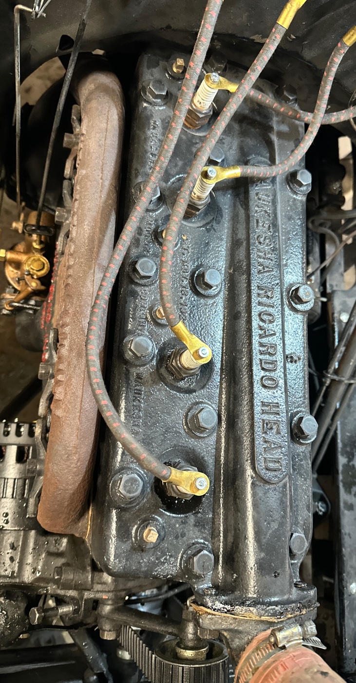

Post by South Park Zephyr » Wed Jan 31, 2024 3:35 pm

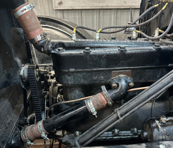

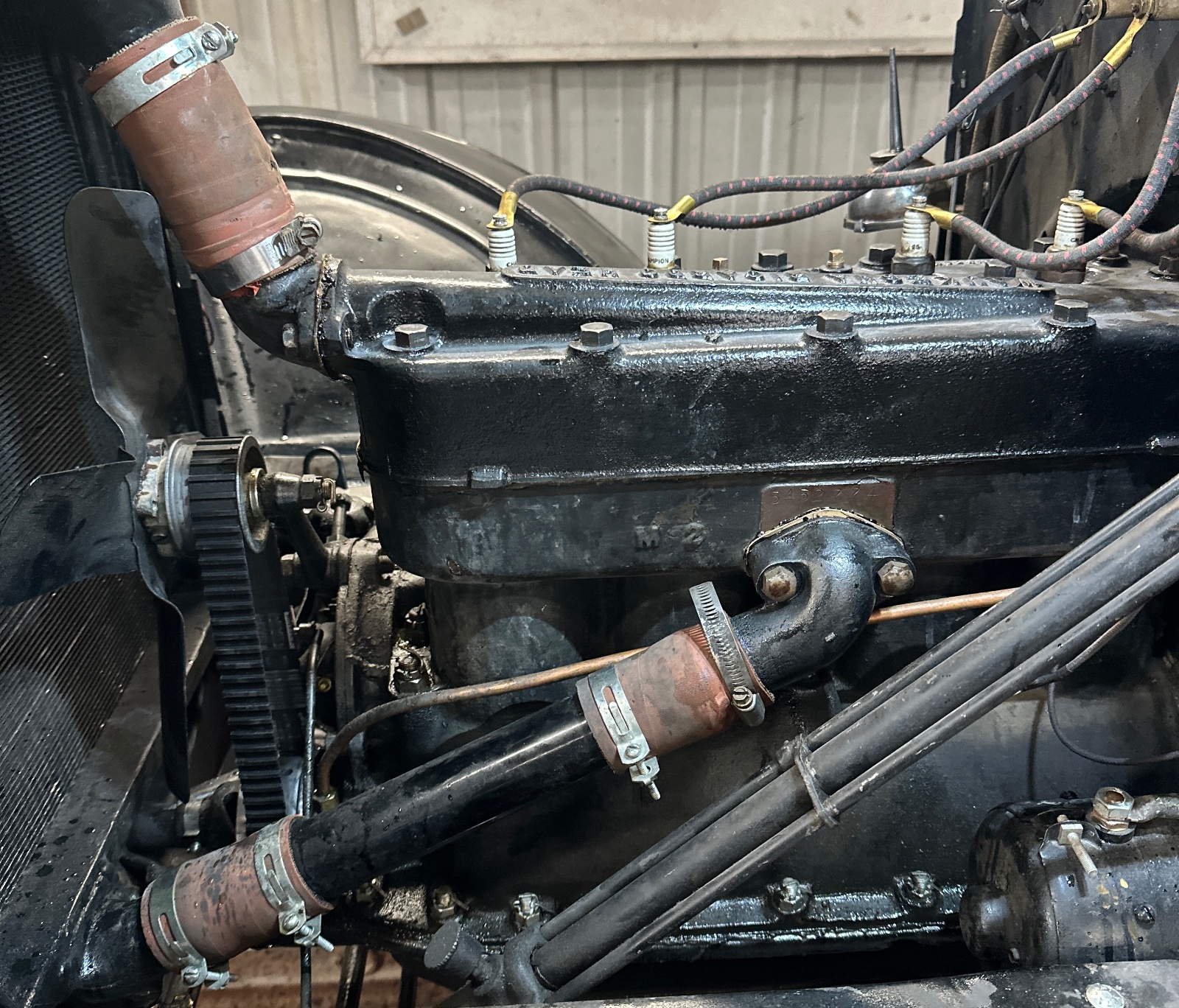

I took the water pump off, added a Waukesha Ricardo head, and replaced both tie rod bolts and bushings in my 23 runabout
In preparation for our “Tour De Frost” (mid winter attitude adjustment) that is happening 2/17 here in St. Louis.

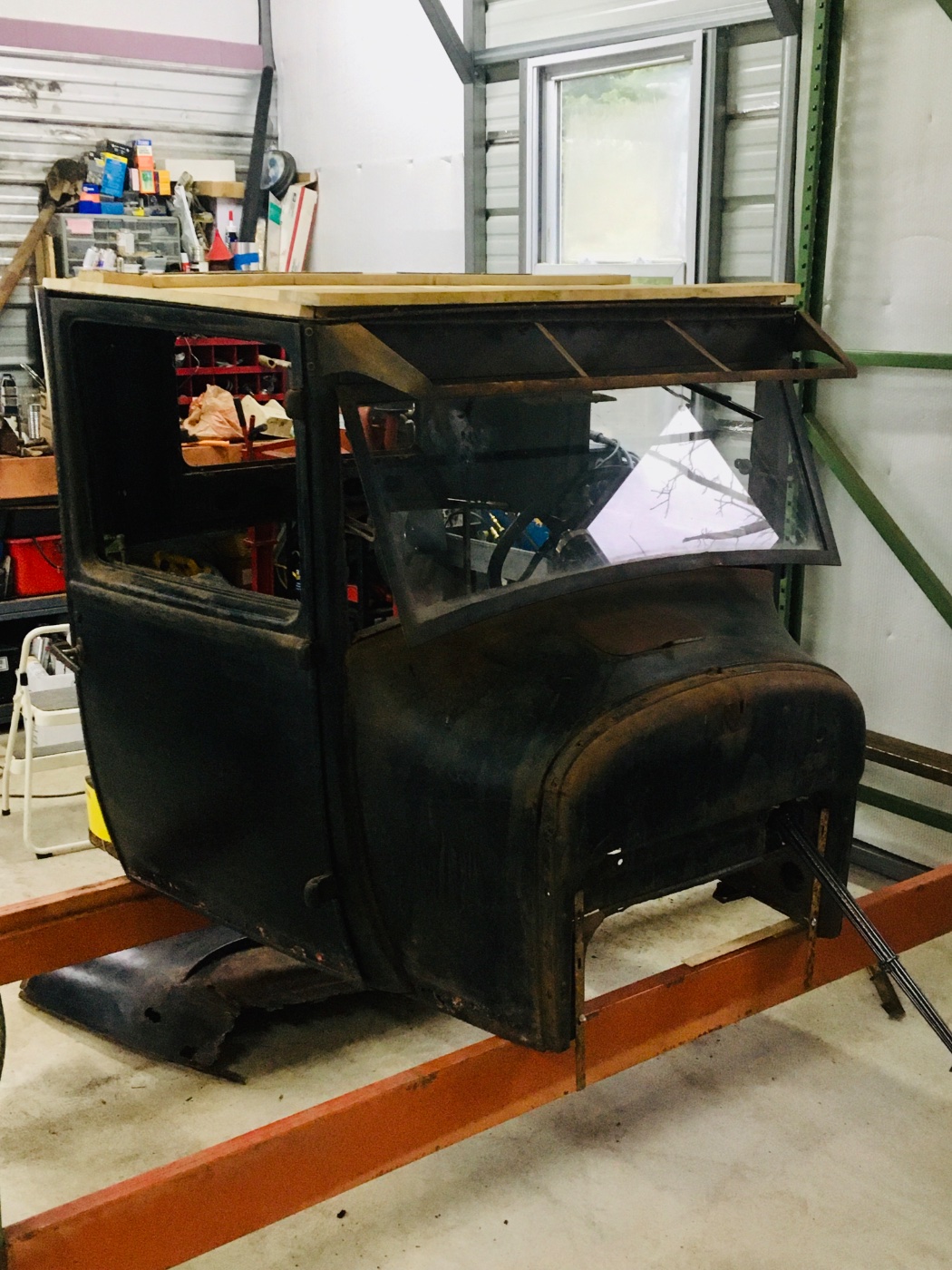

I started the process of converting my Tudor into a pickup. The amount of decay in the inner workings of the back half of the car are just to much. Plus I kinda loved the idea anyways. Please don’t kill me.

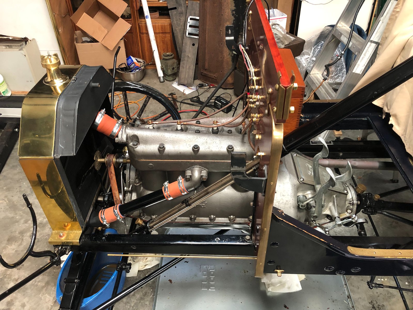

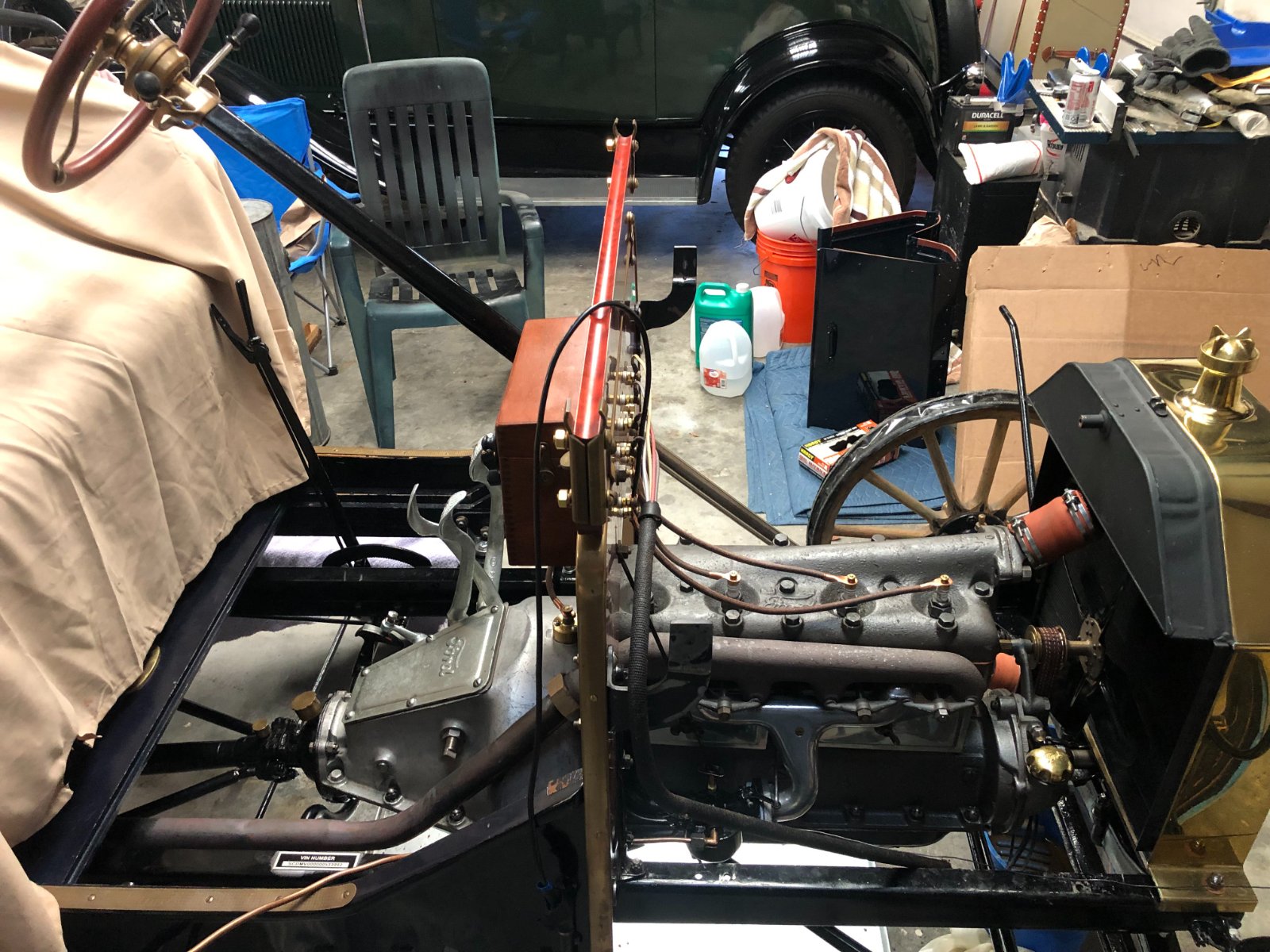

Went completely through my 1912 engine and did considerable amount of meticulous adjusting and tweaking. Recharged magnets, set magnet to coil ring gap properly, a hundred other things. Runs great on magneto! And Heinz coils that were rebuilt by RV Anderson some years back. Test runs using an NH carb but will use the Holley H1 or possibly the Kingston 6 Ball (I have two of them). I am declaring the powerplant complete and can now move on to putting the car together.
