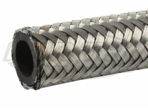

What is the best and strongest way to secure a fitting to both ends of a length of stainless steel braided hose that will be used for water and/or oil. Can you recommend the necessary parts (ferrules or clamps) and tools to accomplish this? Please be as economical as possible. Thank you. Jim Patrick

Jim, This method is the way I have made hoses for many many, years. Good Luck.
https://www.youtube.com/watch?v=PeeflgGlenY
You will have to find the fittings to fit your needs. Generally, you have a "collar" that goes on the hose end, then the fitting that threads into the collar with a tapered end inside the hose. I have seen radiator hose collars that just hide the hose end with a hose clamp inside the collar to tighten on the hose as you would normally have.
