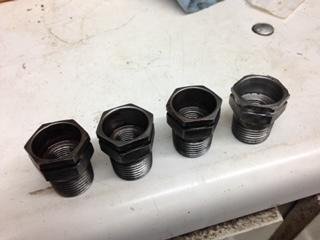

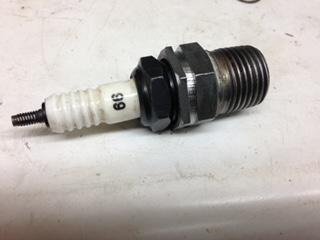

The problem is easily solved by using adapters for modern plugs. Screw the adapter in once only, with the sealant of your choice, and then use modern plugs. You may not like the look though.

Plug adapters are an option. I still put anti seize on the adapters.
Try some & see if the plug doesn't go in to far before tight. If you are not familiar with it, its basically aluminum powder & oil made into a paste.

If you don't like the looks of the modern plugs & adapters they can be made from the later crimp style 1/2" npt plugs so they look like 1/2" plugs Craig.
