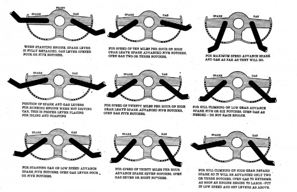

Rules for setting timing as you drive?
I just read the topic about high compression heads, and Hank in Tin-a-see mentions these rules. Could someone please educate me on this? Cheers, Bill
- Posts: 7402
Re: Rules for setting timing as you drive?
I believe this widely circulated chart, with one addition here, is from Murray Fahnestock. One experienced T guy I know scoffs at it. He says you should set timing to where it sounds best and forget the chart. I guess my question about that would be what's the definition of "sounds best"?

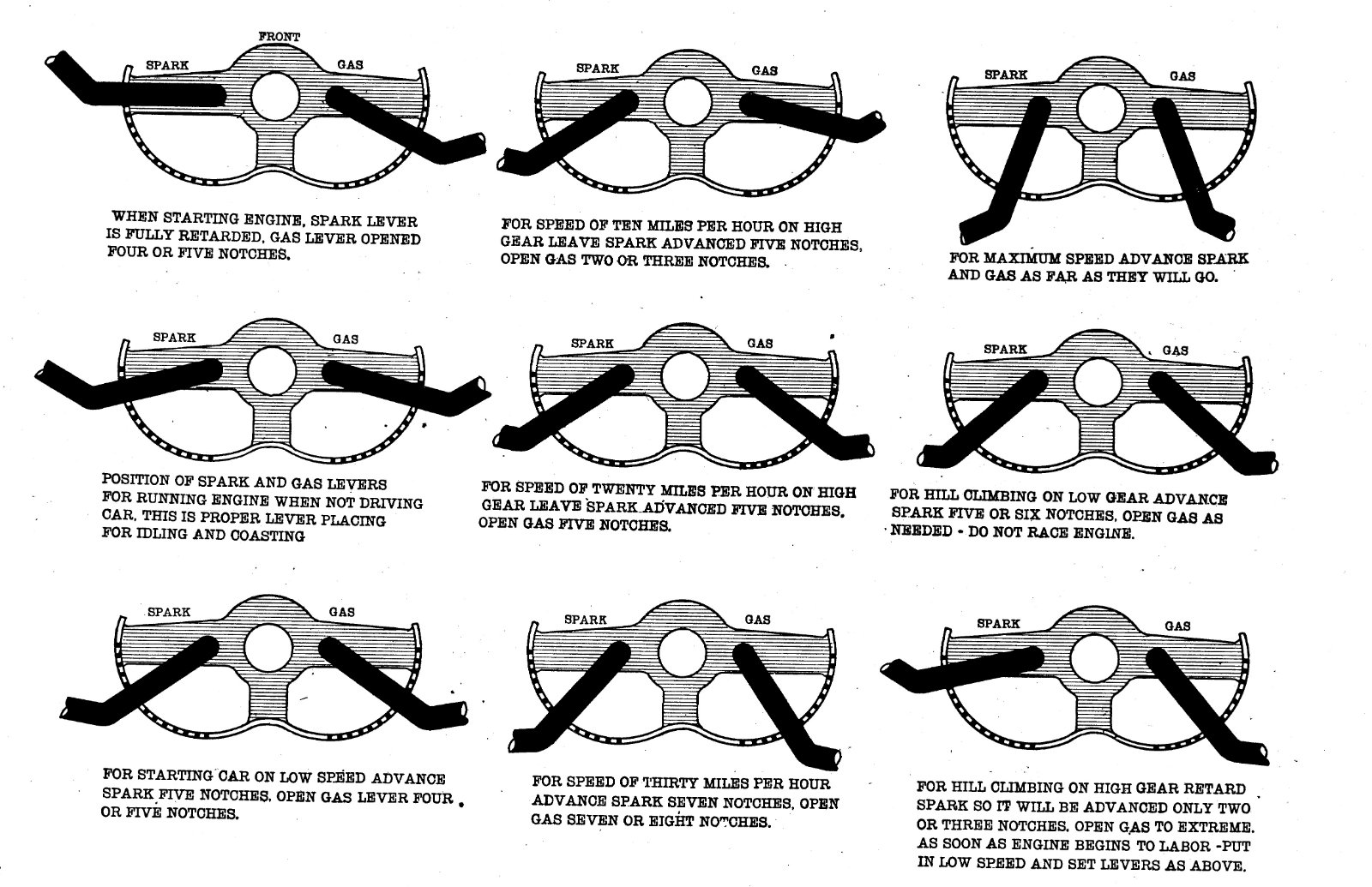

I would like to read that chart, but it comes up fuzzy on my computer. Can you give a link to it?Steve Jelf wrote: ↑Tue May 28, 2019 8:45 am
I believe this widely circulated chart, with one addition here, is from Murray Fahnestock. [/size]

I have seen this chart many times and after looking at it and driving my T’s over the years I have come to the conclusion that all T’s aren’t exactly the same as far as these levers settings are concerned. Close but not quite.
I think that some folks think the settings have to be exactly this way. Not necessarily so.
They give you a general idea and after time you develope your own lever settings for your paticular car.

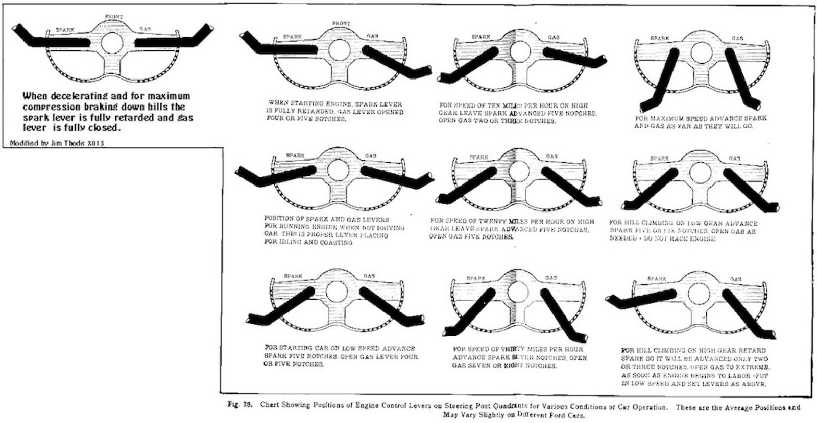

I remembered correctly about the chart being from Murray Fahnestock. The copy I posted is unreadable because it was resized for the old forum, so I made a better one. This one is not great, but it's readable, at least on my screen.
As there are just three spark positions on MAG, the chart has to be for driving on BAT. The only time I drive on battery is when I have a senior moment and forget to switch over, so the diagram is irrelevant to most of my driving. Add the variation among different carburetors, and it becomes even more so.

The chart that Steve Jelf posted above comes from the various editions of the Victor Page book The Model T Ford Car, Its Construction, Operation and Repai.
Copies are available for free download on Google Books - here is one example:
https://books.google.com/books?id=70mJe ... rd&f=false

I agree George...
If the RPM gets low enough, maybe slightly retard the timing, but not like the picture shows. Just enough to keep from spark knock.
