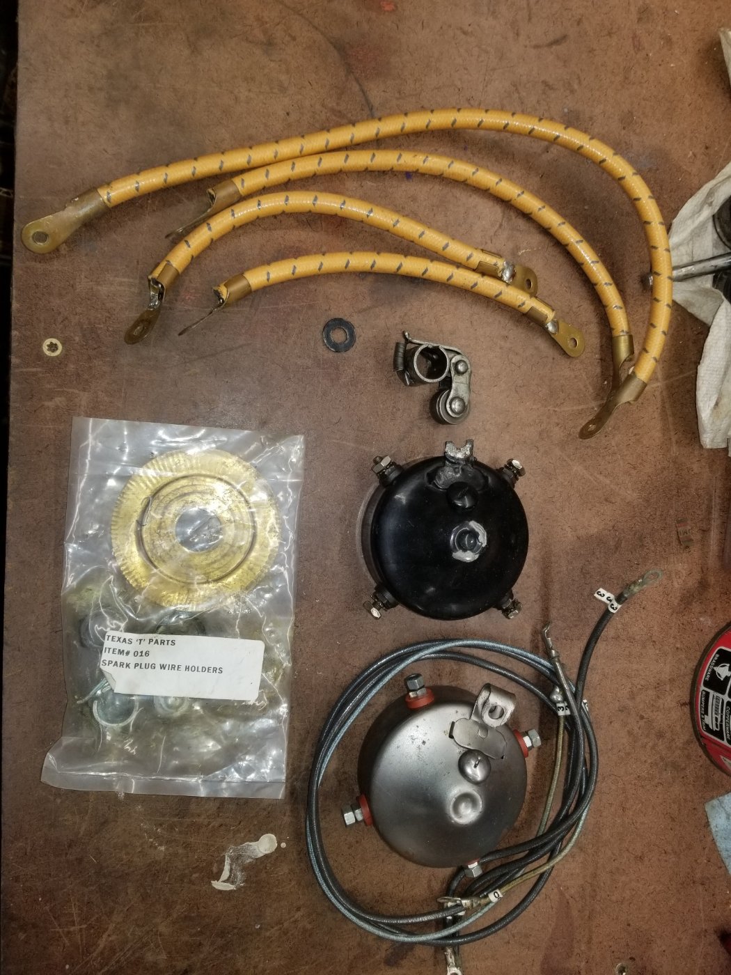

The '25 currently has a distributor and coil partially hooked up. Amongst the parts we're about 20 spark plugs, spark plug wire sets, a few timers, a half dozen coil boxes and a bunch of coil box repair parts,.. Some new in package and some used.
PO told me he had trouble getting it running, so he started to switch over to the dizzy. (PO owned the car for 40 years, fully restored it and drove it to Hershey and local shows so I know it was working at one point)
Are there advantages to the dizzy set up?
Should I switch back over to timer and coil boxes?

Post by TWrenn » Thu Dec 28, 2023 3:27 pm
At this point, if it's running decent, as they say, if it aint broke, don't fix it!
The one timer in your picture IS broke...the top part where the spark adjust rod attaches is broke. Who knows what shape the roller is in, and most who know me will tell you I don't like them, I'm what I admit is a "TW Timer snob"!! And proud of it. Cause they run flawlessly.

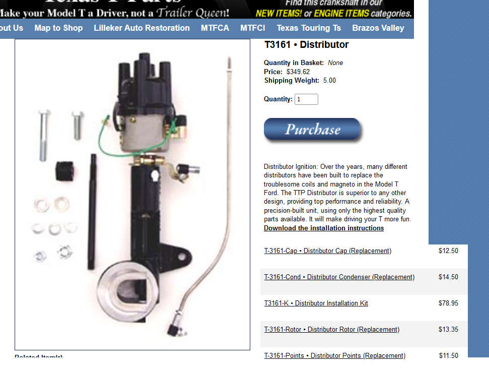

You may have a distributor because of magneto issues or that it was removed.

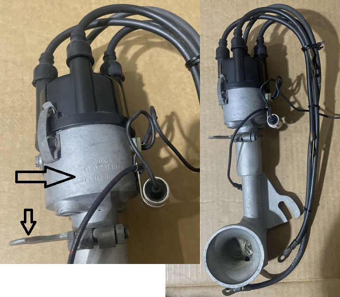

You need to properly identify the distributor. The "original" American Bosch, included centrifugal advance, and require the period replacement parts. Original 009 VW Robert Bosch distributors became a popular modification but required advance curve changes. AND some of these were available for purchase. Texas T now sells a 009 knock off modified for the Model T.
You can see the differences in these two - the first appears to be marked as a VW, as Craig noted. Also has the same lever for the commutator rod as yours
The current Texas T's version.
nstallation instructions should be close enough for either
Texas T instr.pdf
(1022.68 KiB) Downloaded 99 times

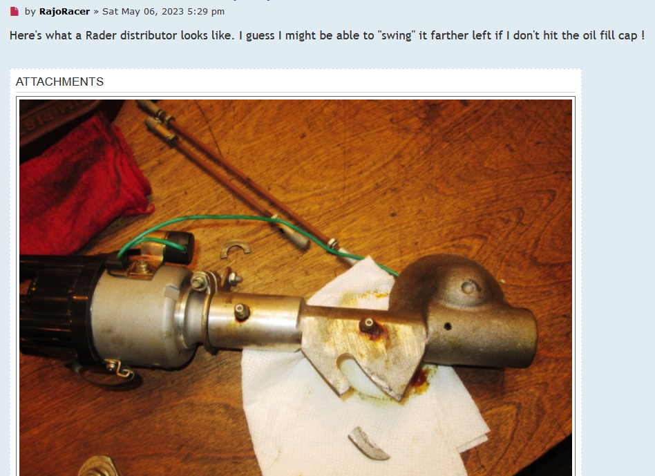

It appears that distributor set-up could be a Bill Rader item due to the bell crank for the spark lead arms.

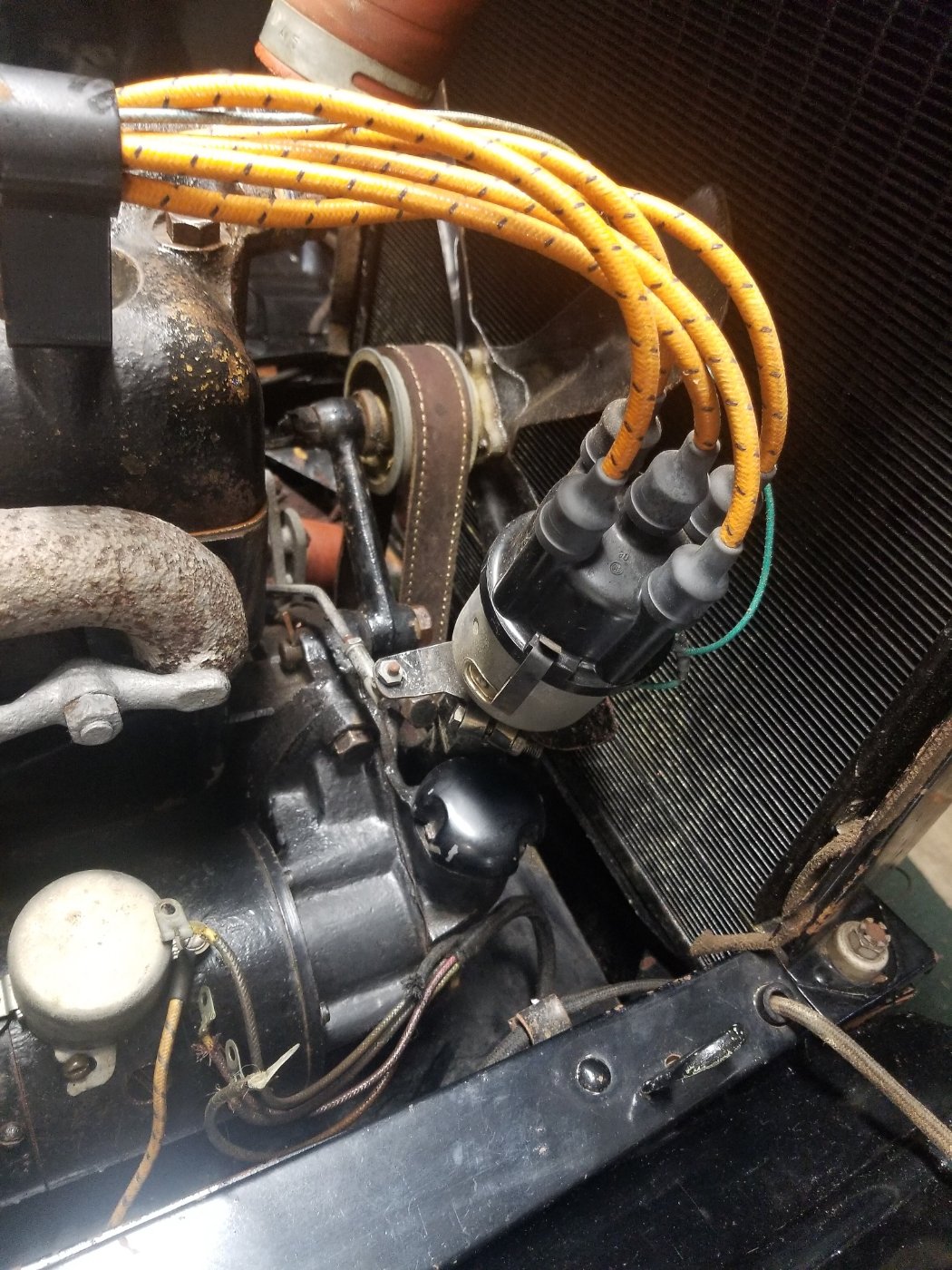

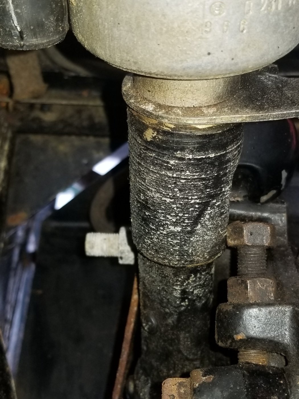

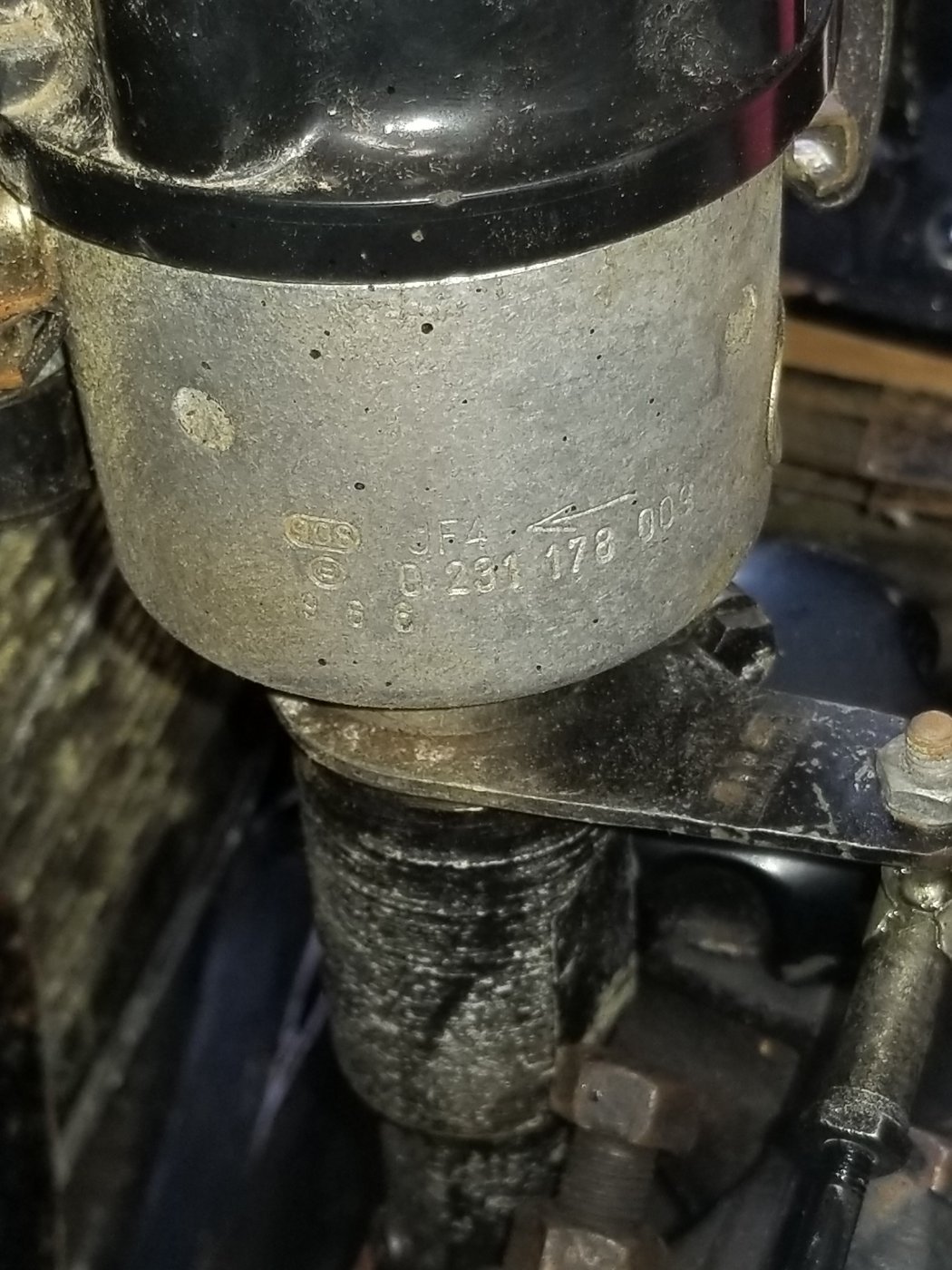

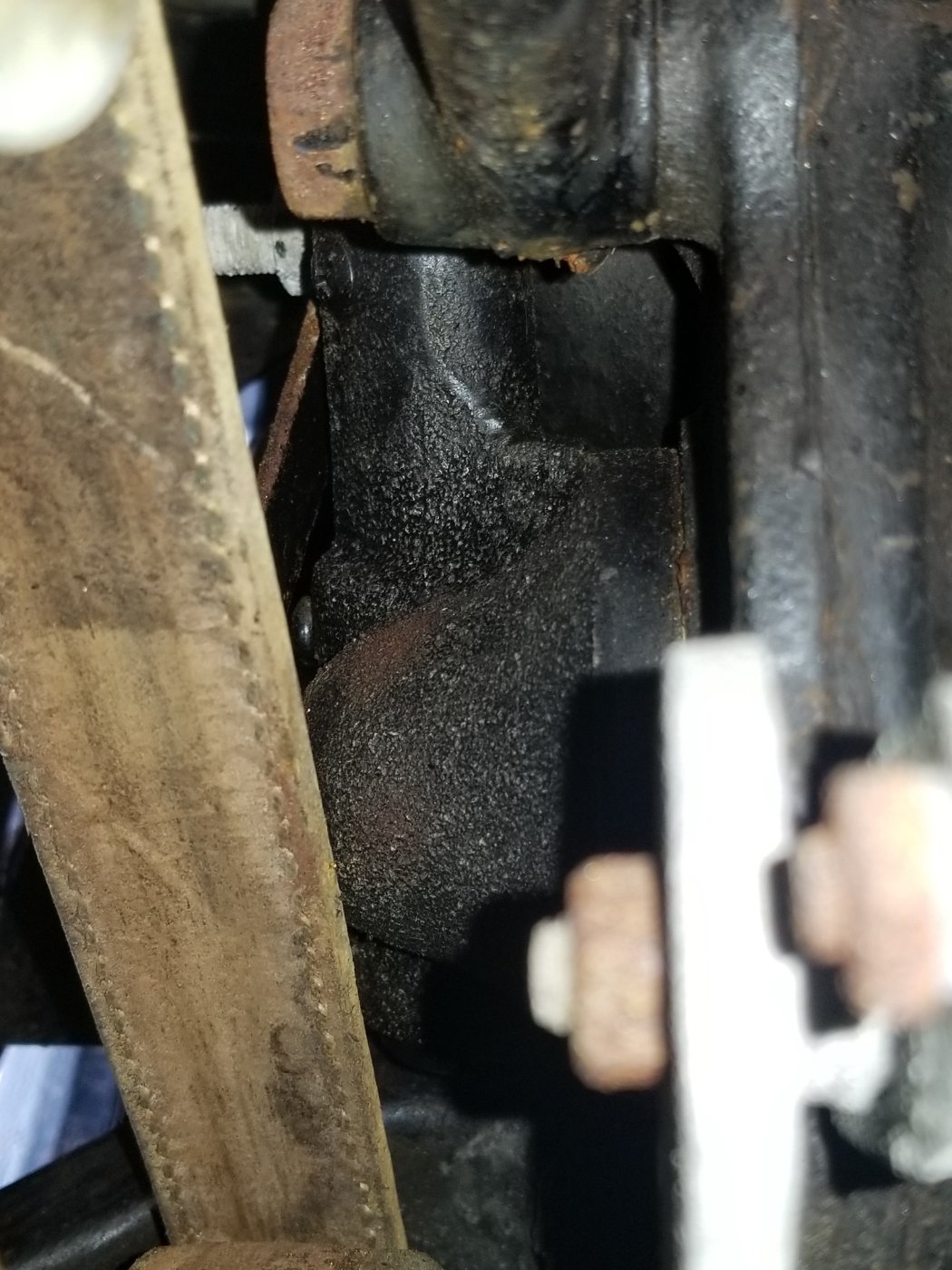

Here's more pics of what I have. Seems just the plugs are not attached. The inside of the dizzy is spotless.. Wires look new.

Distributor is a Hella, which is VW(?)

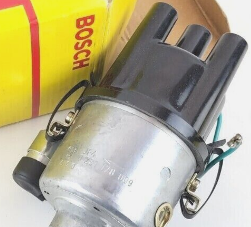

The distributor is a Bosch 009 , used on VW's BUT likely an original vs repro or new oem
These had centrifugal advance and if it is
bosch logo.png (159.85 KiB) Viewed 5426 times
Distributors were period correct items as were external magnetos, mostly used for racing,.

Trademark misled me. I thought the "H" mark was Hella.

Vincent
go to www.texastparts.com and click on ignition system, then click on distributor, and you will find the instructions (6 pages)
