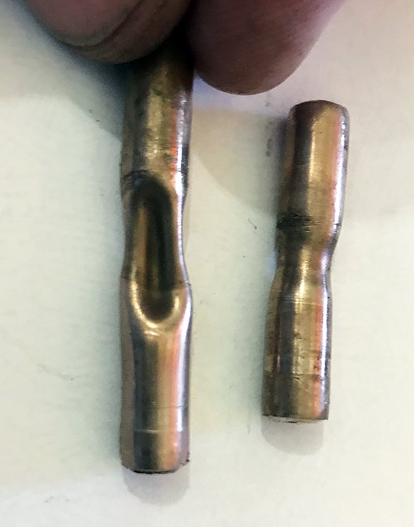

To hijack the conversation slightly, I use steel brake line for fuel lines after a bad experience with Nickel-Copper lines. This is what happened to the ends that were sealed with neoprene packing and original brass nuts. I discovered the problem when I noticed a very slight fuel leak. The deformation occurred at both the valve and the sediment bulb. Pure copper may be better. I've had a copper fuel line connecting an auxiliary tank to a main tank in my 1946 Airplane that has held up for 40 years. It has been exposed to vibration the like of which we never experience in a Model T.
