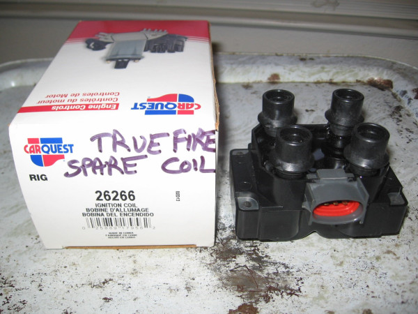

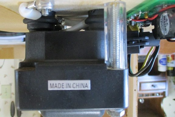

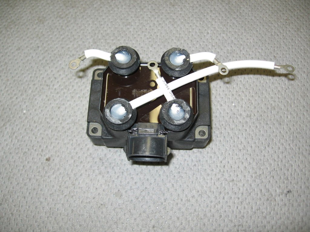

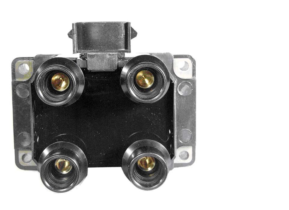

The coil inside the Truefire unit is a commonly available part, number 26266, for a Ford Ranger pickup if I recall. I bought a spare for myself years ago in case I ever need it (so far I haven't).
Mr. Bittner chose to use a unique setup for wiring the secondary output wires to put them in the correct positions to attach to the stock Ford ceramic terminals, here is a pic of one of his units:

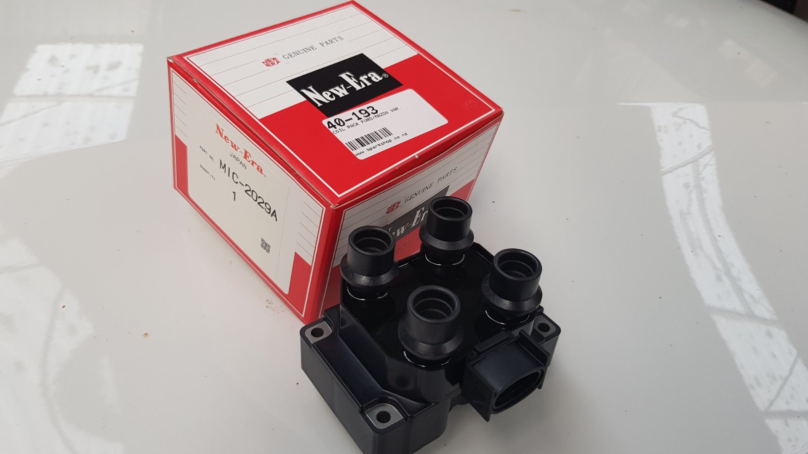

I heard and hence thought of course the coils were from the Ford Taurus but very well may have been in the Ranger also. Doesn't matter. It works great when it works. I've had 3 cars with them over the years and all were great runners. I'm back to cars with all stock...for now anyway.

That part is available and common here.
The only problem is to make sure the wires are firmly attached and properly covered to prevent an arc over.

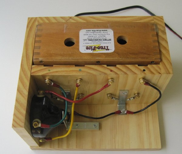

I have a TrueFire test set, but I have never been able to find the switching transistors in the Timer Cover.
The box is more reliable than the Timer cover.
The Test Set is simple to make.
A big wing nut, not shown, on the left rotates the Timer Rotor.
The metal uprights represent the block.
