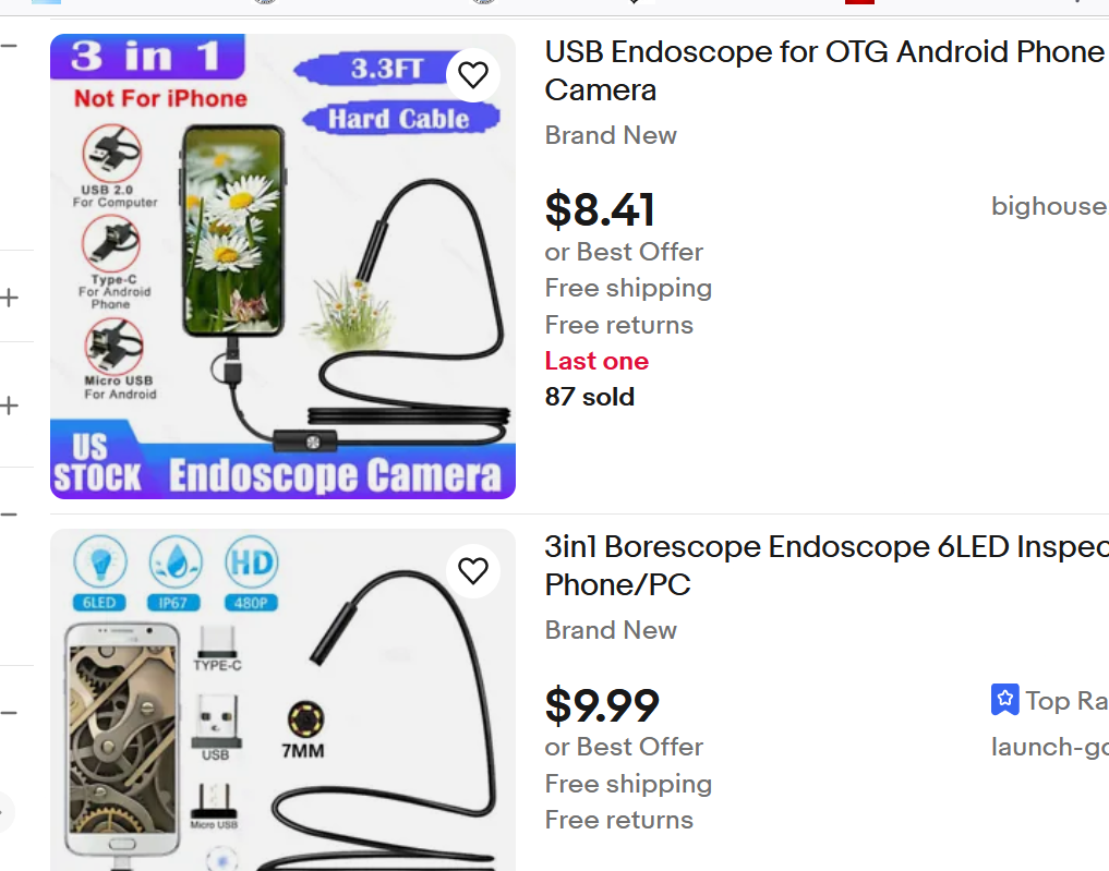

Suggest you get one of these. Some Endoscopes are for iPhone, Android or Windows. light too. also ow the scope is powered. so you need to read the fine print
This link is for US Only eBay sellers sorted low$ to high $ with shipping.
https://www.ebay.com/sch/i.html?_from=R ... _PrefLoc=1
