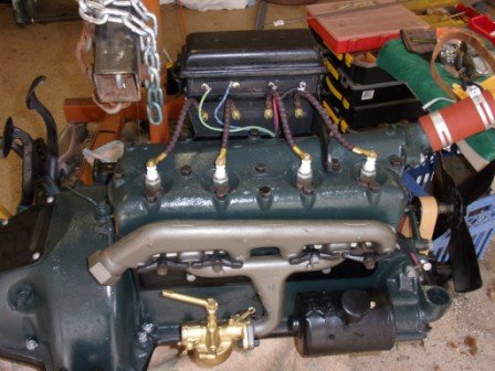

The consensus on another vehicle forum I am active on is that the blocks should not get that hot to affect almost any paint. If it does, you got other problems. So, go for it. Here is my latest engine project painted Model A green.
I have had good luck using black stove polish on manifolds. Wipes on and will stay a nice matte black finish for over a hear. Then wipe on again. Available at ACE hardware here.

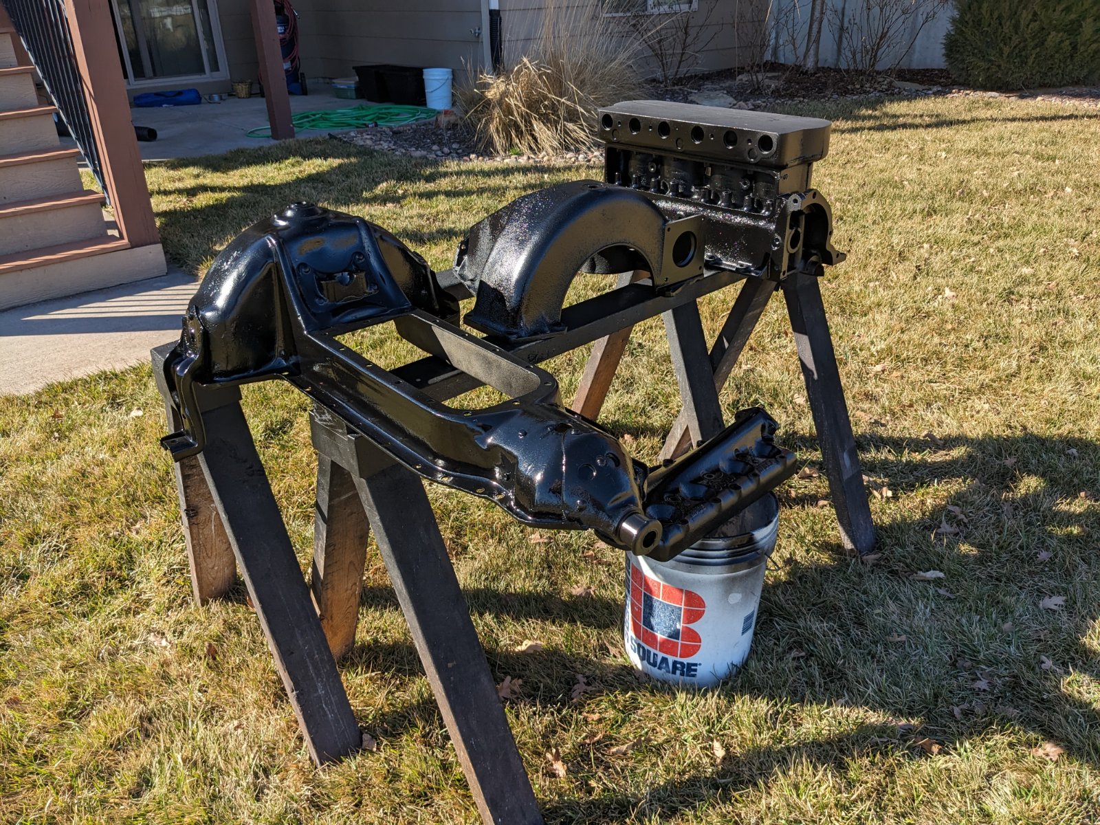

After reading that I'd probably want to add reducer and hardener to the farm paint to get it to spray well and dry in a reasonable amount of time, I decided to just get another quart of Eastwood extreme chassis black for painting the engine parts. It sprays well right out of the can, and the cost isn't much more than buying farm paint plus reducer and hardener. Plus the paint is good to 330 F.
We had another couple of days in the 50s and 60s this week, so I got all the engine parts painted before it got cold again. Even in that temperature range, the paint dried pretty quickly. Time to start putting the engine back together!

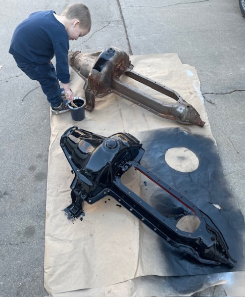

Took the same opportunity but used rustoleum and a hardener mix brushed on but took a lot longer to dry. Had the kid help on a cracked pan
