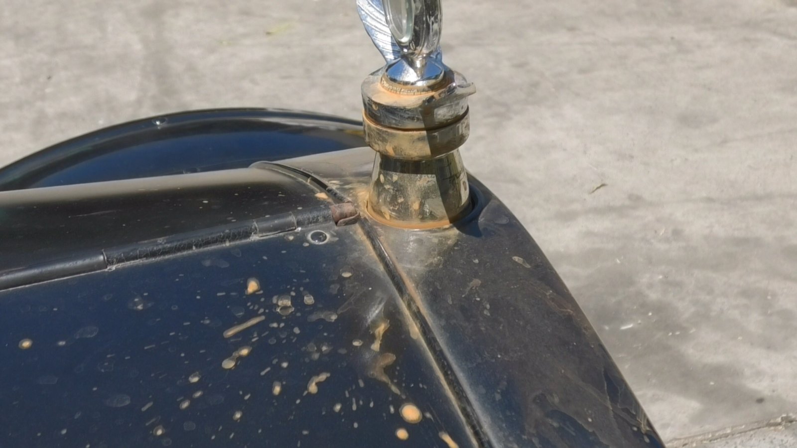

A mysterious water leak started emerging from the radiator cap on my Model T... What could it be? A clogged expansion pipe? A blockage in a radiator hose? A blocked radiator perhaps? Long story short, I (unnecessarily) flushed out the whole cooling system to try and find the problem, which after all turned out to be perished seals on the radiator cap itself!!
Enjoy the video though...
https://www.youtube.com/watch?v=IQAvAYxrXc0
Amazing how the problems are usually a lot simpler than we think!

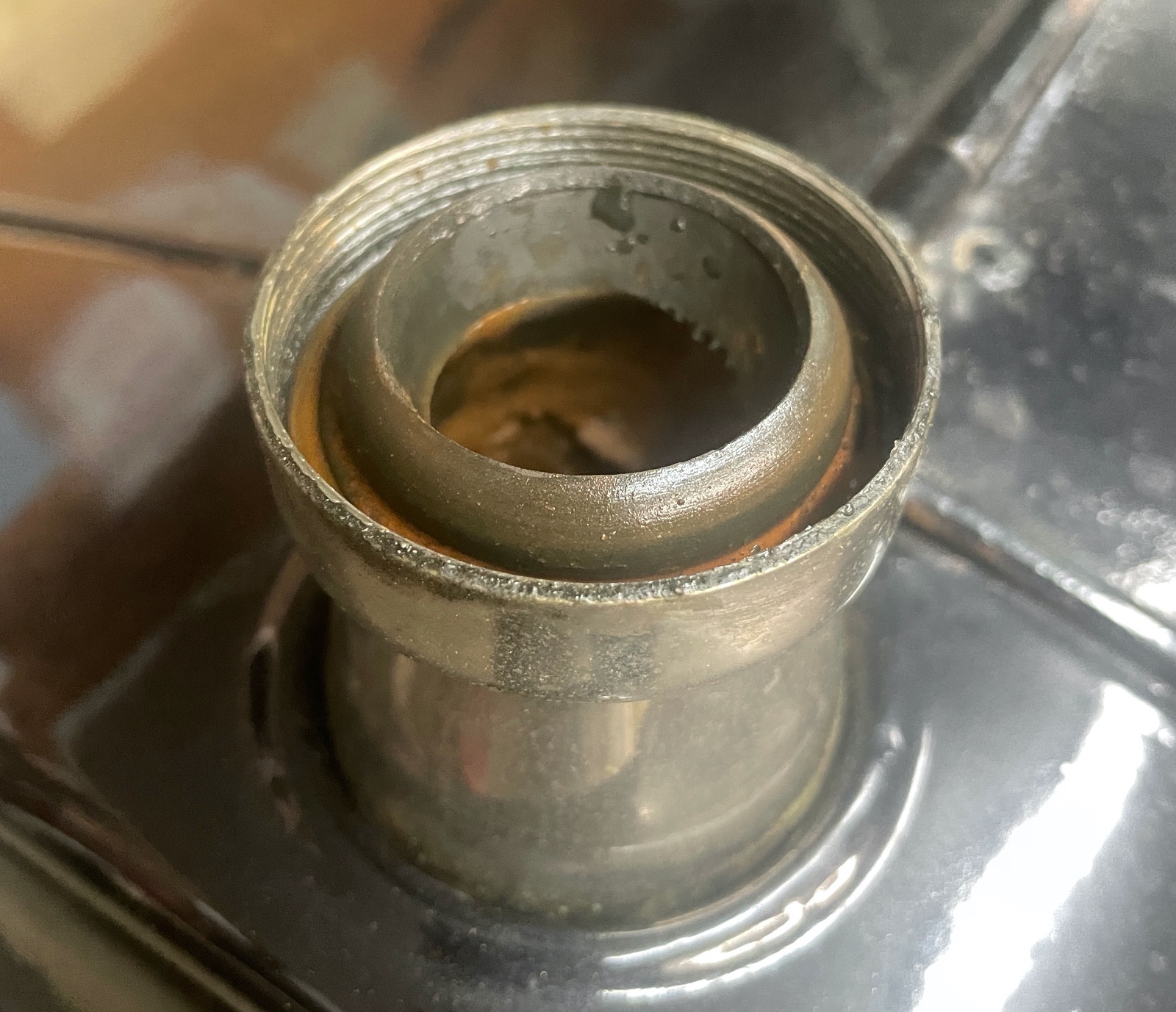

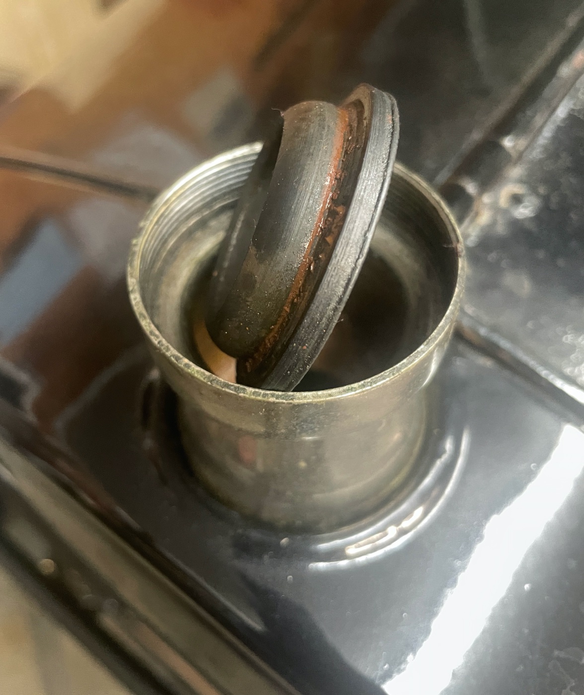

Leaky or even missing radiator cap gaskets do indeed allow seepage to flow over the hood and onto the windshield
Have used over the years lots of gaskets, cut from cork, some from paper some from rubber, but always the flat circular gaskets don't do the job.
Best for me is the modern plumber's drain trap elbow thick rubber parts. Lang's sells them too. Very effective and long lasting.
Fun video as all of yours are, thanks for sharing.
