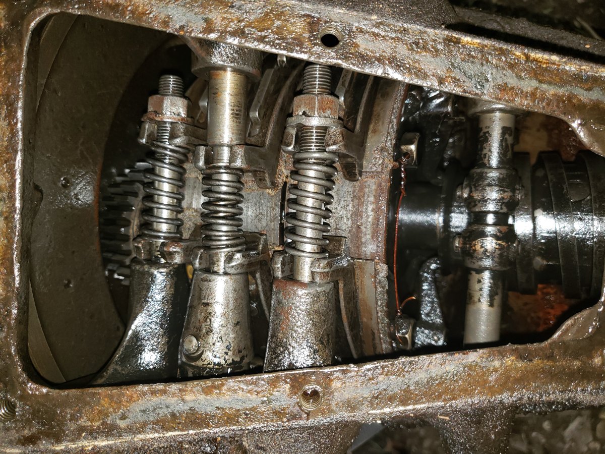

Here is a picture. I have not made any adjustments yet. Thanks in advance for all of the input. I will take it all in.

Im no expert but it looks like new band lunings are needed. Other more experienced folks will chime in. Good on you for asking 1st.

Unfortunately, your linings have seen better days, especially low band AND whomever did the last relining installed the detachable ears on the incorrect side - they should be on the driver's side.

The brake drum looks rather rusty also...

New lining would not hurt! BUT the bands are installed the wrong way. They need to be turned around. Also, might be the light but the safety wire looks to be copper and too thin, is needs to be a larger diameter and stainless or iron type. While the bands are out would be good time to check for cracks. That brake drum looks kinda rusty. One way or the other that rust is going to get polished off and end up in the oil. Might as well clean it up now, that way you can wipe as you clean and keep most of it out of the oil. A non metal scouring/sanding pad should work.
