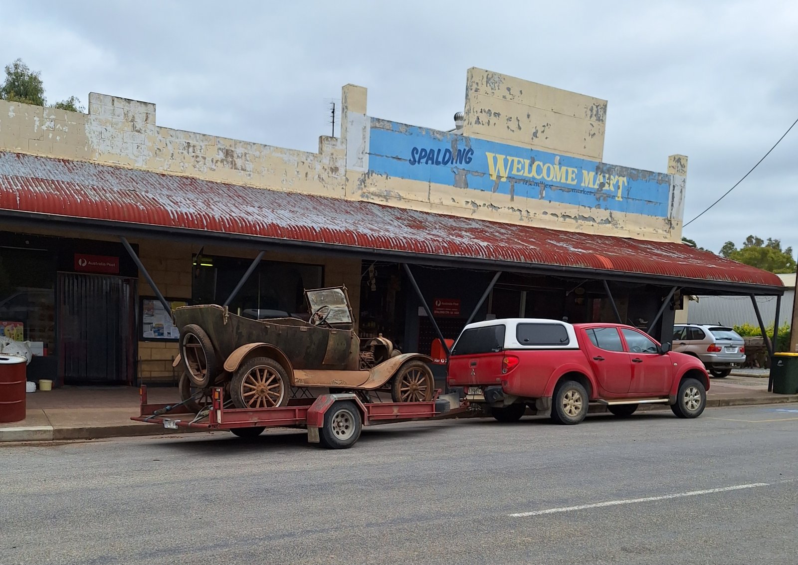

We transport a lot of small military vehicles to local shows as well as significant distances. Tops come off prior to loading and windshields get folded down. If not, the car acts as a parachute, stress on the fabric top and road debris up on the grills, radiators and windshields. Expect some damage as well as paint rubbing from straps.
We installed a small, cheap ATV winch bolted to the trailer deck and use it to winch up and off the vehicle so we are not driving up short 4 ft ramps and then slaming on the brakes.
Not much weight to speak of, but if you load straight up, all your engine weight will be on the tongue, so balance the car front and back as well as you can. Hand brake on, wheels chocked and four rachet straps, one one each corner pulling front, back and some sideways. You will be surprised how much these vehicles will bounce around on a trailer and get sideways.
I would strongly look at renting or borrowing or purchasing an enclosed trailer, but I know the rear door height is an issue for a T. When you consider all the work needed to load and unload on an open trailer it might be worth it. I am always jealous of the guys with the enclosed trailers driving home after an event while I am still removing shovels, gas cans, seat cushions, tops, windshields, etc. And, if the weather is bad, enclosed is great. And, it's always an extra storage option back at home.
When I get my WWI ambulance project completed, I will be looking at one. In fact, I need to start looking at trailer door heights before I build my body so that I do not create one an 1" too tall.

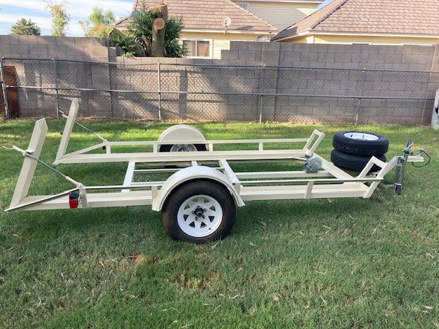

Landscape trailer or utillity trailer? I'm assuming it is a basic angle iron, wood deck, expanded metal tailgate model? If so I unfortunetly
have some experiance with mine to share that may or maynot apply. I have a 16' Big Tex single axle of that type that I picked up for a song &
dance because my 18' tandem diamond plate dovetail is worthless for hauling anything other than cars & tractors. I figured I could haul model
Ts on it if needed & I suppose I could in a pinch. The tailgate is too short for comfortable loading but tall enough that it turns into a parachute
at 65 mph so I get the same lousy milage loaded or empty. As bad if not worse than the much heavyer tandem. I would suggest getting a pair
of long ramps if it does'nt come with them. I would install a low means of tying down as the top rail will let the T float around. Make sure the
wood is good where the wheels set. As mentioned by Robert find a way to meassure the tongue weight with the T on the trailer & mark or block
the trailer so you dont get to little or to much weight on it. ( this goe's for any trailer as it is easy to just tie up to the front rail & that in many
cases will overload the tongue ) Check with your insurance carrier as many will not cover your trailer if in a accident.

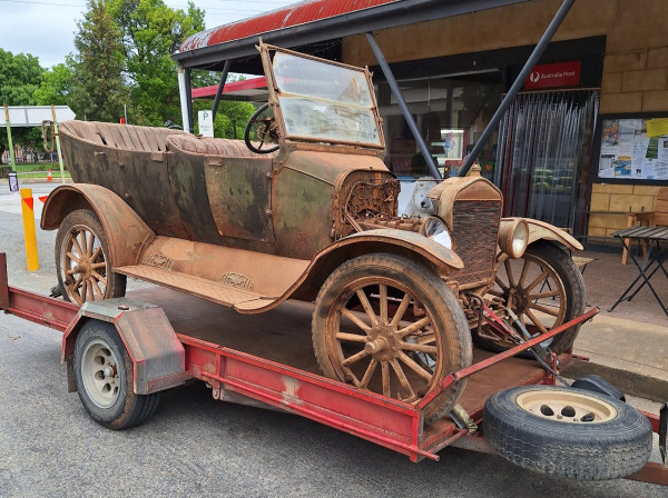

I would define "landscape" trailer. My every day trailer is a tandem axle 6x16 foot wooden deck traler with slide out ramps. Initial ramps were 4 ft long and it was a steep incline, so we went to 6ft ramps. They store under the trailer and allow for overhang , but do not allow a backstop like the entire rear ramp type.
When I think of a landscape trailer, I think the expanded steel mesh bottom and rear fold down tail gate and not a wooden deck.
And, stake pockets along the side in various locations allow for multiple strap hook up spots. I have some members of our military vehicle club that only have one jeep and only use the trailer for that one jeep and mark the trailer for wheel chock locations, cut the straps to length, etc but if you are going to use the trailer for different vehicles or other uses, think versitality when you select options. Some wooden deck trailers have side rails and some do not, your preference.

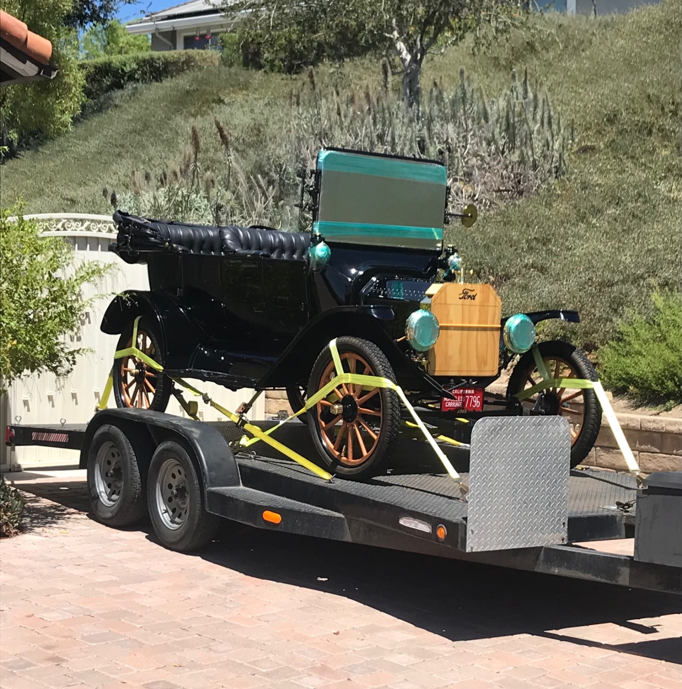

I have a few comments. First, Vehicles should be tied down BELOW the spring suspension. This allows the body to move up and down while holding the axles/wheels firmly. Scares the heck out of my wife when she is following me. This removes movement in the tie down straps, reducing the possibility of the straps disconnecting. I recommend "cross tying" at least the front axle. I have 4 short, 1" nylon straps with eyes on both ends. Spend the money and buy "Hoisting Rated" straps. They are stronger and less likely to be cut by the metal you put them around. I "choke" (as opposed to basket) around the front axle just outside the spring perch. Tie down right side of the car to the left side of the trailer. AND Left side of the car to the right side of the trailer. I do the same on the rear axle with the short straps around the axle housing near the pumpkin. I recommend using chocks fastened to the trailer deck for positioning the front wheels for proper tongue weight. Cris crossing the tie downs keeps the car from moving sideways. Pull the front tie downs forward and the rear tie downs rearward. This keeps the car from moving forward and backward.
Something many do not think about: Floor boards. I have had floor boards blown out of place and was lucky enough they did not work out the bottom. IF your floor boards are NOT secured in place, think about taking them out and putting them in the tow vehicle, storage box, or fasten them in place.
Concerning winches. Most winches are rated for use with 2 part cable. Meaning, the cable comes off the winch, goes to a "pulley" (Sheave block) and back up to the winch area to a dead end point. This splits the load on the winch in half. Thus, most winches rated at 2000lbs can only pull 1000lbs on a single part (straight cable). So, if your winch is bogging down when pulling, buy a sheave block and two part it. Horror Freight sells them for little money.
Do NOT pull directly/only on the front axle. There is a chance you might pull the wishbone ball out of the pan socket. It's better to use a small strap around the front cross member/spring mount. When using the cross member, I have found it to be OK to go around the cross member and axle at the same time.
Lastly, CHOCK your trailer wheels ANY TIME the trailer is NOT hooked up to the tow vehicle. DON'T let a loaded trailer roll away from you.
Before anyone attacks me: I operated cranes for 44 years. I have also hauled a TT from Illinois to Colorado (1100 miles) without any tie down problems.
Many of the old timers, know this stuff. This is for the newer people and those that seem to be having problems they can't figure out.
Good Luck!

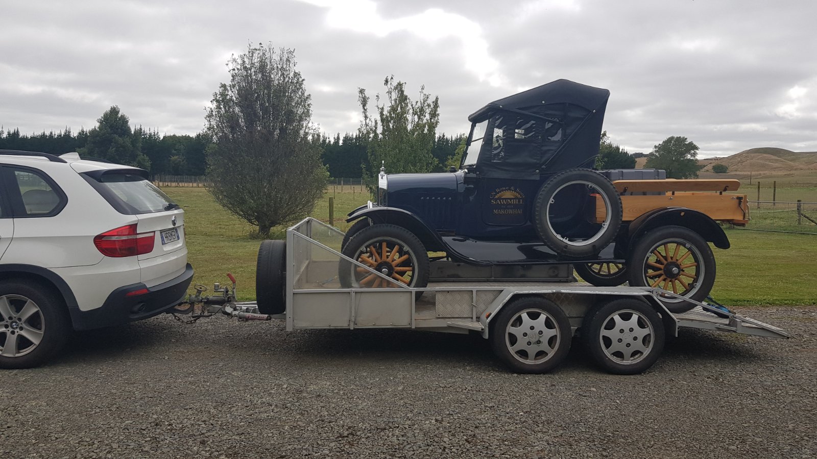

I'm jealous of people with enclosed trailers, but can't justify the cost. Having said that, I've never had a problem with our RPU on our open trailer. I don't have a top boot, so button up the side curtains instead to prevent the top being a parachute. Our speed limit for towing is 90kmh (about 55mph). I also learnt that the floorboards needed to be secured in place too.
Dan is right about considering the size before you buy. I thought our trailer was just right for shifting T's... then we bought a TT, and it's suddenly a bit small... even the RPU overhangs the back axle more than a tourer body so I very marginal when I had it in my parents enclosed trailer.

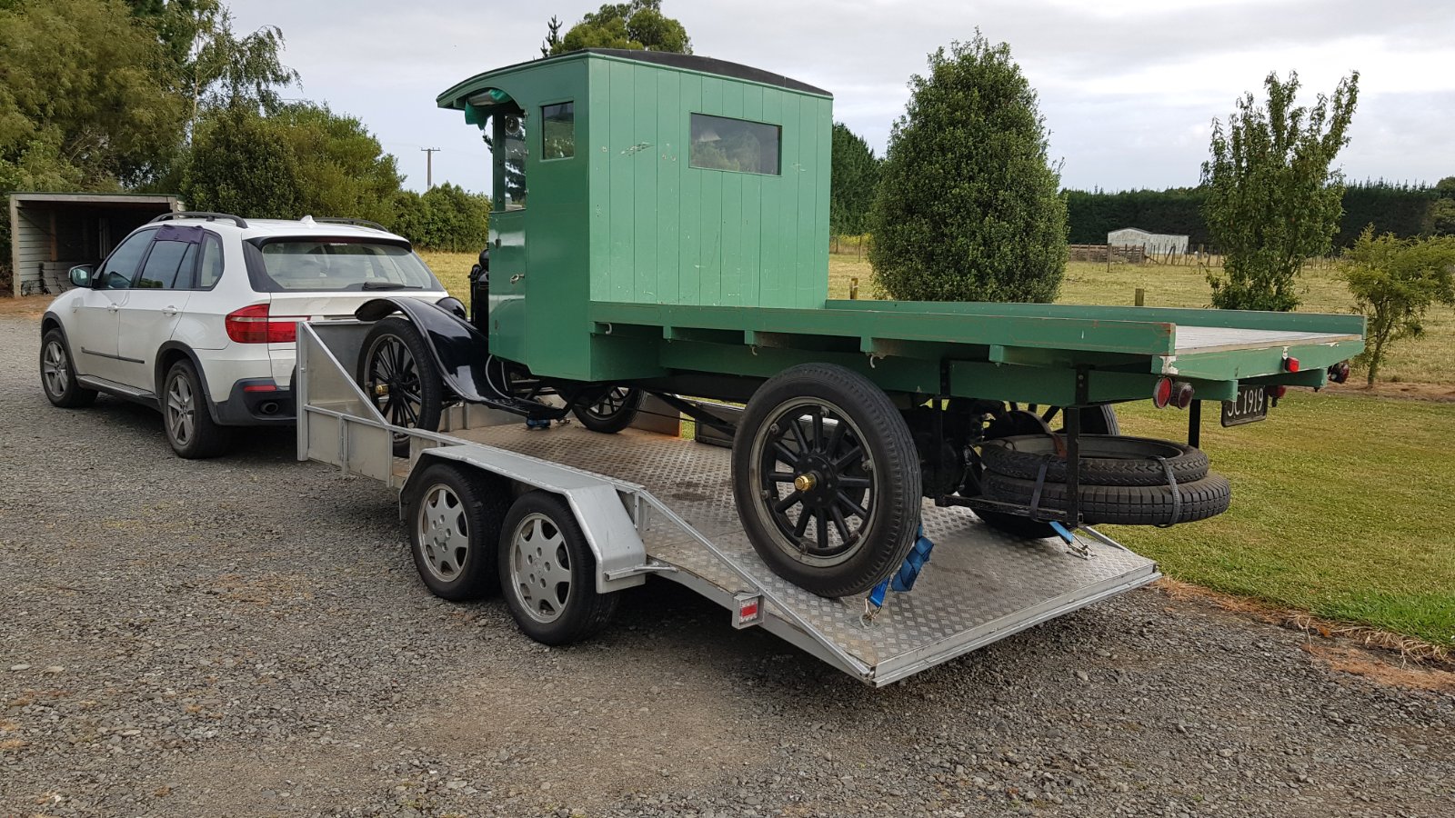

My single axle trailer is quite adequate for a T.
I have built and sold 5 of these 6' x 12' tilting trailers. The key to loading is the restraining bar at the front. I drive the cars up the tilted deck to the bar. A good handbrake will hold the car there while I get out to lower the deck.
Again the bar is key. Two short 2000kg tie downs around the front axle tie the car forward, and DOWN. There is no real load on the axle/ radius rod. All the tie downs do is hold the tyres against the bar. Similar tiedowns go round the outer ends of the rear axle. These do the work of holding the car from going forward on the deck.
I have used this combination to haul T's to rallies aĺ over the country. I have had two blow-outs. It was just a matter of pulling over in a convenient spot and fitting the spare. Absolutely no dramas.
My cars are all open cars except for a 27 Tudor. I have corflute panels to zip tie over the windscreens, the headlights and radiator. The tops are folded, or in the case of Henrietta, removed and put in the pick up.
It does not have to be complicated.

Re: T trailering question
In 23 years of ownership I have trailered my T exactly twice. The first time was when I bought it. I was quite the newbie and had never ridden in or driven a Model T before. The seller gave me a 10 minute ride and explained how to drive it, then he drove it up on my borrowed open car trailer. I don’t remember how I tied it down, but it made it the 60 miles back to my house. Driving it for the first time was backing it off the trailer, then going up my driveway. All was going well until I got to the 90 degree bend in my driveway, and I was going a little too fast. I pressed the brake pedal and it moved a bit before it stopped solid, the car not slowing at all. I panicked and drove straight into a bush! Fortunately, nothing damaged but my pride. I later discovered that during the trailer trip, the top floorboard has dislodged and slid down on top of the lower board, and being under the floor mat I didn’t notice it. The brake petal foot pad bottomed out on the double thick floorboard before the brakes applied. First of many Model T lessons learned the hard way.
I got most of the interior restored, then work and life got in the way and it sat under cover for almost 15 years until retirement when I finally had time to pull the cover off in 2021. After spending a full year installing new wheels, new radiator, rebuilding the engine, differential, running gear and suspension, in 2022 I had 30 miles on the rebuilt car when I decided to take it to a car show in our local Southern California mountains where I have a cabin, 130 miles away. I borrowed a friends 20 foot open car trailer for my second Model T trailer adventure. I researched this forum and got lots of excellent information about Model T trailering. I probably over-did it, but I had no issues on the 260 mile round trip.
All 4 wheels were tied down with wheel baskets. The front axle was tied down at the perches with straps running rearward to a center D ring. The rear axle was tied down at the outer ends with straps running forward to the trailer sides. This way the wishbone ball was in compression so it couldn’t pop out. Belt and suspenders I know, but since I apparently only trailer the T every 20 years or so, I didn’t mind the extra time for peace of mind. I put the top down, and since I didn’t have a boot I wrapped the top with two long cam buckle tie down straps. I tied the back doors together by putting a bungee cord across the body attached to the door handles. Same in the front, but attaching the bungee to the brake lever on the drivers side. I turned a rubber wheel chock upside down, placed it on the upper floorboards and clamped it it the brake pedal to keep the floorboards in place (lesson learned!). I made a plywood radiator cover that sits on top of the radiator tank on foam pads, and I have felt where it touches the brass frame. Notches on the sides of the plywood engage with a bungee cord that is attached to the hood handles to keep the radiator cover in place. I made covers for the windshield, the side lamps and the headlights out of 1 inch insulation foam board and attached them with plastic stretch wrap, securing the ends of the stretch wrap with clear packing tape so it wouldn’t unwind in the wind.
Like I said, I know it was overkill but I didn’t want to take any chances. If I was going to do much trailering, I would definitely lean towards an enclosed trailer.
I forgot just how much thought goes' into towing. Trailer capacity, tie downs, tow vehicle, decking, ramps, securing things on the car being
towed. Overall weight & brakes seem to be somewhat left out. I only use my pickup for towing about 5% of the time I drive it so for economic
reasons I have a V6 manual trans 1/2 ton. When I tow the fire truck on the tandem dovetail I'm within 100# of the max towing capacity. I don't recommend pushing the limit that much as it will slow you down going up hills & push you down them. On that trailer I have 4 wheel brakes
that will by themselves stop the hole rig if needed. I have a professionally built custom single axle trailer that I pull my speedster with that
only weighs in at 500# and tows very well. I guess what I'm saying is make sure your tow rig and your driving ability is safe enough for the task. Craig.
mtntee20
- Posts: 708
- First Name: Terry & Sharon
- Last Name: Miller
- Location: Westminster, CO
Craig,
Excellent points. Many, commercially built, trailers have either 3500lb or 6000lb axles. Trailer axles available: 2000lb, 3500lb, 6000lb, 7000lb, 8000lb, 10000lb, and 12000lb. I have a half ton pick up. My total towing weight with the TT and trailer is 5000lb on a twin axle trailer. If I move up to the 6000lb axles, the law says I need a 3/4 ton truck based on the Gross Vehicle Ratings, and it doesn't matter if you're towing less weight or not. Check your vehicles' GVW ratings for towing capacity AND GVW load ratings.
NOTE: In Craig's photo, there are 2 spare tires. As wise choice for a single axle trailer but a tad bit of overkill as the possibilities of BOTH tires going flat is not high, but still a good idea. My son taught me: IF you have a double axle trailer, ALWAYS carry 2 spares (at least). The reason: IF you run over something that will flatten a tire, you have a great potential for flattening BOTH tires on that side.
NICE trailer Craig. A real beauty.
Good Luck
Good Luck

- Posts: 7275
I have always used a full floor single axle trailer for my various model T's. I have built the same trailer for others. The blowout fears are just that.in 35 years I have had two blowouts, at highway speeds, with never a drama. One was with a ton load of swap meet parts and tools. My wife asked what the bang was. We just rolled to a stop and fitted the spare. The second was more recent, thousands of km into a four day tow to a national rally. I had to drive a few hundred feet before I could pull off the road far enough to be safe when fitting the spare. Again, no dramas pulling up/controlling the stop.
I do use load adjustable electric brakes. I do run light truck radial tyres. I do load the trailer to achieve proper weight distribution. I do appreciate being able to wheel the trailer into some impossibly tight spots in my yard and at Motels, all by myself.
Craig Leach
- Posts: 2034
- First Name: craig
- Last Name: leach
- Location: Laveen Az
Two Spares is a result of past experience. I have had two flats more than once on a trip. I loaned my tandem trailer to the XW & HIL once & it
came back with three new tires on it. I don't run trailer tires more than five years regardless of tread depth, tires are cheaper then body work.
Craig.
Craig.
