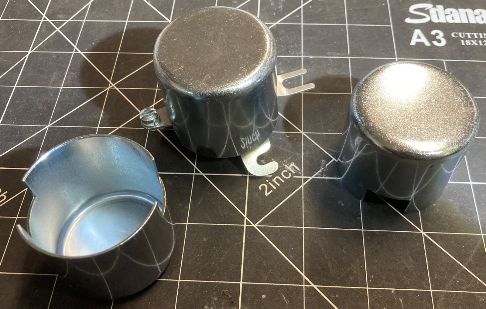

I'm looking for "victims" willing to test a new Model A Positive Ground Voltage Regulator I'm about to start mass production on. I've been working on & sold a couple hundred of the 6v & 12v Model T version that is negative ground and those works really, really well. The Model A is a redesign of that version for the positive ground Model A. It also has a screw on the generator tab for the generator output connection.

AdminJeff
Re: Model A's Voltage Regulators - Model T generator life
I'v got 3 solid testers now. I'll let you know if I need more folks!
My regulator simply replaces (and looks exactly like) the existing cutout - no other changes required.
Jeff
