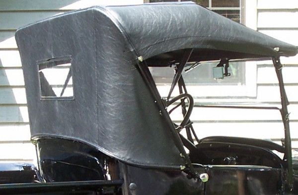

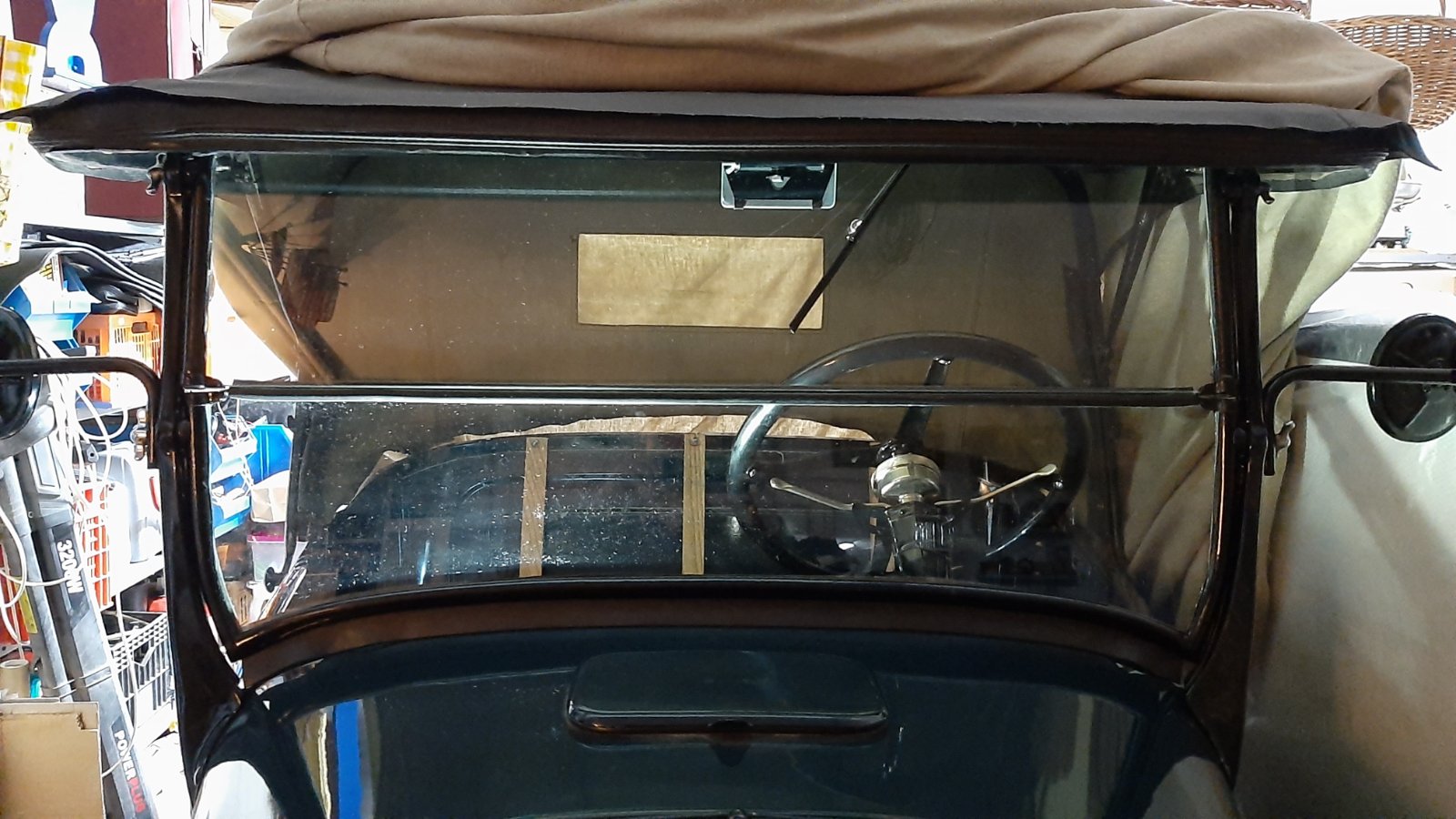

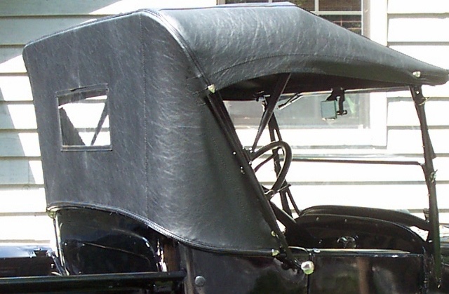

I have 2 26 open cars. One a Roadster and the other touring. both have the mirror in the center and the wiper to the left. Nothing bumps. I don't see how you could get a view directly behind you when the top is up unless the mirror was in the center.

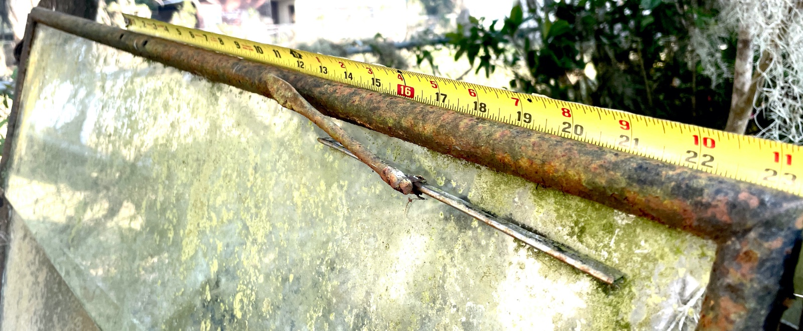

The late '24 (Oct '24) {well technically the 1925 model year} and up to 1927 open car windshields have two holes for the accessory rear view mirror and one hole for the wiper located in the same places.
The wiper hole is approx. 12" in from the edge of the driver's upper windshield frame.
The pair of holes for the mirror are approx. the same distance, the farther hole for the mirror being about 12" from the wiper hole.

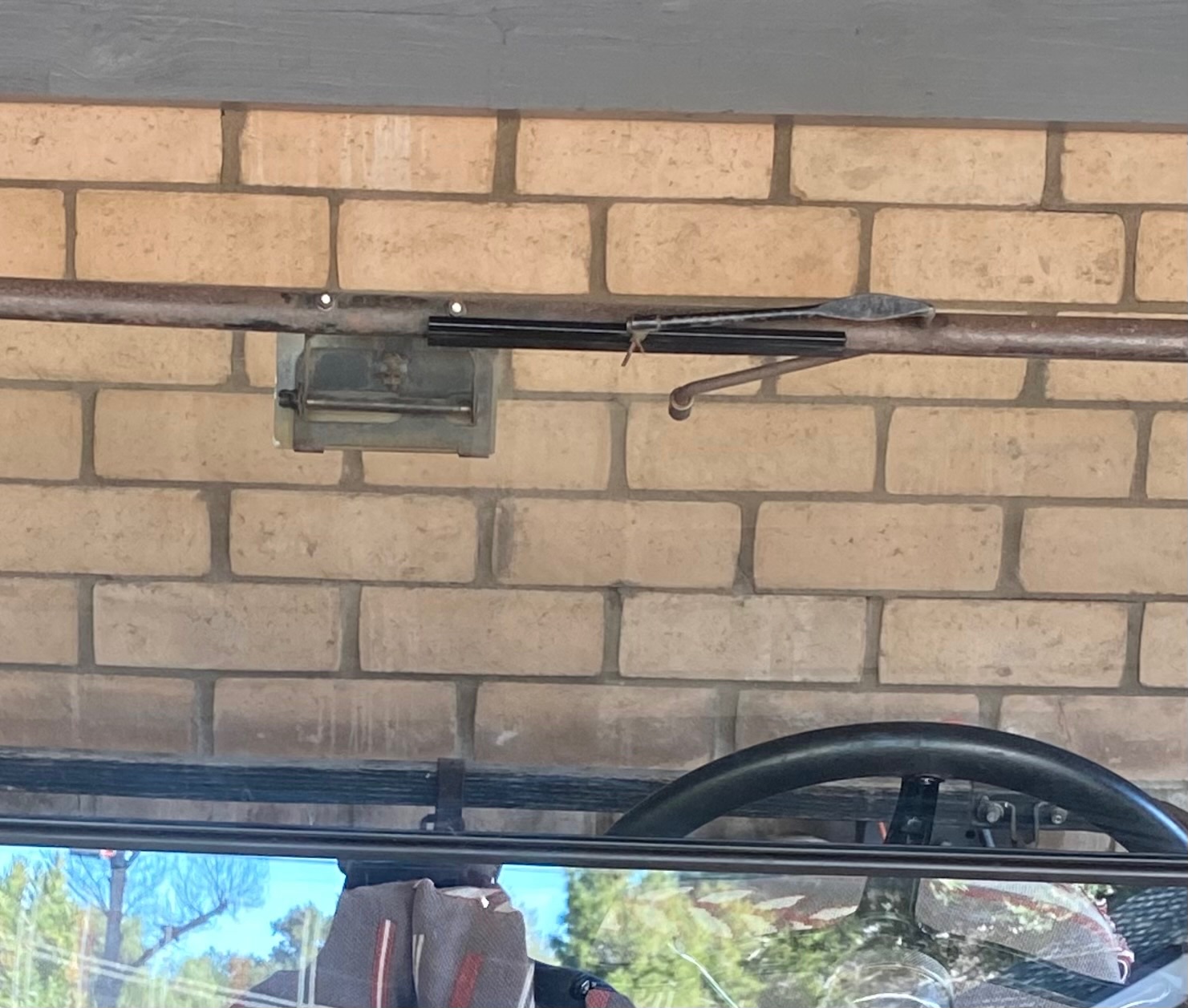

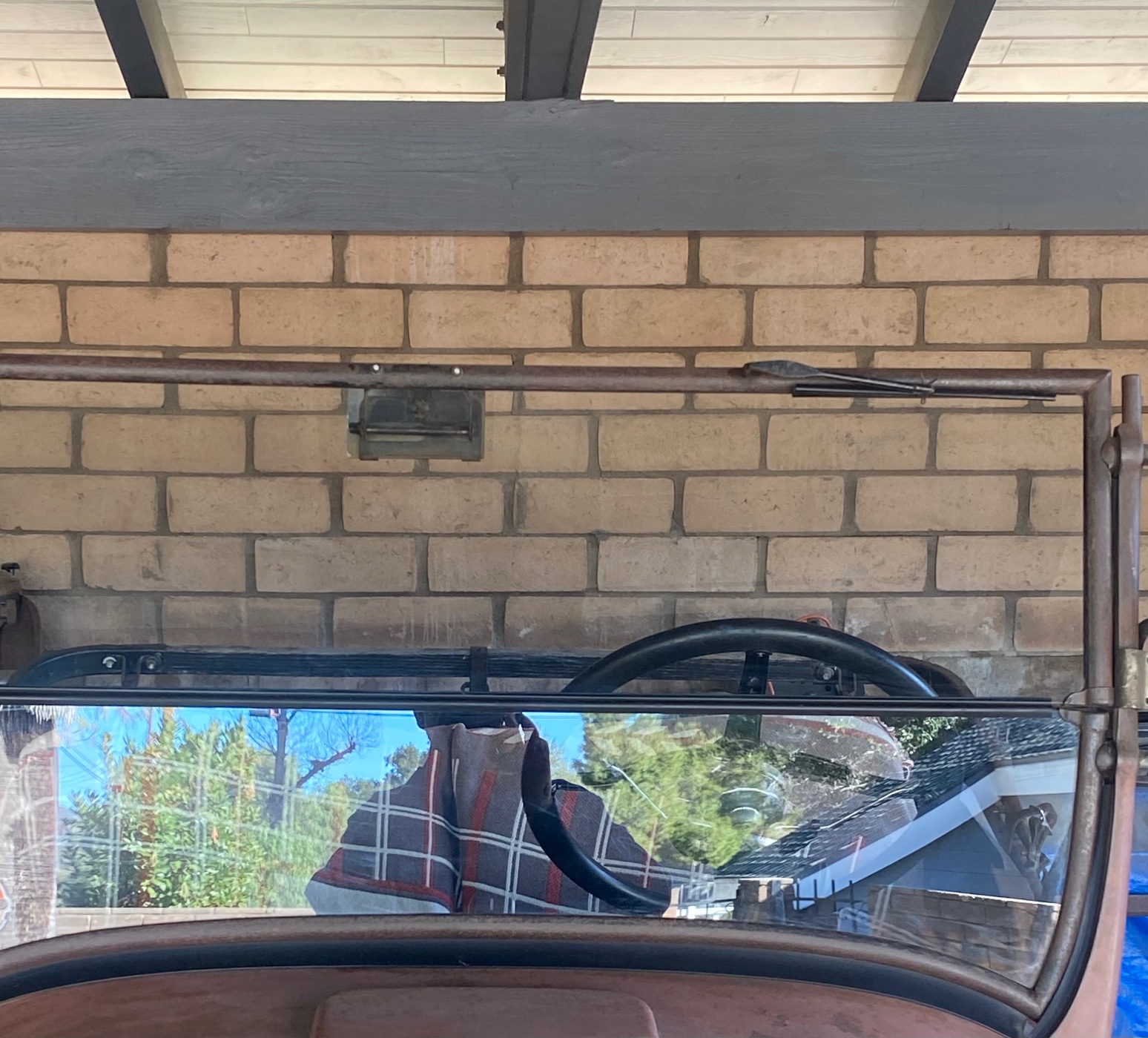

Eric - my 1926 roadster pickup has three holes.

Dan and Chuck, my frame matches the dimensions you indicate, which means all I have to do is flip the upper windshield and it'll be right as rain (pun intended)
