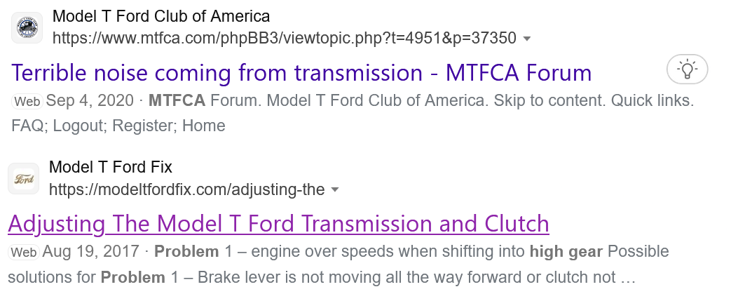

Noise https://www.mtfca.com/phpBB3/viewtopic. ... 51&p=37350
Adjust https://modeltfordfix.com/adjusting-the ... nd-clutch/ --

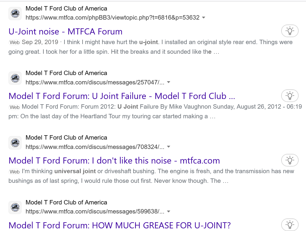

Multiple discussion on possible U-joint noise https://www.bing.com/search?form=MOZLBR ... oise+mtfca
