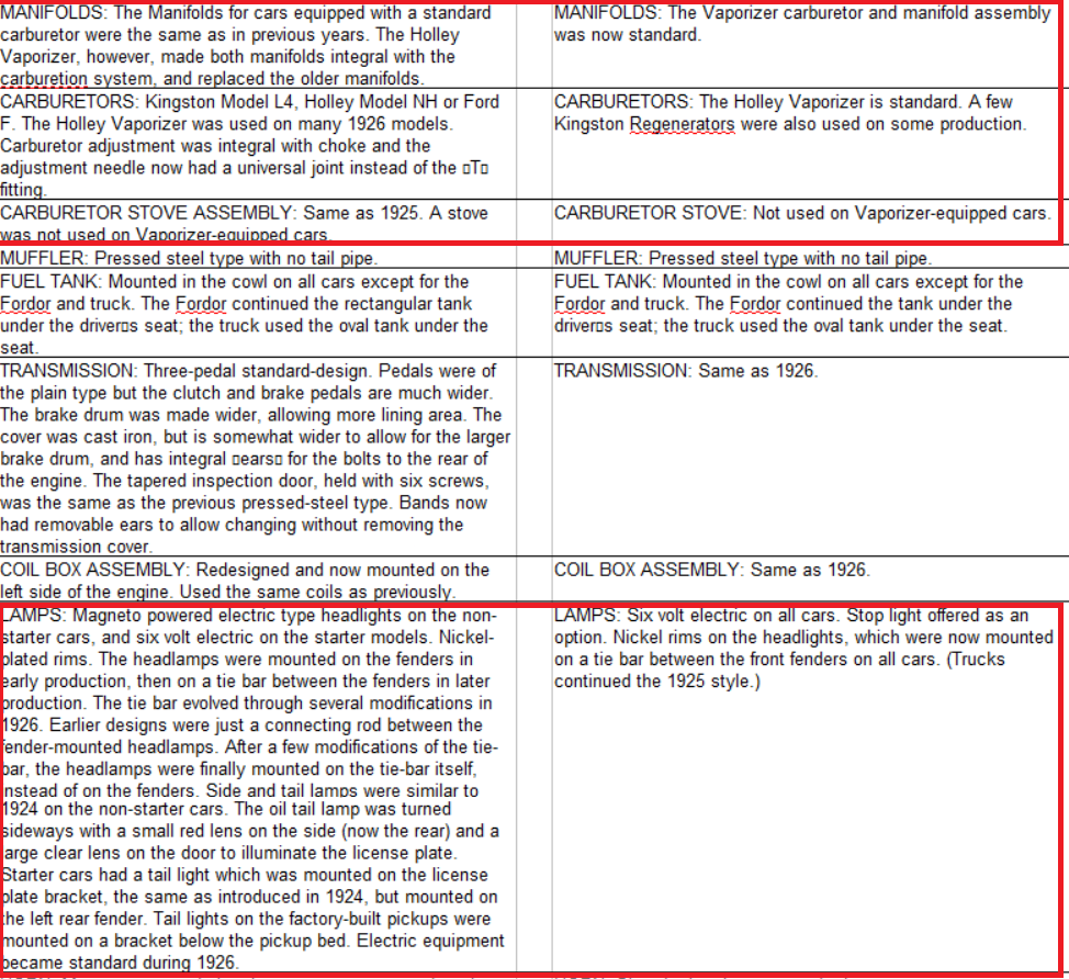

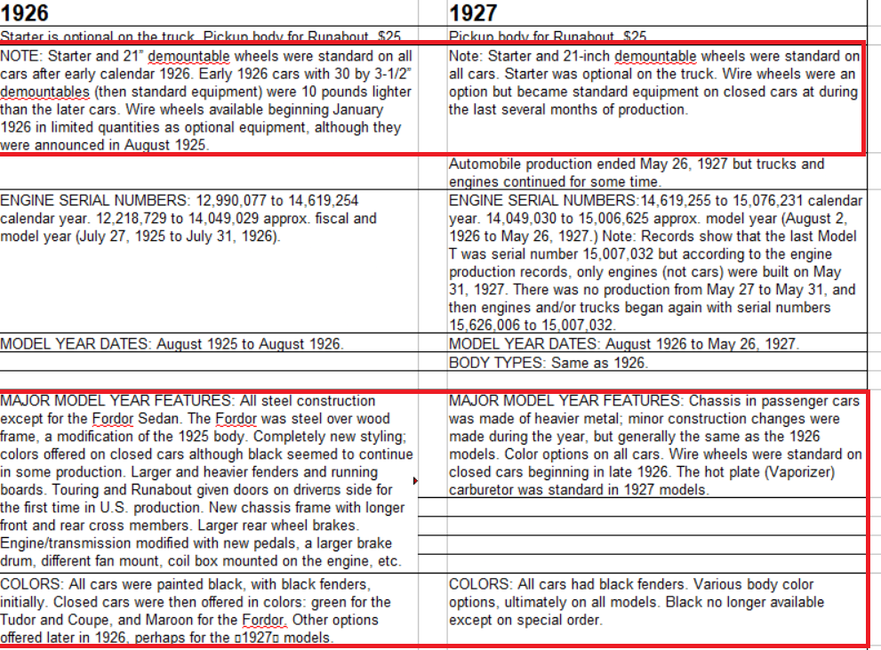

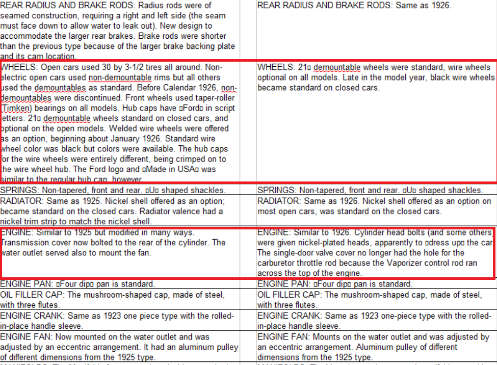

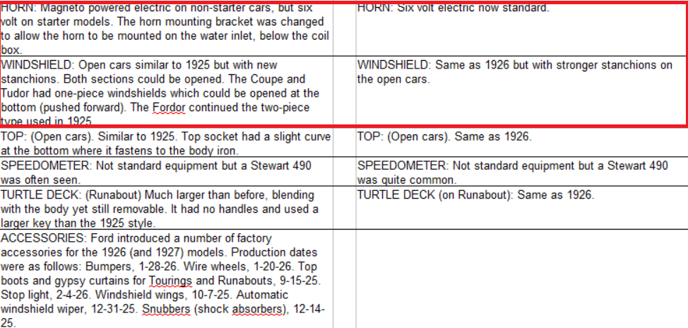

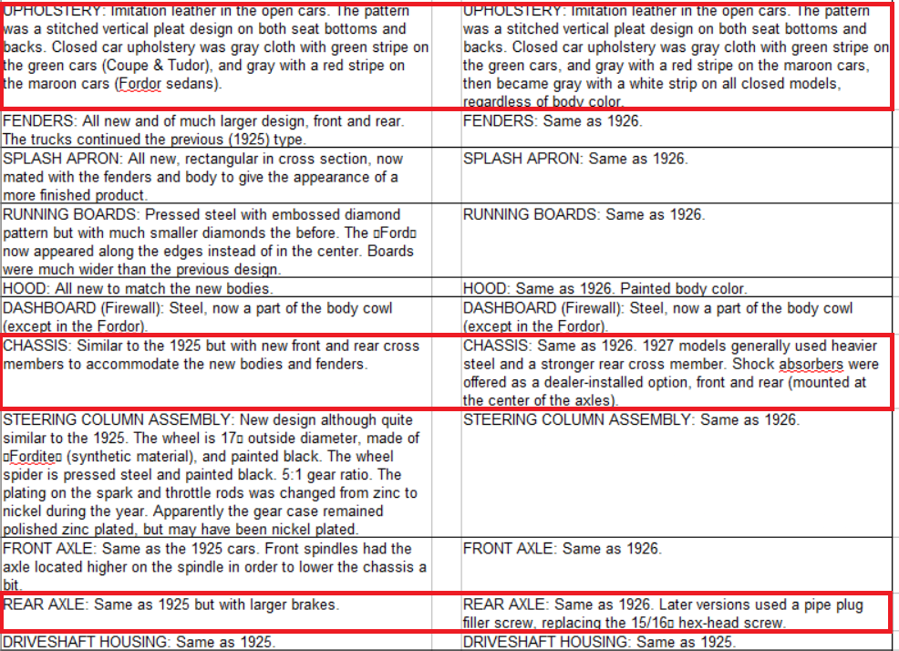

From the Forum Encyclopedia
1926 https://www.mtfca.com/encyclo/1926.htm
Touring Early models with 30 x 3-1/2 non-demountable wheels and no starter. Available only on special order before calendar 1926.
Touring Includes starter and 21” demountable wheels.
1927 https://www.mtfca.com/encyclo/1927.htm
Starter and 21-inch demountable wheels were standard on all cars.
