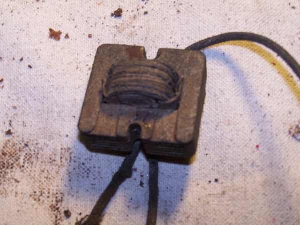

The "Resistor" that is used on the non-starter Model T is actually an Inductor.
It is a coil wound around a laminated core.
The inductor acts like a variable resistor that varies with engine RPM (Magneto Frequency).
As your key is on the coil box, the inductor would have been mounted on the firewall.
Headlight Dimmer-3.jpg (37.41 KiB) Viewed 1605 times

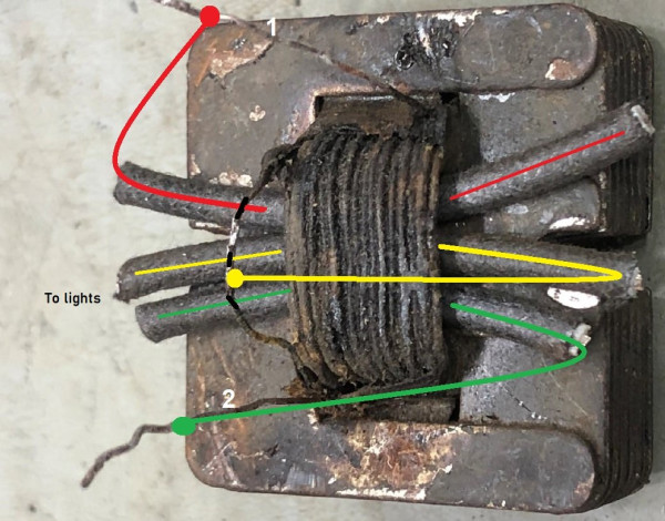

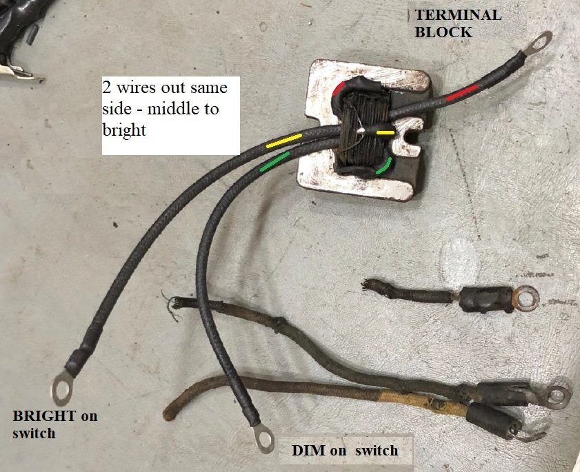

Here is the wiring for the dimmer. The wires are to be insulated. Starting from the colored circle end they are tucked under the coiled wires
Horn wire should be 14ga

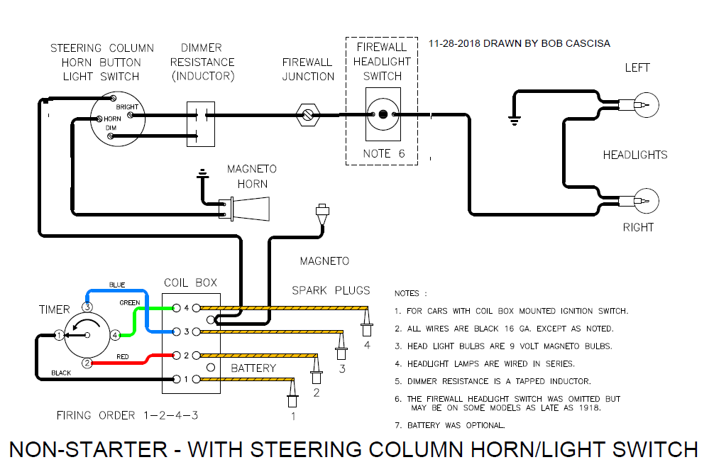

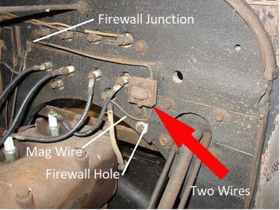

Here is the best photo that I have.
Respectfully Submitted,
Be_Zero_Be
I drive a Model T ... Microseconds don't matter :D

I would make the wires from the magneto to terminal block to switch to horn to ground 14ga. Wires to lights 16ga as indicated in the diagram. Lang's sells Horn wire , black. To insulate, shrink tube, then a bit of black silicon seal to make t look authentic.
There are three horn switch styles. One is just a button on top of the steering column. The other two are similar in that they clamp onto the steering column. One is just a button and the other is a button that rotates to turn he lights on. The color diagram is for the combo switch

Re: the picture
Ah-ha!
There's a hole in the firewall, for the magneto wire to go in and the two light wires to come out.
And the "junction" looks like it's just a small right-angle tab that I think I remember seeing in one of the other drawings I'll try to find. It's location starts to explain why the 5-wire commutator harness with the 5th wire for the headlight has such a short headlight wire, because it only goes to the junction on this end.
One of my challenges is the car I'm helping with is in another state, so between visits I have to go by memory, or squinting at photos I took before I knew what I should be looking for.
