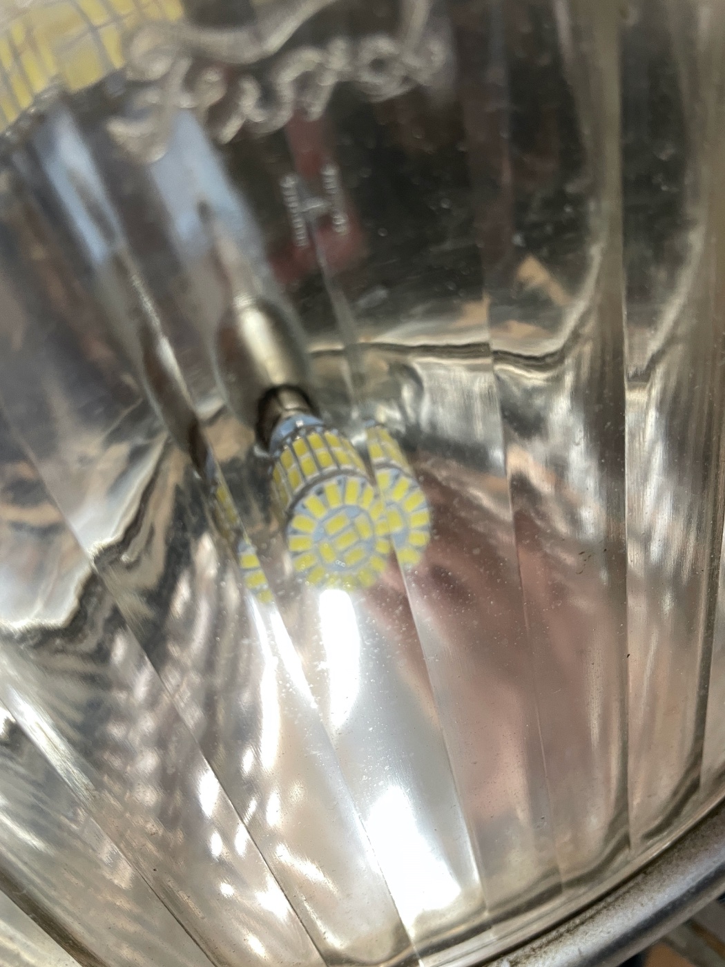

Hello to all my MTFCA friends!

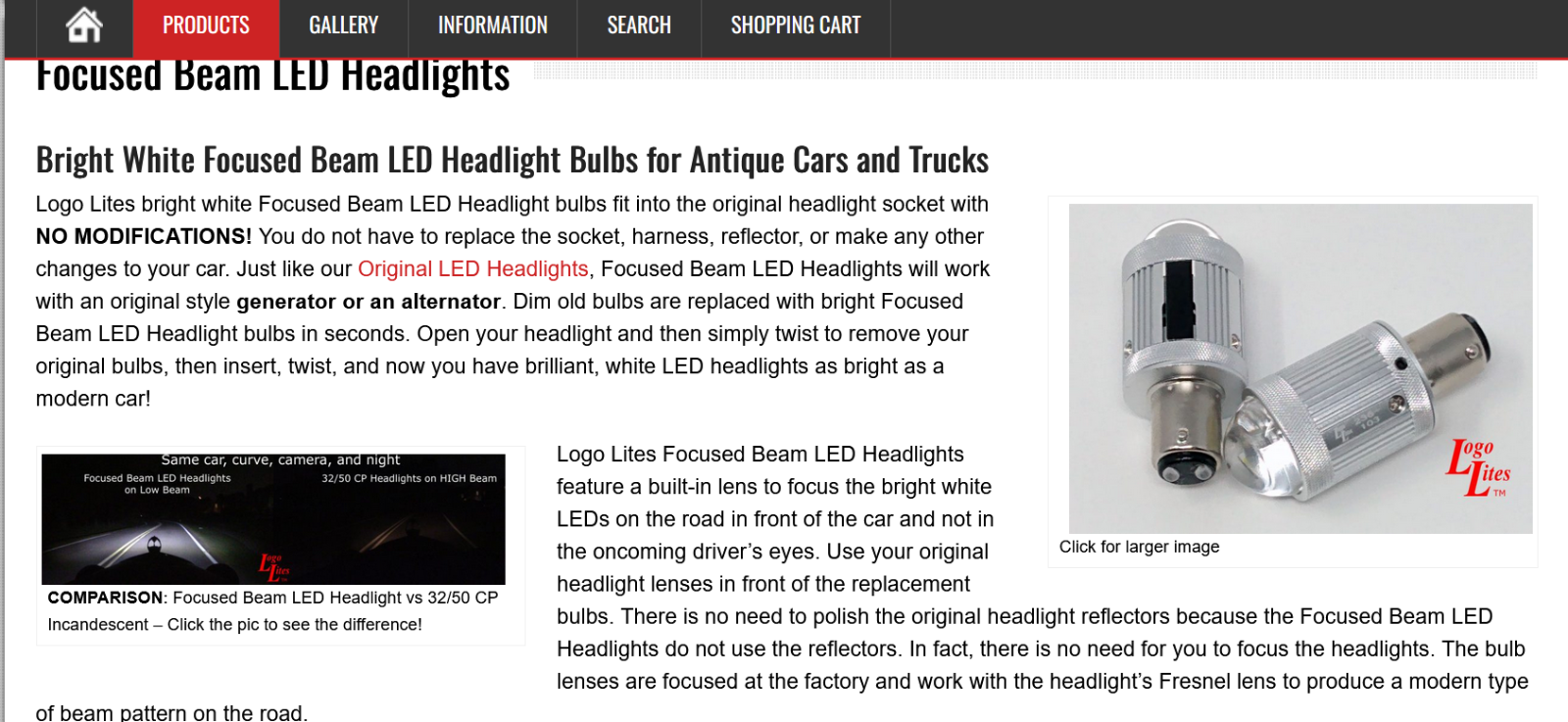

I have a question regarding changing over to LED bulbs in my headlights, and I notice the new LED bulbs are not turned to the correct position. The bulbs I am trying to use came from one of our vendors Logo Lite No. A-3007-LED. I believe when correctly installed, they should be horizontal in appearance with a red dot that should be on top. I do not get the horizontal positioning as the bulb sockets will not allow that to happen. Do I need a different socket for this or a different LED bulb if one is available? Has anyone else encountered this problem? I want to dim & bright my lights as I should be able to.

Here is the the Logo Light product site https://www.logolites.com/products/led- ... eadlights/
Here are the instructions - just navigate down the site

Regarding the LED bulbs that I have, I don’t believe mine are adjustable. It looks like I will need a different type of bulb as per previous post. Thank you for the response!

First please confirm your bulb your having trouble with , think you left out the 1 is it A-13007. Best to post a picture of your bulb to get helpHarvey Bergstrom wrote: ↑Sun Feb 11, 2024 7:11 pmRegarding the LED bulbs that I have, I don’t believe mine are adjustable. It looks like I will need a different type of bulb as per previous post. Thank you for the response!
Other than correcting to orientation of the bulb as described in the instructions there isn't much adjustment, even for a filament bulb.
So if you still have a problem then need to check your lens as it focuses the light. If it is a standard FORD Model T H fluted lens the flutes should be in a vertical,( up & down).

I believe there were problems with the orientation of the bulb filaments in new bulbs and reproduction sockets at some time.
If you have the correct combination there is plenty of adjustment in the focus screw which determines the depth of the socket in the lamp body.

Even with new bulbs filament bulbs the orientation is not correct from original production units. Bill Robinson and I found we had a left right shift in light instead of high and dim. We rotated the sockets 90 degrees to correct this issue. When we went to LED headlight bulbs, the orientation for them is also correct.

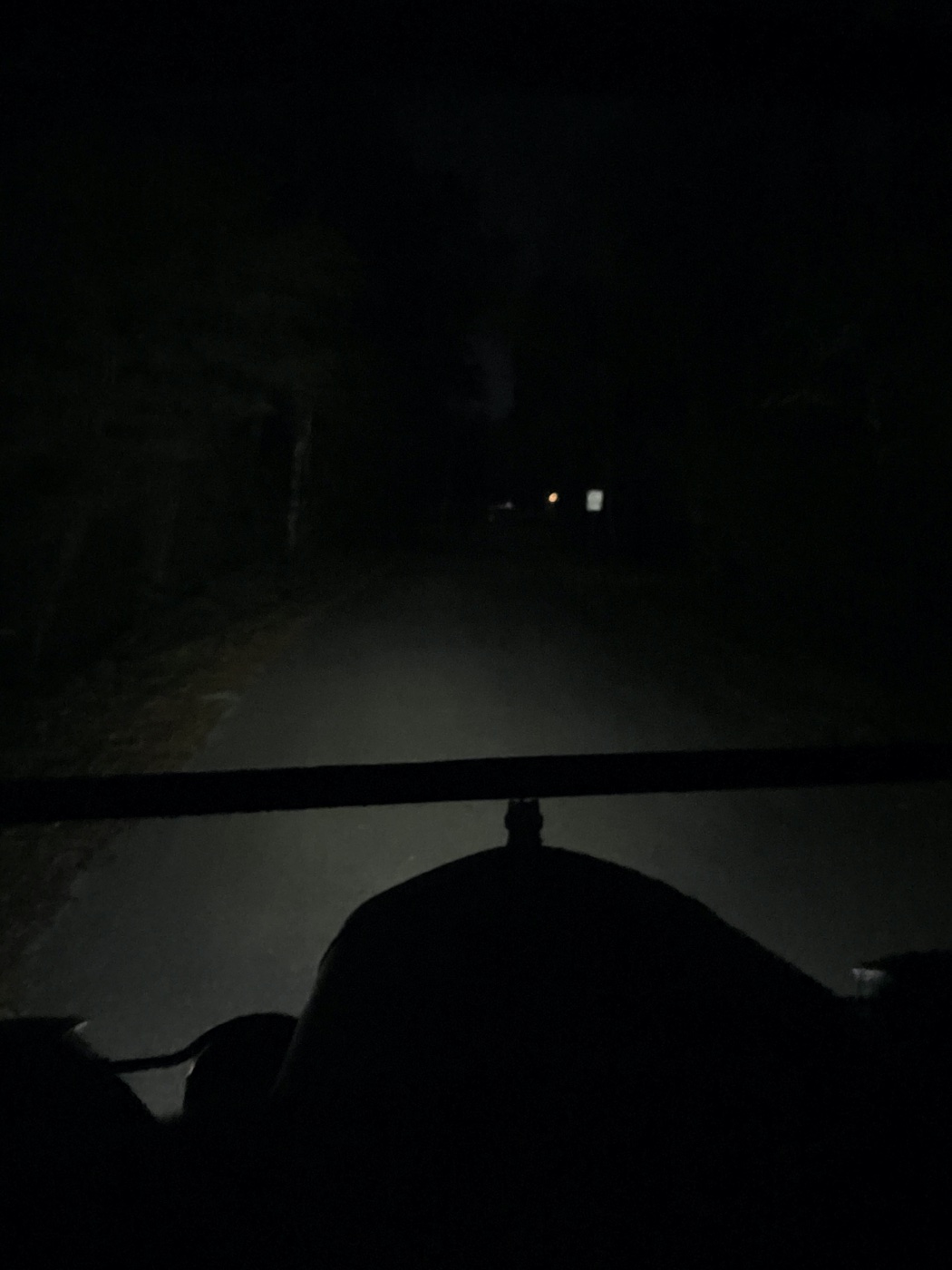

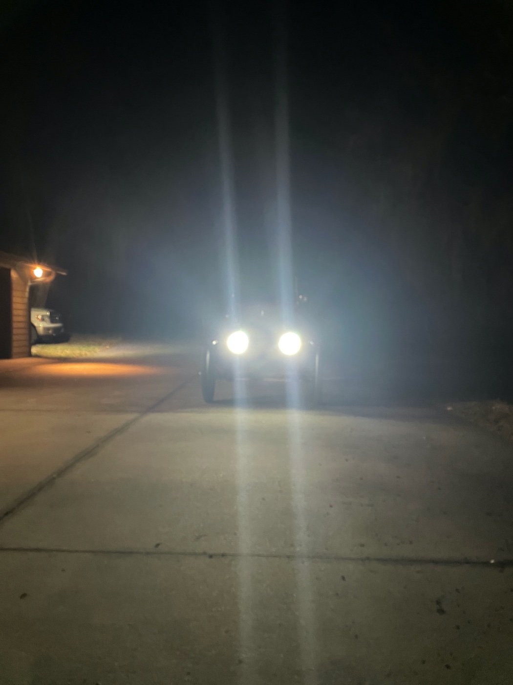

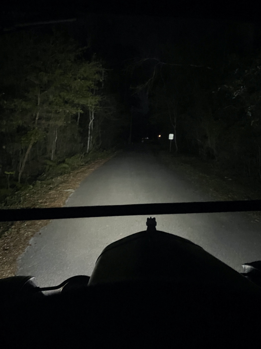

I did a video on these bulbs and the upgrade. Here: https://youtu.be/VW7fsNX9KQg

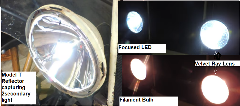

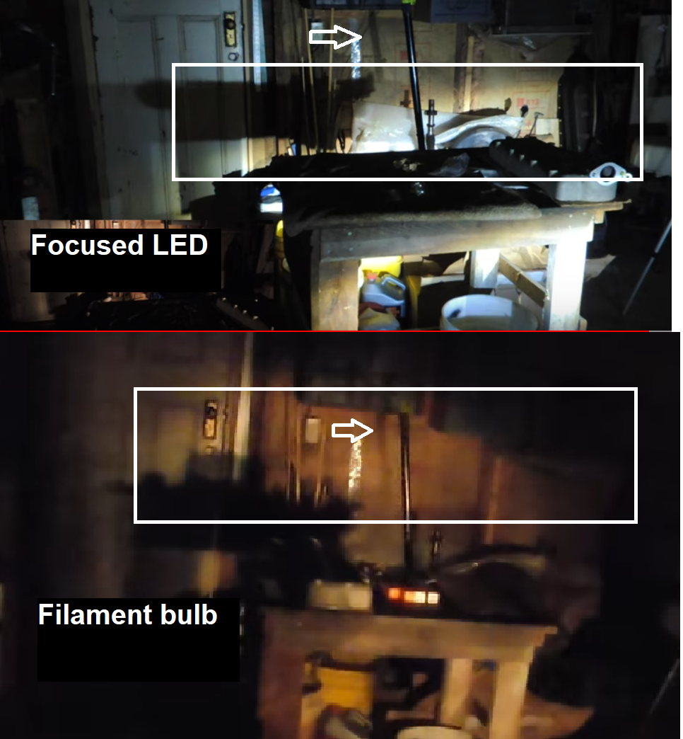

Thanks for the video it does show some good results with thee "Focused Led" bulbs. An easy justification for them is that its not necessary to replace the headlight reflectors ($38.95 each) since the really don't serve any purpose since the Focused Bulb contains its own reflector.TheSpeedsterProject wrote: ↑Fri Feb 16, 2024 1:30 pmI did a video on these bulbs and the upgrade. Here: https://youtu.be/VW7fsNX9KQg
The filament bulbs light source is adjustable to be at the focal point of the reflector for optimum light distribution. This is necessary for any type of bulb dependent on using the reflector. Its easy to see that the Focused LED lens is well beyond that and the reflector is just capturing light emitted from lens glass. The picture below shows the difference in how the headlight reflector illuminates the Headlight lens making the Filament bulb look brighter. So these would be better for those wanting daytime running lights vs night driving. --
In the following video clips I am not sure if the Filament Bulbs were properly adjusted. --
Also the headlight lens is not the stock fluted lens but a Velvet Rays. The first generation of headlights were plain flat glass that blinded (really?) on coming drivers (cars & buggies), so laws were past for the lens to provide a sharp cut off of light, hence he darkened hood on many aftermarket lens of that period --
In comparing light output, white light (6500K) will always look brighter than warm light (4000K) for the same amount of lumens (that the measure of actual light) . Warmer light gives better definition of object. In looking at the arrows in the attached you can see the differences in the shadows but note too the difference in the light reflect off the pole.
These are the best LED's I've seen. I'm sold (my headlights reflectors are so so ...

Harvey, forgive me if this sounds stupid, but was the difference between magneto headlights versus generator headlights not that the sockets for the bulb were 90deg. off between the two and that causes your filaments to be oriented vertical instead of horizontal ?
