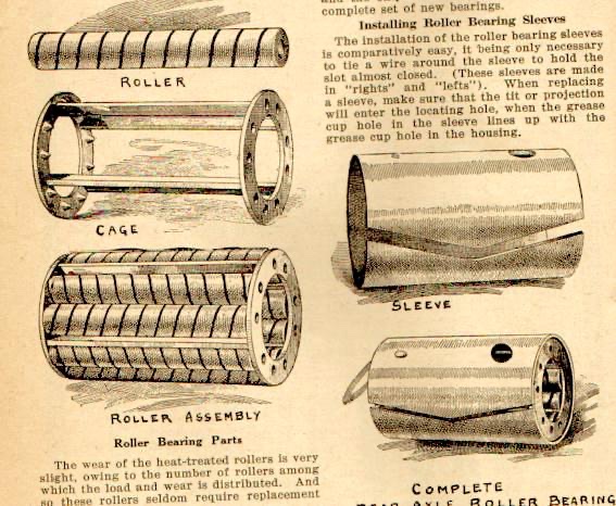

Those familiar with Hyatt bearings may already know about these modern spiral or helical roller bearings that are currently used in high temperature applications like rolling mills for continuous casting of steel. They resemble the original model T axle and driveshaft spool bearings but are much larger. I do wonder if smaller versions of the rollers might be available. If anyone knows more about these please share. Sincerely, jb
https://www.pun-waelzlagertechnik.de/en ... 1513_2.jpg
- Posts: 4462
Re: Hyatt Bearings (almost)
Interesting! The bearings are larger, but the rolloers appear to be at least near the same.

I am familiar with the Hyatt wound roller bearings. Hyatt Roller Bearings was a division of General Motors and New Departure Ball Bearings was also a division of GM. The two divisions merged as New Departure Hyatt Bearing Division of GM on March 1, 1965. Sandusky became the headquarters for the Division.
In 1962 I was hired by New Departure as an engineering cooperative student. This allowed me to work in every department in the Division. In 1966 I became an application engineer in the Product Engineering Department.
I must leave this writing at the moment to attend a close friend's funeral. But will continue later.

The fixed costs to tool the manufacturing of spiral wound bearings would be simply too high. At Hyatt, square wire was wound on a mandrell to rolled lenghts of 20 feet. These lengths were thru-feed centerless ground, cut to finished roller lengths, carbonized, hardened, then finish ground. The cage manufacturing involved stamping presses, machining the cross bars, etc.
All of these processes are very expensive to tool
These bearings were invented by John Hyatt in about 1895 for the sugar beat industry. Eventually these bearings were used in automotive rear axle bearings.
The advantages of wound roller bearings are the ability to absorb shock, to accommodate some misalignment, and to tolerate a fair amount of contamination (dirt). The downside is they have lower dynamic capacity than a similar size conventional cylindrical roller bearing. I want to calculate the capacity and expected life of these bearings in the outer axle bearing position. The analysis of the inner bearing position is much more involved because of gear loading.
My thought on the replacement of these rear axle bearings is to figure out what it takes to use a solid roller bearing. With some application development, I think that these will last for an acceptable time, but probably not as long as a wound roller type.
The subject of mounted clearances need to be addressed. I will disclose my thoughts, but I predict a fight will develop just like my fight several years ago with setting coils.

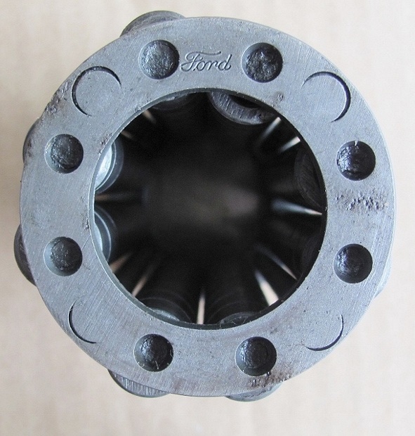

I reiterate, solid rollers will go 10,000 miles or more if properly designed and installed. These outers are fairly easy to change.
It looks like there is no need to do any development at this point because there enough old ones to fill the needs. The wound roller bearings will last longer if they are given at least .005 inch clearance maybe 010 might even be better.

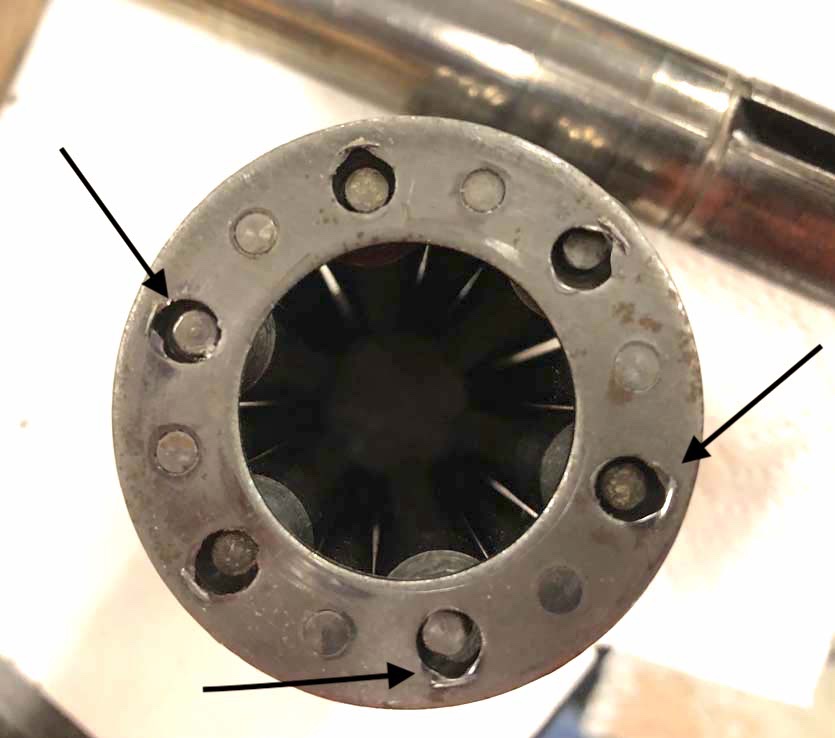

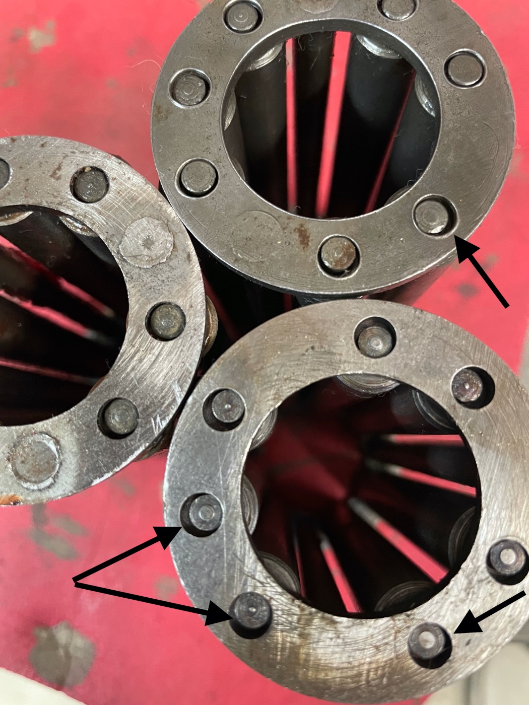

Every one of those solid Rollers that I have removed, IMO, show distinct wear out of the pinion ends of the solid roller. Some solid mfg. have 6 and some have more of those tiny pinion ends that are extra axles that turn in the cage, and wear out the cage holes.
The Hyatt Ribbon Roller bearing doesn't use a pinion axle in the cage, the Ribbon Roller can float a tad and that prevents abnormal wear. Of course the cage end rivets can become loose, and that renders a Hyatt bearing useless.
But that solid Roller design can escape the cage holes and bind. Known happening with the large dia. solid Roller driveshaft bearing.

The original drawings were drawn with ink on linen clothe. I worked on these in the 60's. They are difficult to make changes and don't reproduce very clearly.
In response to the roller axles (called trunions) wearing on the cage: this is where development comes into play.
I think I have seen solid roller axle bearings without trunions. The cage controlled the rollers
Art Mirtes

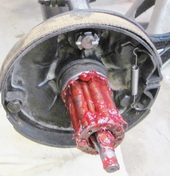

What grease is best for Hyatt bearings? I've been using automotive wheel bearing grease in mine, will this suffice?
- Posts: 6579
- Posts: 4083
Those inner Hyatt's get lubed from the rear axle lubrication, usually 6000W.
The outer Hyatts get lube from filling and turning the grease cups, a good wheel bearing grease, like Valvoline universal red type is just fine.
