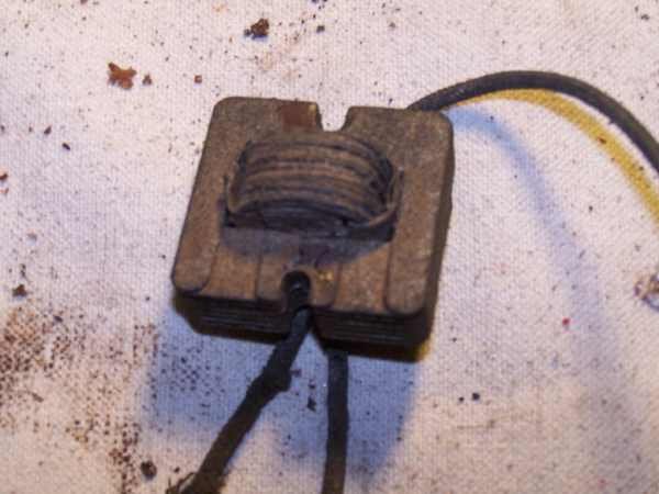

Mike, I have just removed a 'resistor thing' form the old car I am presently working on returning to the road. It is a simple winding of some copper wire about a ceramic looking core like coilbox insulators. It stands of the wooden firewall on two pieces of metal strap, one on each end. I have a second one I could send you for the cost of postage, but being of Canadian source, it may be a bit different to US examples.

The "Resistor" that is used on the non-starter Model T is actually an Inductor.
It is a coil wound around a laminated core.
The inductor acts like a variable resistor that varies with engine RPM (Magneto Frequency).
As your key is on the coil box, the inductor would have been mounted on the firewall.

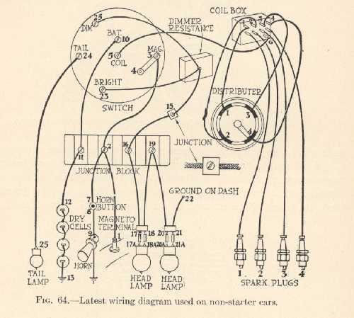

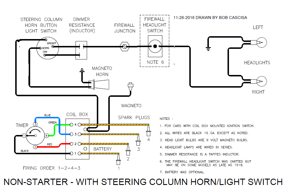

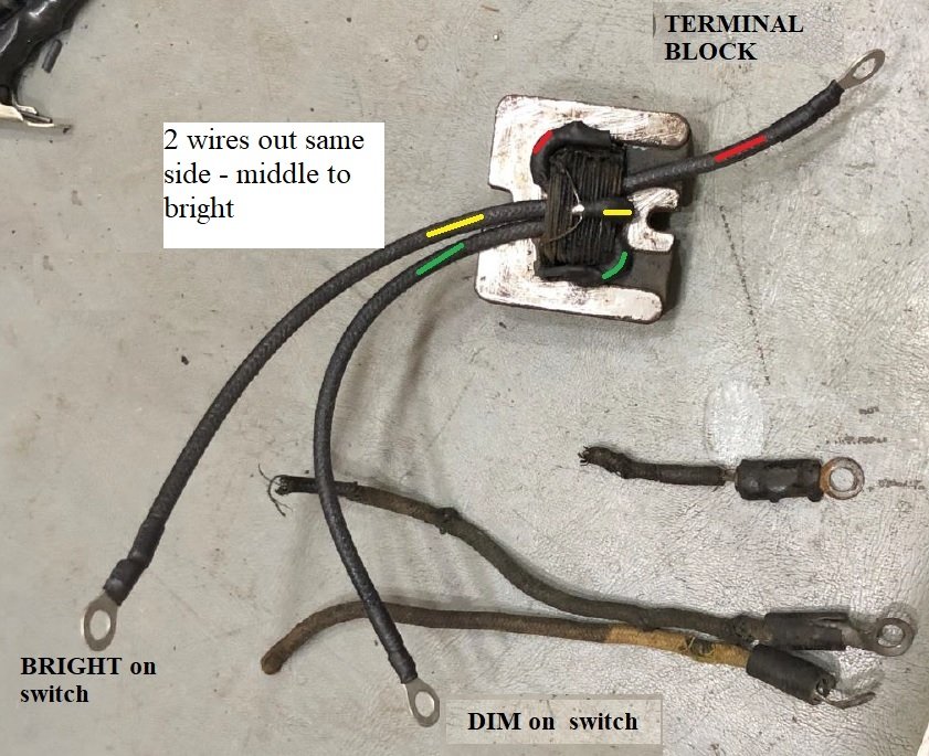

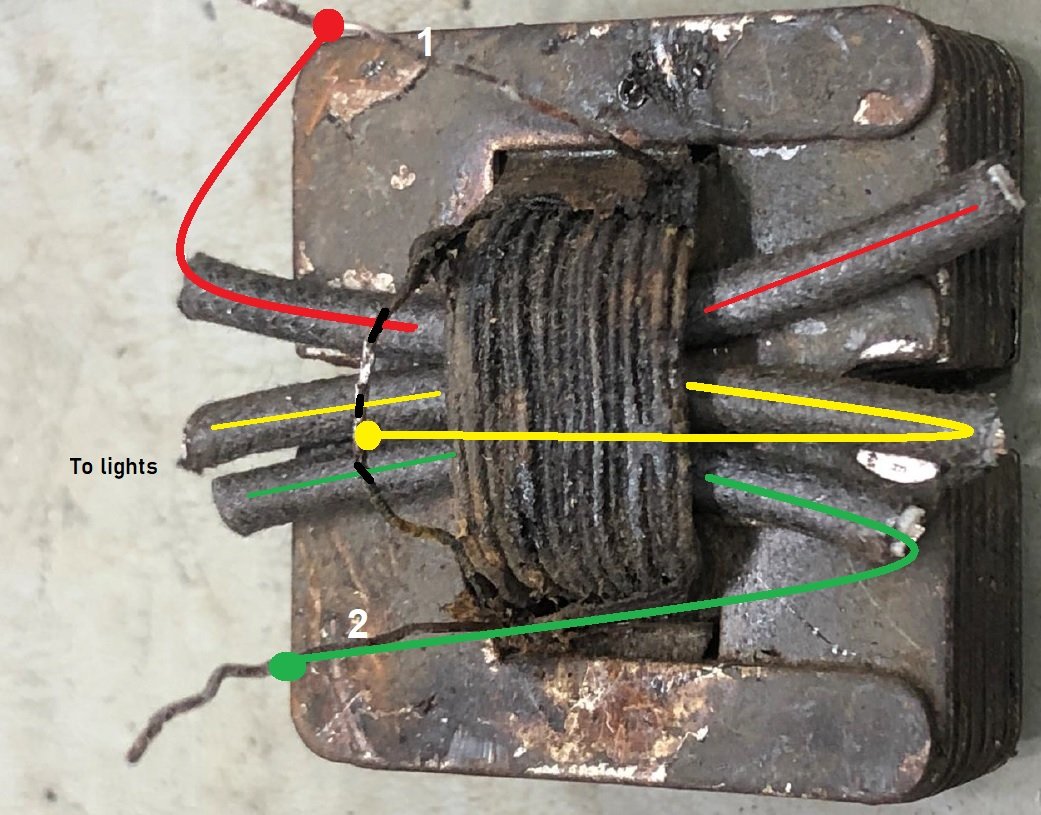

Here is the wiring for the dimmer. The wires are to be insulated. Starting from the colored circle end they are tucked under the coiled wires
Horn wire should be 14ga

I would make the wires from the magneto to terminal block to switch to horn to ground 14ga. Wires to lights 16ga as indicated in the diagram. Lang's sells Horn wire , black. To insulate, shrink tube, then a bit of black silicon seal to make t look authentic.PuzzleTFord wrote: ↑Tue Feb 13, 2024 3:30 pmThanks, that's what I was looking for.

There are three horn switch styles. One is just a button on top of the steering column. The other two are similar in that they clamp onto the steering column. One is just a button and the other is a button that rotates to turn he lights on. The color diagram is for the combo switch
