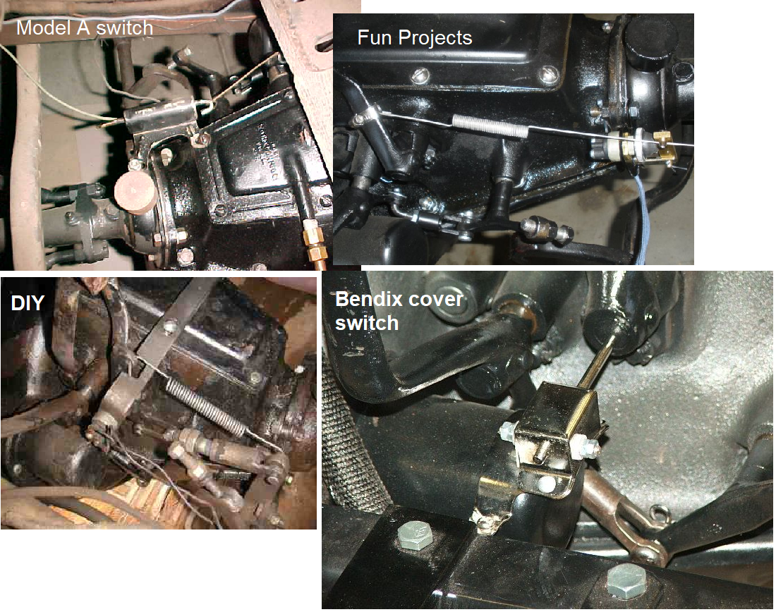

Negative feedback??... Just remember there are three stories... Positive, negative, and then the truth. As far as I'm aware, Fun Projects , is no longer available because fun projects no longer exists. There may be some sales of that on eBay..... The original style Bendix mounted switch works fine as long as it is securely mounted to the Bendix cover.

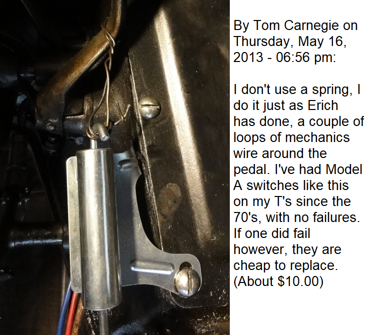

I use the 1928-29 Ford Model A switch mounted to the bottom screw on transmission door with a stiff wire between it and the brake pedal. Did the same on my 1920 Dodge. Have seen this used on several other Ts. Have had no issues even with it mounted with just the one screw.

It would be fairly easy to duplicate the Fun Projects design. I would change the push switch/linkage to a simple pull type switch which would eliminate the need for the lever linkage. Pull switches are available on the internet, but, probably not in the big box stores

The simple one fitted to the inspection cover works well. Lang's sells this style, a copy of original one. Easy to adjust the location of the push switch as it is held with a single nut, adjust to outward travel of the brake pedal.
Of course you have to remove to inspect the oil screen, but no big deal if you insulate the terminal wires to prevent contact, or remove the yellow wire from the gang terminal on the fire wall, that shuts off all DC voltage.
As for the Bendix cover version, the contacts and insulation washers in that made in foreign land are poor, and have had one cook itself when connected to dual brake lights, too much amp or something, didn't last long.

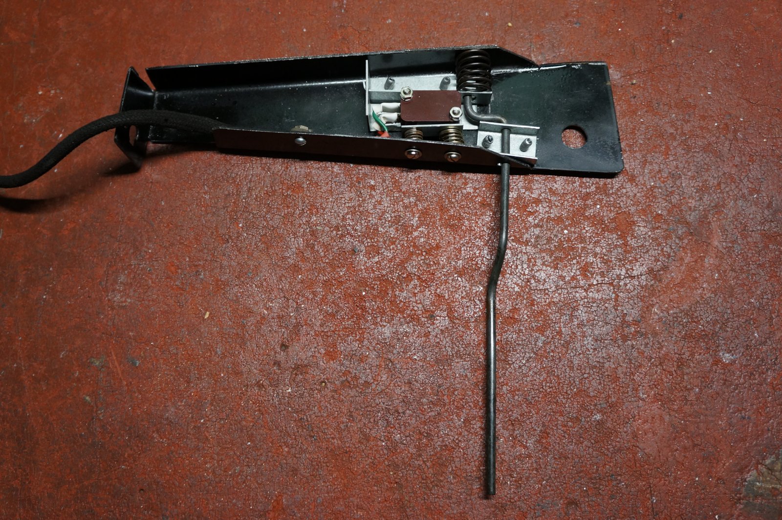

I made mine with sheet metal scraps bent to make them rigid. A wire from the brake pedal pulled a lever, which pressed a button on the least expensive momentary switch I could find at the hardware store. I am currently in California. If I were at home in Kansas I would show you a picture.

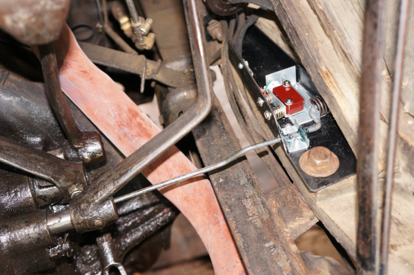

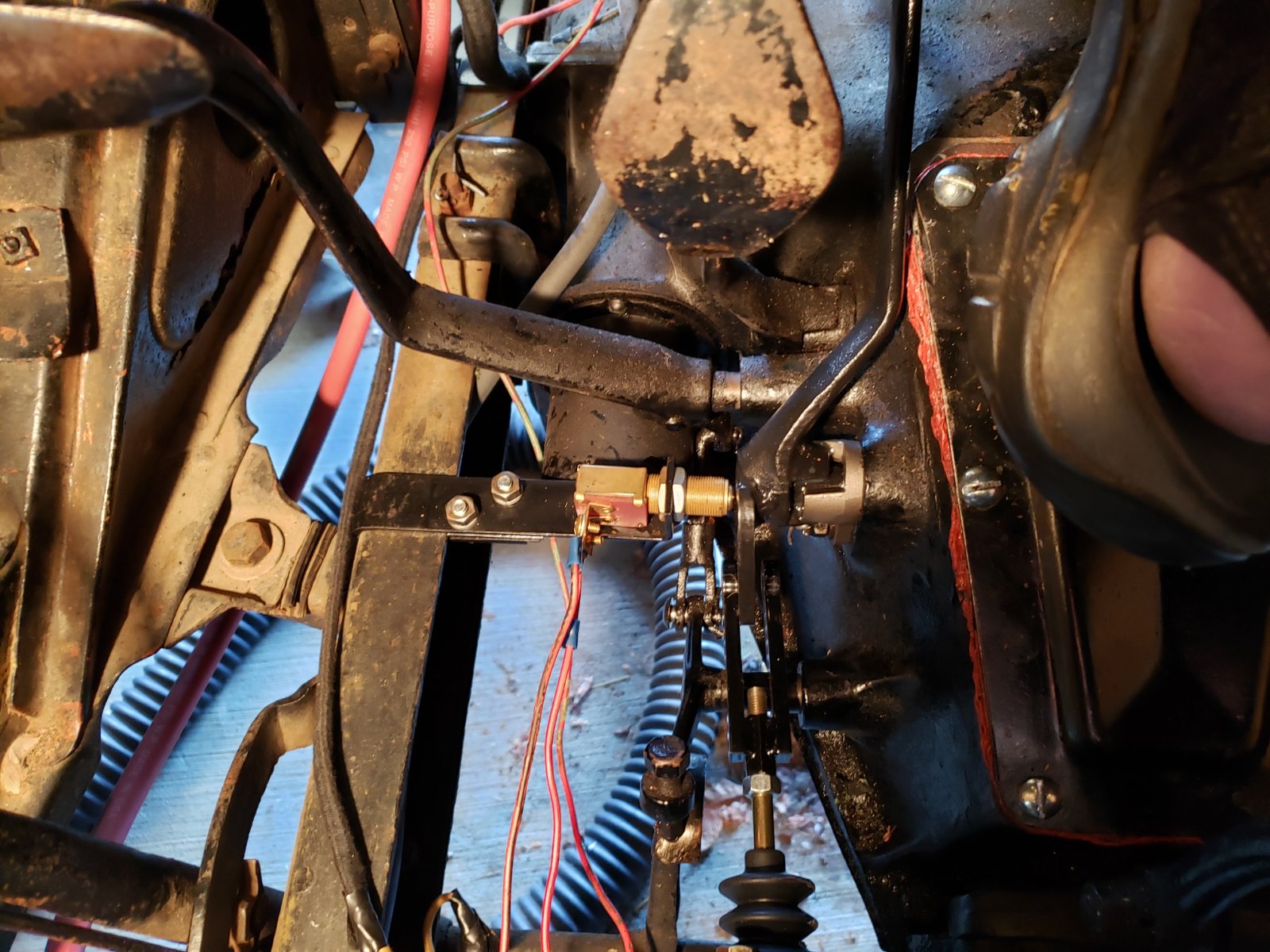

Can't remember which vendor I got this switch from but no drilling required and very easy to adjust. The bracket just clamps on the frame. For me, was the best option I found.

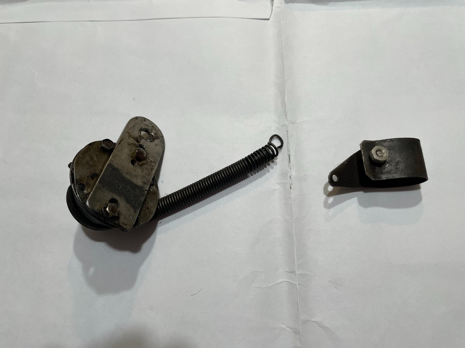

Tom M. wanted a Fun Projects switch, so I looked thru my spare parts and found this one I no longer need. It is used, and worked. I went a different route when I changed wiring. I offered it to Tom a few minutes ago...not sure if he found something else. Let me know if you are still looking and if he doesn't need it, I'll let you know. Best to reply to me thru email. addufo at g mail dot com. without all those spaces of course and the usual internet symbol.

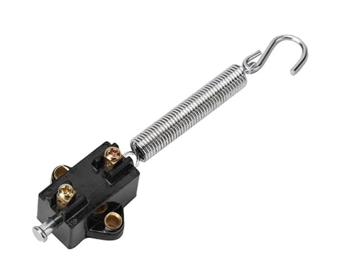

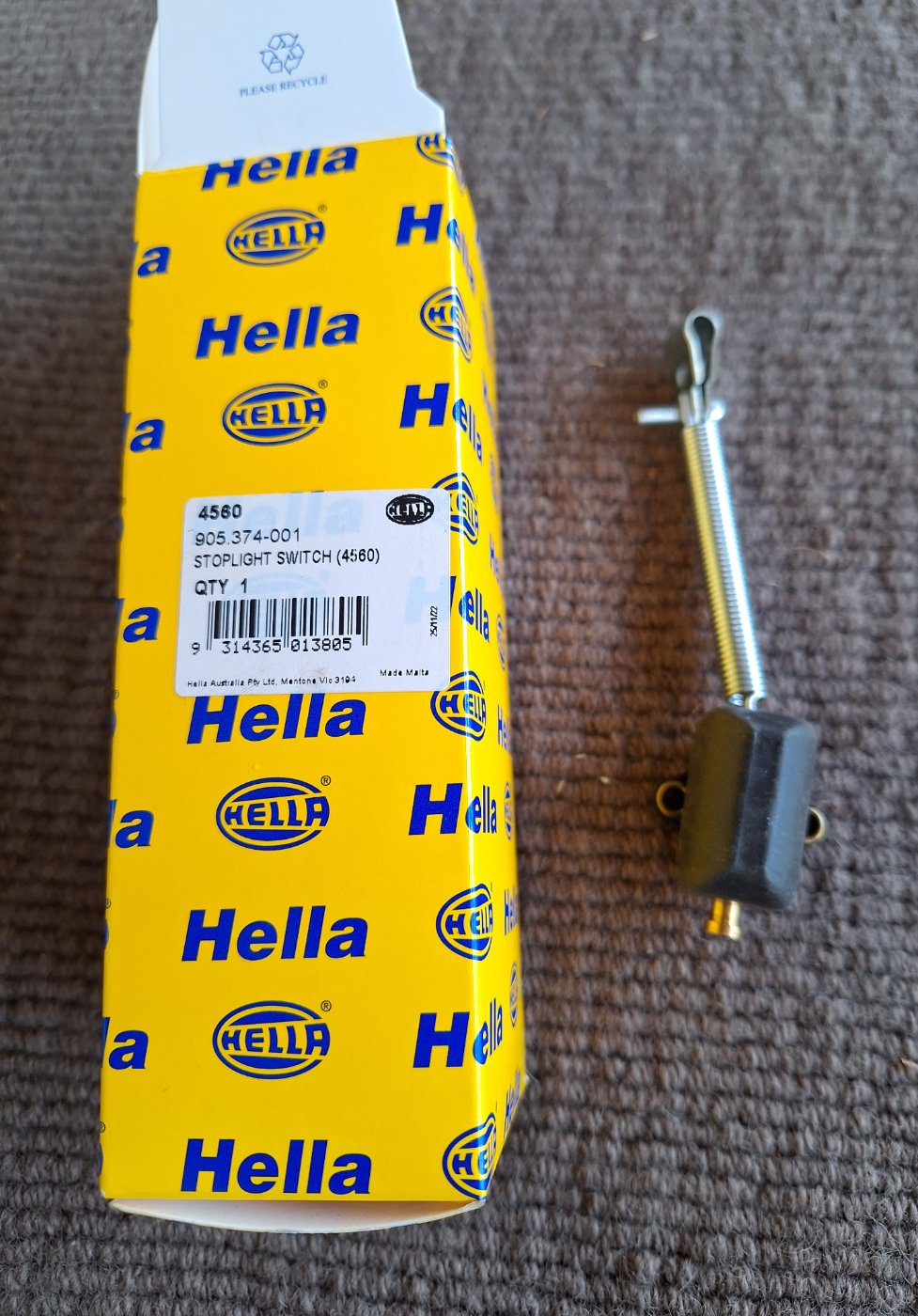

This quality Hella switch is readily available in Australia.
I fix the switch body to a small bracket on the frame rail, and connect the spring to the pedal arm with a simple length of bent wire .
The position of the bend is used to set the "pull" on the switch.
Otherwise, I use a switch like the on Mikey 1968 shows . I have a few metal bodied brake light switches from 70"s 80's Japanese cars in my stash. These mount in a clamped on bracket like his. The beauty of these is the stem of the switch is threaded so the switch can be adjusted in or out to set its activation.
You could use a more modern plastic bodied brake light switch but these clip into a fixed bracket set at just the right height in the car. You would need to make your bracket adjustable to set the switch correctly.

Saw this on Amazon for $8. Wouldn't it be easy to bend a piece of aluminum (steel, brass, etc.) to a not quite 90°, attach the switch to the horizontal and place the vertical under the top-left bolt on the ball cap (like the fun projects switch?) You could use a piece of safety wire to attach the switch spring to the pedal. With the switch mounted that way it wouldn't interfere with removing the tranny cover.
