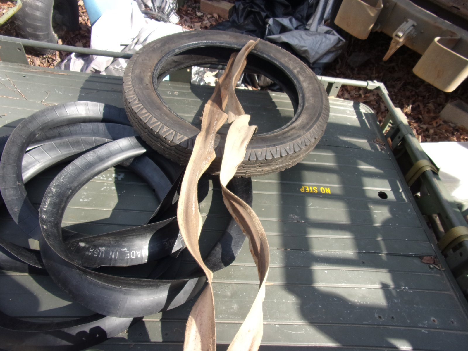

Don't flame me for bringing up the dreded tire flap topic, I've made the decision to use flaps on my 21" demountable rims. But, my question is . . . I have obtained the typical rubber tire flaps as well as two canvas strips that were used as flaps at some point in time. This is new to me, not being rubber. I obviousely have four rubber flaps to use, but the canvas flap intriques me as these will go on my WWI ambulance project. Adn, a military or Red Cross motor pool would have used the resources available to get a vehicle back into service. So, these canvas flaps have seen their better days and I would not reuse them, but use them as a pattern to reconstruct new canvas webbing flaps.
Is there something I need to be aware of in attempting to use canvas webbing instead of rubber? Moisture retention? Scuffing?
I will sand and treat the rims prior to installation to get them as smooth as possible and my experience in the WWII combat rim flap installation is that 75 prcent of the requirement for them was not pinching the tube during installation and 25 percent tube protection during use. So, I'm thinking the same.
Thoughts?

They may very well be felt. My wife felt them and believed them to be covered with flannel as the inner side that was not subject to metal rim exposure feels fuzzy. And, yes, I thought it was formed that way after decades of use, but they could be thicker in the center and thinner at the sidewall tucked in edges.
I'm not hearing that moisture retention is a concern. If it was, I was even thinking nylon web strapping to use as a flap.
Yes, I have the rubber flaps. But, perhaps someone else can use tthem as I have the resources to consider another option. And, I like the canvas web strap story in my military vehicle. This is the look I am going for. I just presumed the spare tire mounted on the side panel of this example was a demountable as it has no wooden spokes. I guess it could be a clincher tire, but don't know why they would carry one that needed an entire wheel disassembly.

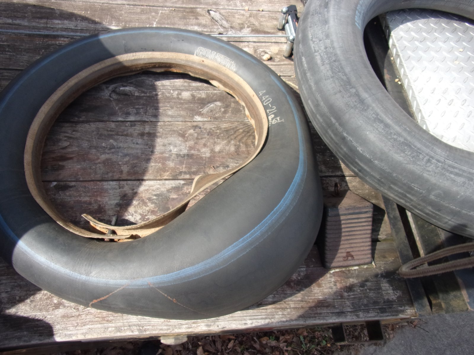

The original era cloth/canvas/felt liners I have seen were well made, formed to fit the compound curvature inside the tire, and far superior to any rubber flaps I have ever seen. The 1927 Paige my dad bought over fifty years ago had several original tire liners in its wheels. I still have them, some inside the newer tires on the wheels now.
If they are in good condition, keep them, maybe use them, whether on this T or another car, doesn't matter. They are an example of how things were made back in the day, but not some sort of battle zone "make-do".

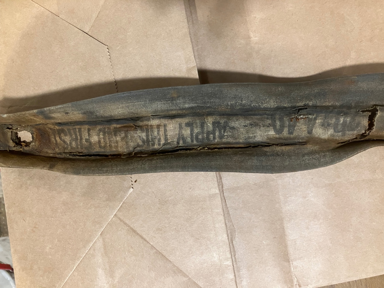

Look what I found! An old ripped up flap…. It says “20 x 4.40 APPLY THIS END FIRST”. It’s a 1/16” thick X 3” wide piece of rubber tapered down to nothing on the outside edges wrapped in a thin canvas type material.

Sorry about the upside down picture…..
