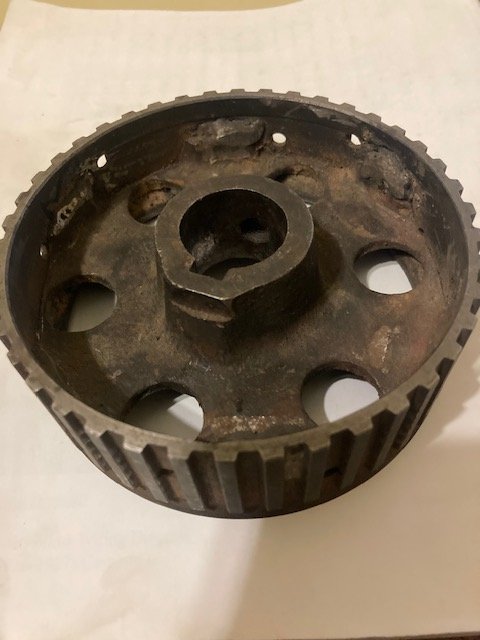

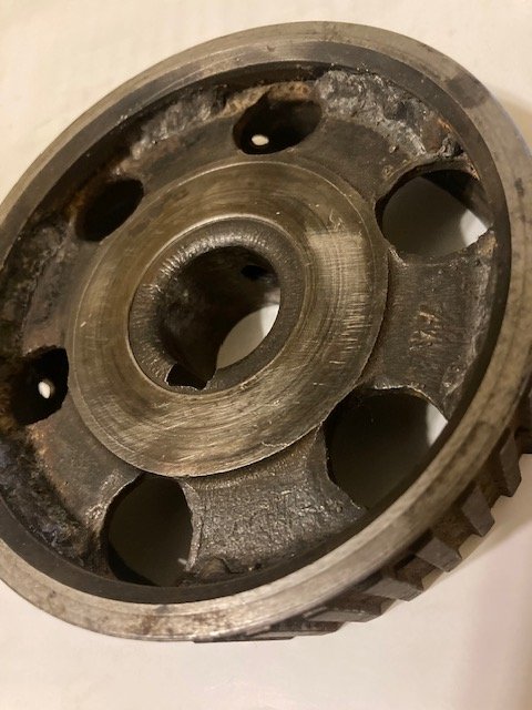

If the turbo 400 hubs are not being made anymore. This may be a solution ( I picked this up some time ago)
It is a 400 hub machined & welded into a T hub. I have had good luck with cutting the teeth out of stock 400 discs but it is time consuming. I have
