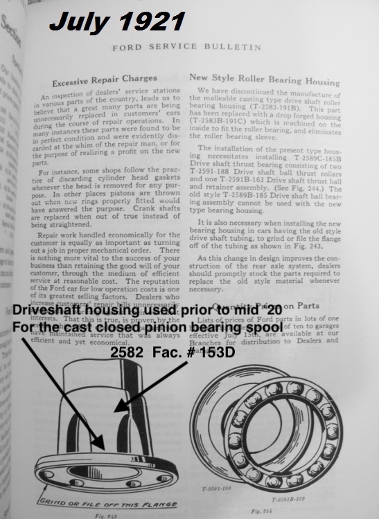

As Allan noted
About mid 1920, the new design forged steel 'open spool' pinion bearing housing, where the housing bolts are exposed going into the axle halves, was introduced. The torque tube or drive shaft housing p/n 2582 was also changed to Factory # 153B to eliminated the ring or flange that contained the older style malleable cast iron 'closed spool' that hid the housing bolts.
The earlier 'closed spool' and parts were discontinued. Using a new 'open spool' as replacement on an older Factory # 153D housing this bulletin noted to remove that flange to use the new style housing.
Flat surface of the newer style drive shaft tubing, Factory # 153B
- Attachments
