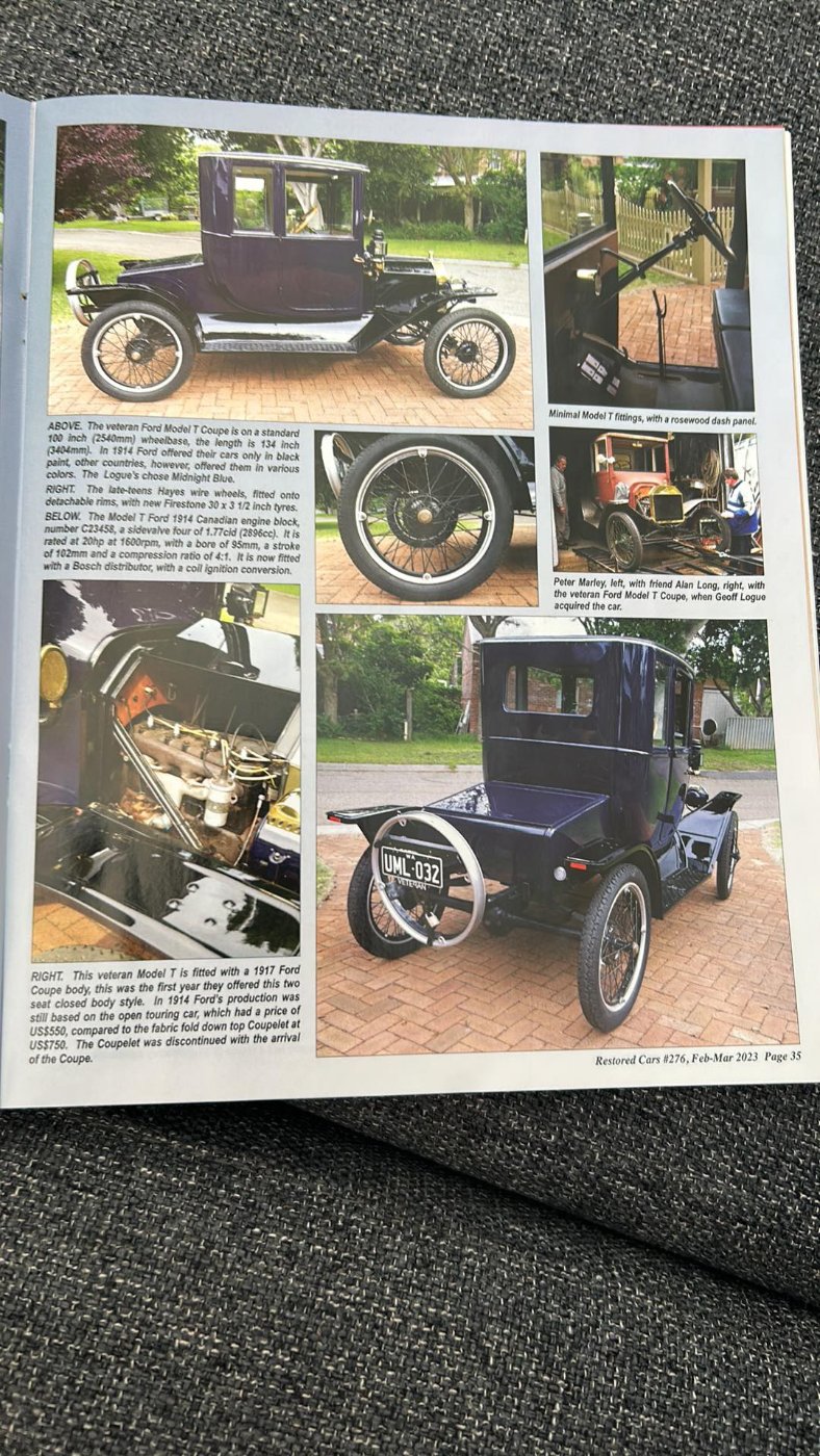

At least a couple of people in Australia have converted the later coupe to earlier looking cars. Depending on how far you want to go, at the very least you need to fit the 1915/16 hood former, maybe change the fenders to the earlier 1916 style, get a new hood and wooden clash strip are you are good to go. I have attached a picture of a later Coupe which was made to look like a 1914 Model. Nicely done and a very unique T,but not correct. Good luck with your project.

Tsk…Tsk…Butcher job. What a shame. Pre ‘23 coupes are fairly rare.
