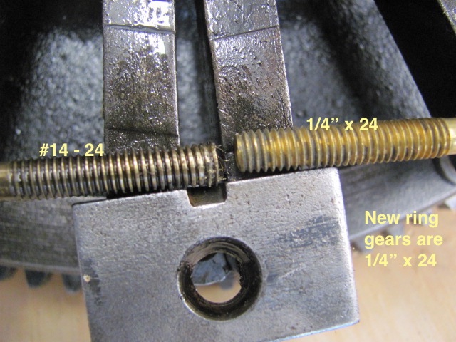

Also, care as noted to use the modern repro 1/4" x 24 brass screws for new repro ring gears.
Original ring gear and brass screw threads are obsolete #14 - 24.
My experience was bad with loose magnet clamps hitting the field coils, no fun, had to replace all the screws. Builder didn't know the new ring gears are made with 1/4" x 24 thread, and used NOS original brass screws in the obsolete thread form....you can see the result, the screw fit, but soon got loose, likely too by smacking the ends of the brass screws, so they readily de-formed as they weren't a match to the new ring gear.

FYI- per the American standard screw thread standard, machine screws start with size 0 and a major diameter of 0.060" . each screw size adds .013" to the major diameter. EX: a # 2 machine screw has a major diameter of .060" + 2*.013"=.086"
A # 14 machine screw has a major diameter of .242. Measuring taps can be a bit problematic / misleading because a tap has to cut some clearance in the root of the internal thread. Hope this helps a bit. The difference between the #14 and 1/4" screws is not much, but it does make a big difference in a critical application like our clamp screws.
