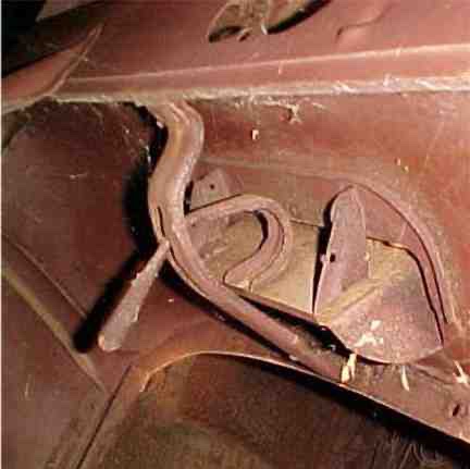

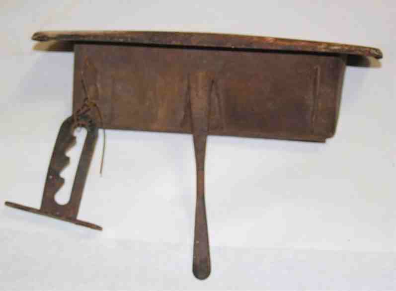

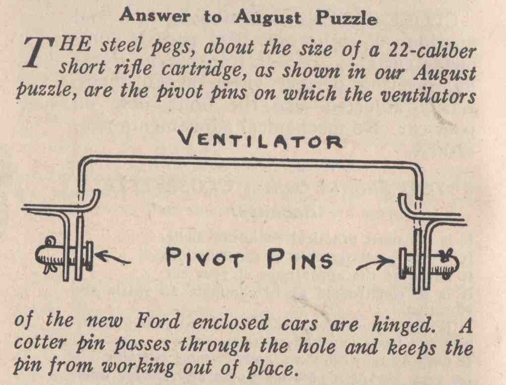

Here's a few photos of the assembly for ref.
25 coupe vent inside.jpg (35.5 KiB) Viewed 1186 times
