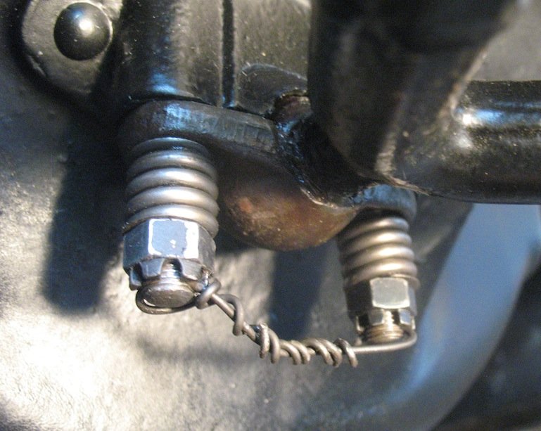

3. Put the floor jack under the wishbone ball and attach it to the oil pan. Wire the bolts together.

See this diagram for proper perch orientation. The axle should lean back to give the proper caster angle. The nuts and studs that clamp the wishbone ball should be wired together, do not use cotter pins because the studs could still back out.
