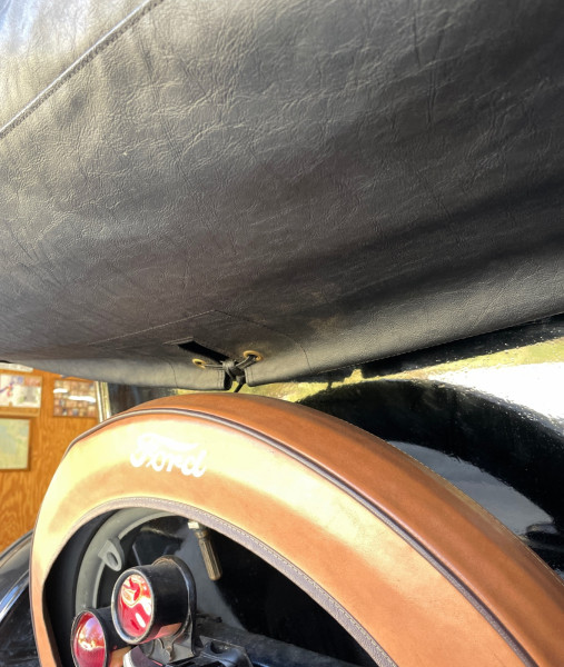

I put a boot on my top to try to keep it cleaner while driving gravel roads but notice it hangs down on the spare tire thus creating a kind of air scoop that also scoops in dust. Is there some way to cinch up the bottom of this boot. By doing so, it would also cinch in the sides a little. This is a very nice boot by Classtique. It has three straps that are fastened to the top side that go over the backrest the down to the lower tack board. Any response us greatly appreciated!

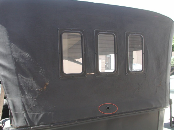

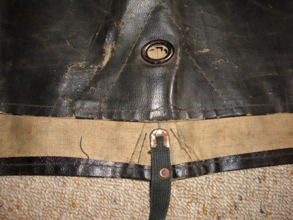

I imported the photos from the thread linked above, I have those photos and more of this same point, but I have not transferred all of the photos from the old computer to the new one yet. Without that pass through hole/grommet for the center strap, it is going to form that "scoop" at the bottom, not as pronounced on the Runabout as a Touring, I'm sure. Here is one photo (17-22 style top) without the hole/grommet for the top boot strap to pass through:
When I received the top boot I had ordered for my Runabout I removed the web straps that came on it and I found the correct width cotton webbing and buckles to replace what it had come with, no luck on finding the tips though. For the ends of the straps I used the metal ends for military webbing, not correct I know, but you are not going to find the original 5/8" tips. It was supplied with Lift-A-Dot fasteners to attach it to the seat frame, I chose not to use those. The top boot came with 3/4" wide webbing and it was not cotton, I also added in the re-enforcement stitching around the webbing (as shown in the 2nd photo) and riveted the strap in place. I have photos of it all, but on the old computer.
