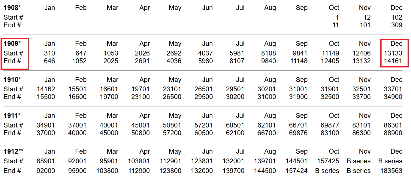

Since engine number 13213 would make it a 1909 . Since "13 213" is not a 1911/12 engine number, it can't be a 1911/12 body if engines & body numbers were to match during that period. Pictures of the body would help
