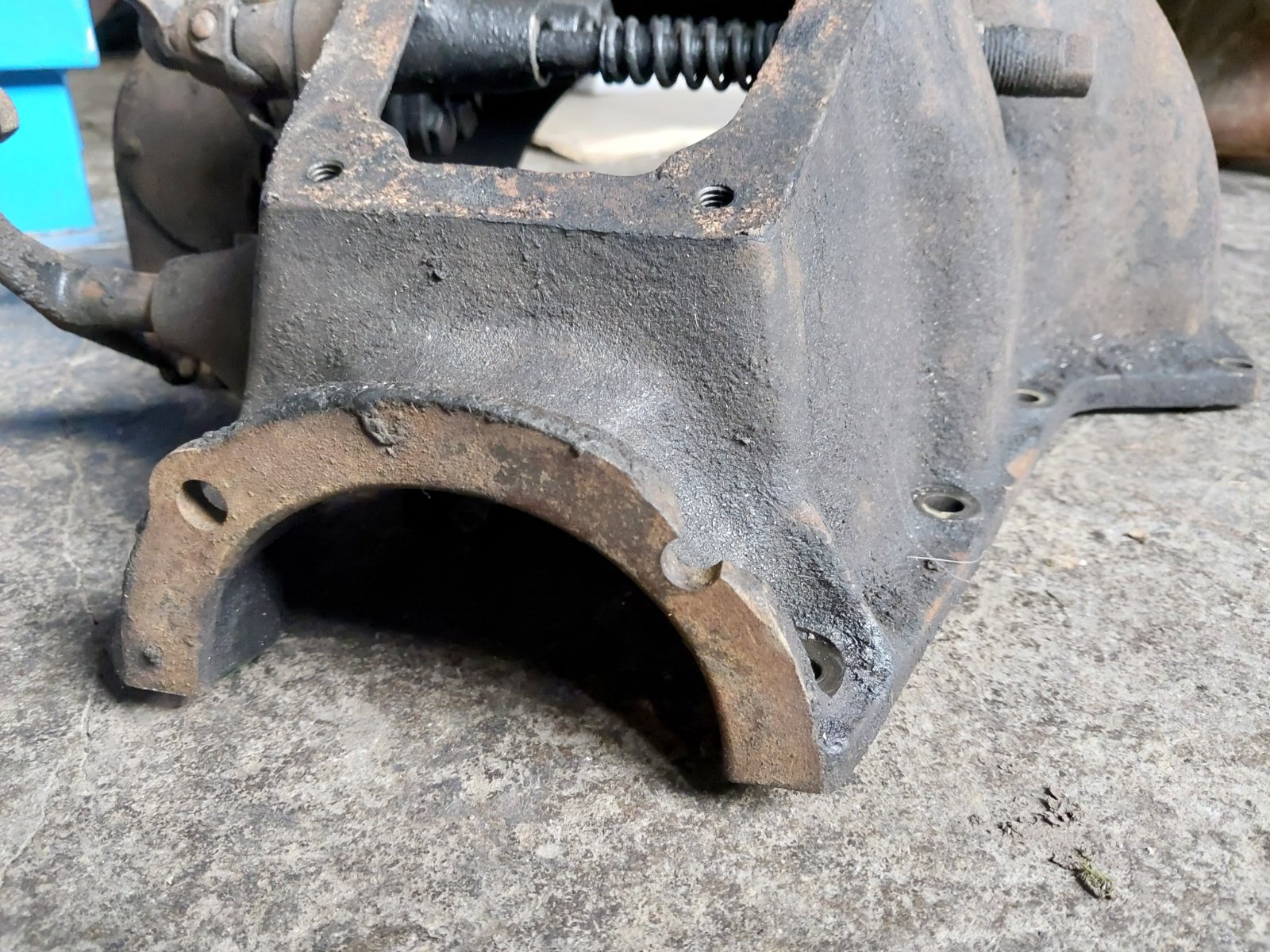

Can anybody help me further? What material is the hogshead made of? Can it be welded?
I have a hogshead with tight pedal shafts, but unfortunately a corner on the back broke off during the drilling.
Can I fix this?

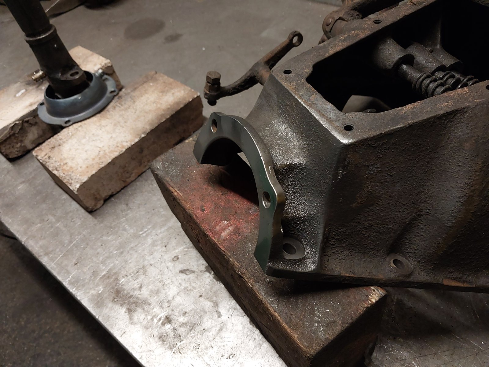

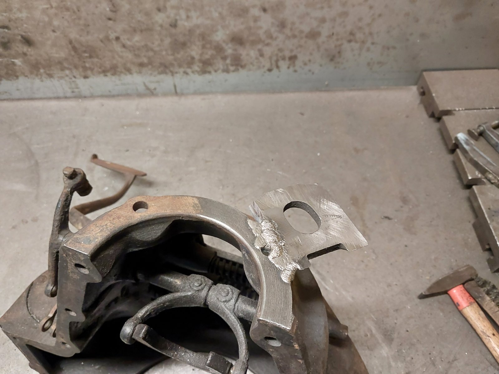

Thanks for all the many answers. I took some time today and did it as Andre described.
I got some cast electrodes, got a piece of cast iron from the scrap metal and slowly welded it on. I made sure it didn't get too warm and always hammered the seam as it cooled down.
The excess material is then sanded off.
I am very happy with the result. How it holds up remains to be seen...

I used pure nickel stick electrodes from the local tool store.
The standard designation is:
(EN IS0)E C Ni-Cl 3
AWSA5.15: ENi-Cl
DIN 8573E Ni BG 11
Maybe that will help.
