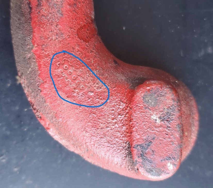

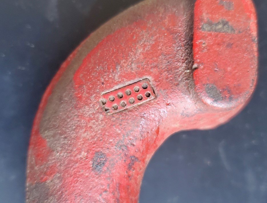

What are the rectangle and dimpled inclusions on this intake manifold from or for?

casting chaplets used to stabilize the core.
