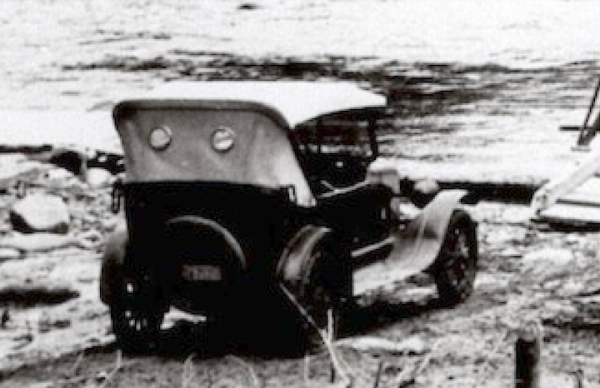

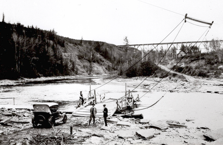

I think not, but I'm captioning this photo for our local club newsletter and would like to be sure. The photo is dated August 1921 and the setting is the Pembina River at Evansburg, Alberta. The ferry was replaced by a single-lane road bridge in 1923.
The rail bridge in the background has an interesting history... it was built in 1909-10 in Scotland, disassembled and shipped to Canada and across the prairies to end-of-steel at Evansburg, then erected by means of a temporary wooden trestle bridge. Railway line construction continued from there, eventually reaching the ports of Prince Rupert and Vancouver in British Columbia. This single-track Evansburg rail bridge (at 214' the second tallest in Alberta) is still in use on the Canadian National main line and carries an average 20 trains daily.

It's not a Ford automobile.

Isn’t that a Dodge? The front hubcap looks like a Dodge Brothers.
Posts: 8511
Re: Is this a 1921 or older Model T?
Post by TXGOAT2 » Wed Feb 28, 2024 3:51 pm
Dodge fenders look a lot like late Ford T fenders.
Posts: 5510
Last Name: Gregush
Location: Portland Or
Post by Mark Gregush » Wed Feb 28, 2024 4:13 pm
Not Dodge Brothers. The spare tire would be slanted out at the bottom because of gas tank location and unless Canadian DB's had different windows, not DB.
Posts: 8511
Post by TXGOAT2 » Wed Feb 28, 2024 4:23 pm
Dodges had the gas tank mounted between the rear frame horns. They had a small, box-like cover at the rear of the running boards that gave access to the forward rear spring pin lubrication point.
Posts: 4642
Last Name: Kuehn
Location: Texas
Post by John kuehn » Wed Feb 28, 2024 5:45 pm
Anybody else have an idea what the car is? Not a Ford or Dodge evidently. But a car around the same size.

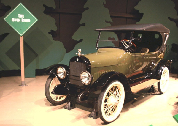

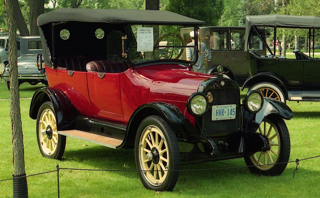

My quick guess would be it is a late teens or early 20's Gray-Dort assembled in Ontario from American Dort parts, Gray having no relation to the Gray engine maker. Here are some photos I pulled from Google and a little snippet of their history: https://www.vdfhs.com/resources/5252/20 ... fGray.html
Thank you for the post and history! Always good to learn about the past no matter where or when.
