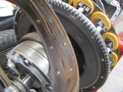

First placed the wood lining inside the band, and fitted it end to end, and clamped that wood to the band, firmly. Next, using a Magic Marker, put dots on the wood lining where the holes were in the band.

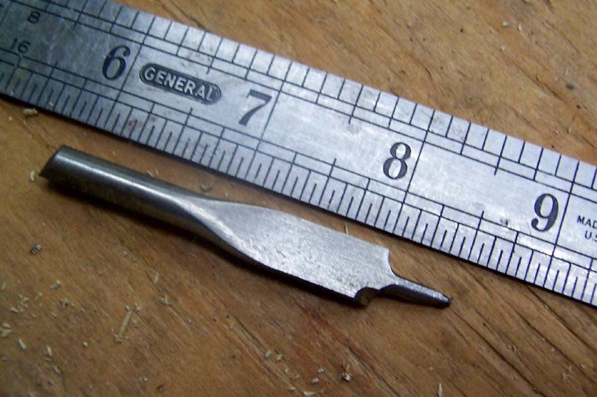

Then cut down a counter sink tool, by using a small wood bit. That fit short into the battery powered hand drill.
Then drilled first from the outside to make 'pilot' then drilled from inside the wood lining, with the lining supported on the work bench. Made the holes halfway deep, and that pilot tip on the drill followed through the little holes first made in the wood lining. The little pilot holes were sufficient for the tangs of the brass rivet to be placed.
The wood linings were 'springy' enough to spread open and use the hand drill on the bench, didn't need a drill press. Tolerances aren't needed ;)
Once all the holes were counter sunk and drilled in the wood lining, clamped the wood lining to the inside of the metal band, holding it with small spring clamps. Then placed each rivet while the wood lining was clamped to the band, and folded over the tangs sung against the metal band.
Note the tang of the brass rivet on the metal band.
