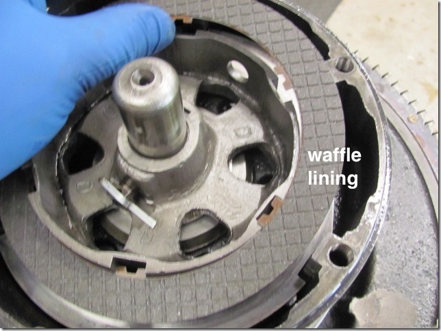

The Jack Rabbit is a modified Turbo 400 disc, by cutting away some of the disc fingers to fit the clutch drum.
For all practical purpose the Jack Rabbit and Turbo 400 are the same game. (Except you can't use a Turbo disc as supplied by auto parts stores without cutting away some of the disc fingers.). So the name is the same if the part is made to fit the Ford clutch drum.
The better discs are the gray color High Performance waffle groove discs, they cost more than the regular grades of Turbo 400 discs made by many companies. Have used these type discs for years, and no issues. But be sure to measure thickness of worn Ford large discs to sandwich the small turbo disc to get the proper stack height. I try to use large discs in the same thickness range.

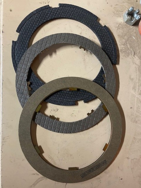

I seem to be a little lost on the clutch name issue
The one on the top is a Watts. the one in the middle I made from new Turbo 400 clutches. the one on the bottom was what I received when I
ordered a Jack-rabbit clutch from one of the venders. When did the Turbo 400 clutch start being called a Jack-rabbit? And it appears the
bottom one is not made from a Turbo 400 as there is only 6 teeth instead of 12?
Craig.
