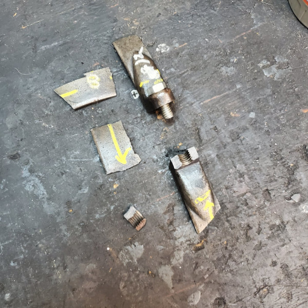

I accidentally dropped my KR Wison transmission jig and broke it. Looking for someone to expertly repair it. Any suggestions?

Perhaps the stitch-n-loc on the larger pieces & weld the smaller pieces but I think the integrity of the mandrel might be compromised. I don't recall if they are cast iron or cast steel - used to be a method to verify by the color of the spark it throws off when hit with a grinder wheel.

#&@%X!!! More like shattered! I wish I knew how to help or what to say. Good luck.

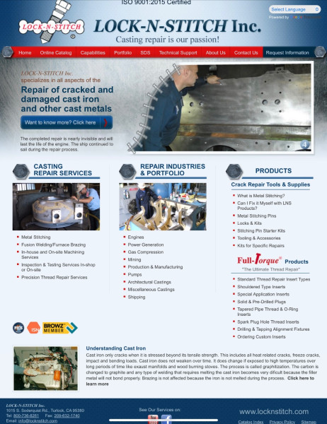

I would agree that lock n stitch is the way to go. They are in Turlock a couple of hours from you. Welding is too iffy regarding distortion and finding an experienced cast iron welder who understands the heat process would be difficult.
http://www.locknstitch.com/cast-iron-welding.html

Can you put it back together tight, glued with epoxy and the pieces clamped in place, then v out the cracks on the inside as deep as possible without compromising the repair then take it to a machine shop that has experienced welders to fill the V’d out cracks, then machine the weld smooth. Once the inside is done you can do the same procedure to the outside of the part. Machine shop workers like a good challenge. Jim Patrick

These are cast iron- cast steel would not break like that. Any welding is going to distort the fixture and destroy the precision needed for it to function properly without remachining the casting, and that simply may not be possible.

It’s grey iron. Even if it could be welded it would be more fragile than it already is. It needs to flex a little and with worn undersize drums it needs to flex a lot. I’m afraid any repair is unlikely to hold up. If a professional could fix it, I would bet the repair would be more expensive than buying a different one at the going rate.
