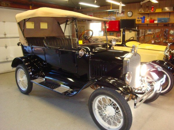

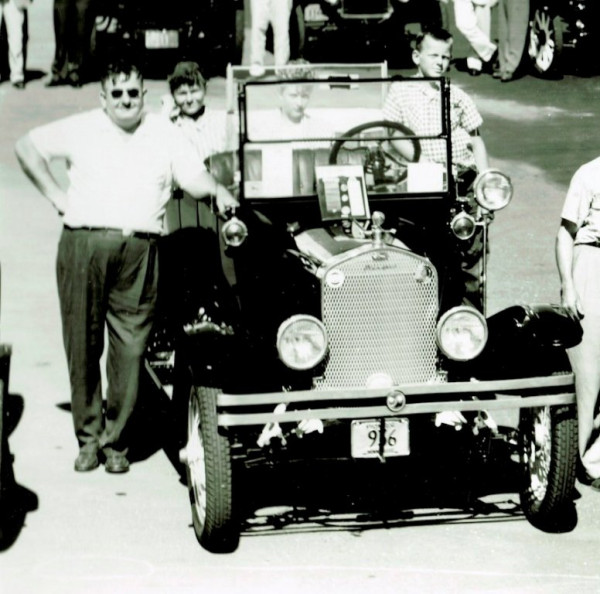

The late Louis Seekon of Minneapolis, MN had a 1924 touring that he dolled-up with a number of accessories including a radiator stone guard.
He was a talented fellow.
Instead of being a period accessory, he may have fabricated the stone guard himself in the 1950s using off-the-shelf materials. The main part of the stone guard was flattened expanded metal sheet/lattice that you can still purchase today. I can't remember if the trim around the perimeter was flat metal or a split tube.
If I recall correctly, it had a three-point mounting - one tab each for the left and right radiator/radiator shell mounting studs and nuts and collar that went around the base of the radiator neck.
The first photo below was cropped from a panoramic photo taken in 1959. The second photo is of the car that I took in 2016 when it was still in Minnesota after Jeff Perkins acquired it - sorry about the poor quality.

Wow, gotta wonder how the restricted airflow affected the cooling...the guard looks nice for sure, but also looks like at least a 50% reduction in air flow. Better have a flat tube radiator!

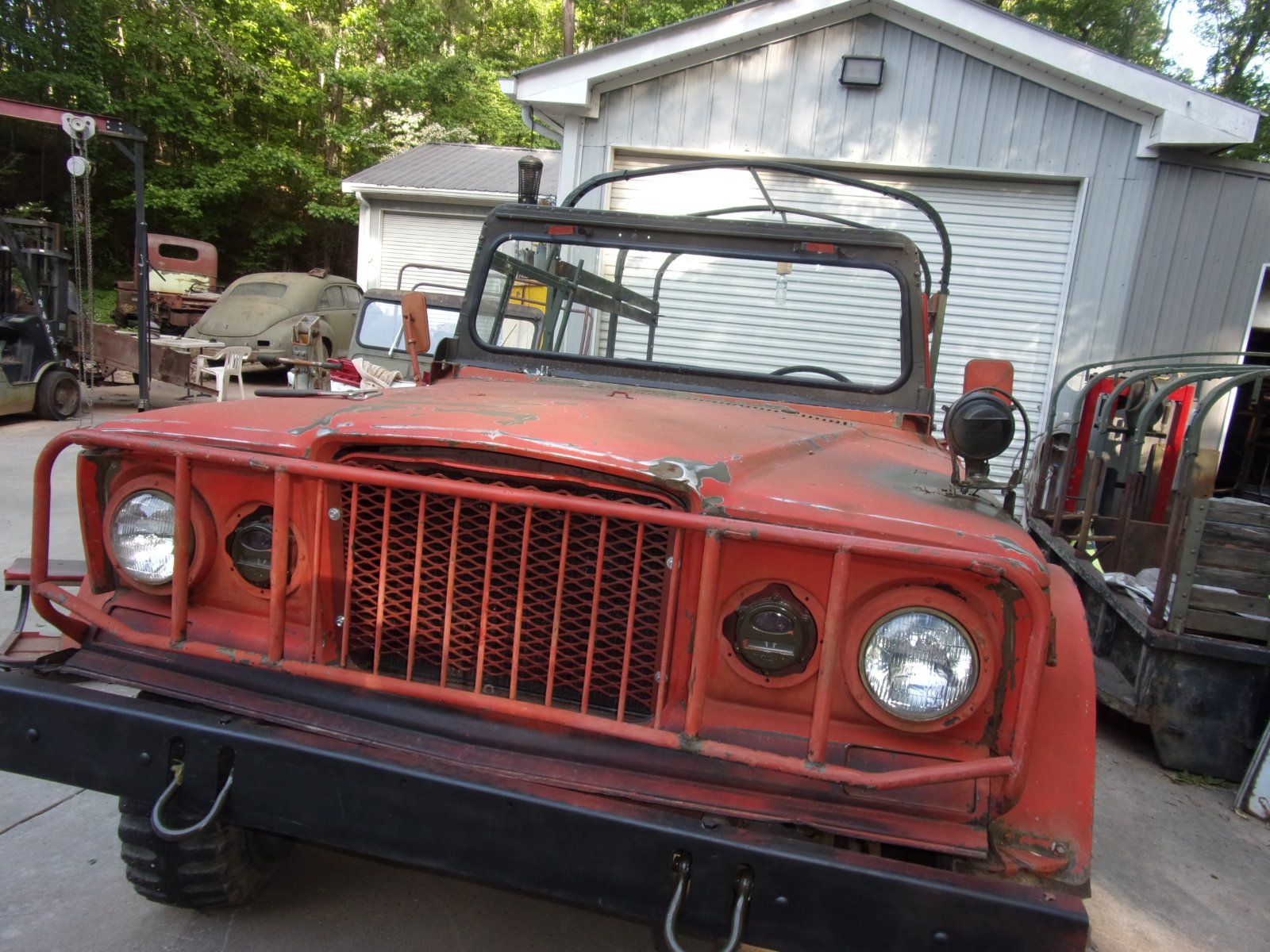

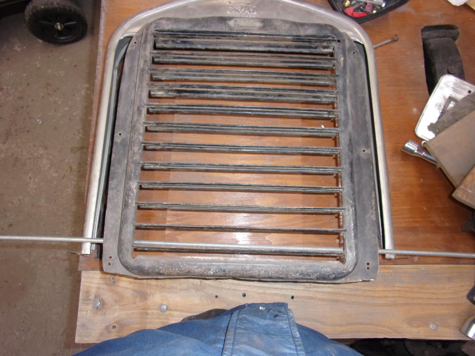

I have installed a radiator shutter on my WWI ambulance project. Not that it gets that cold down here in GA, but I like the look of an "armored" radiator on a military type vehicle. Even in the open position, it looks like it will provide some protection. On my 1967 Kaiser M715, the military installed a brush guard for the radiator, but no protection for smaller debris, so I installed some wire screen, using existing grill holes. I am considering coming up with something like this screen for headlight glass protection for the ambulance.
Just some more food for thought.
