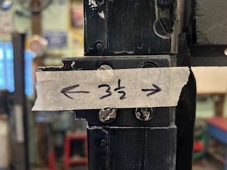

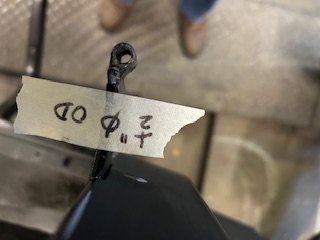

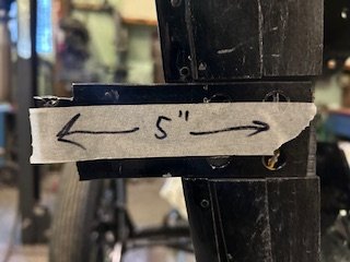

to everyone that has a fordor. I need the top and bottom door hinges . They seem to be the same on each door just flipped over. Its a 26. The part or barrel that the pin fits in is 1/2" od. I have found some 5/8 " od but they are not the right ones. Can someone help me. I will also post this in classfieds

I have the hinges. I have a coffee can full of Fordor parts from a cut-down car that my uncle built into a depot hack in the 1960's. He had scrapped the body and saved the hardware. Send me you address and I'll ship them.
