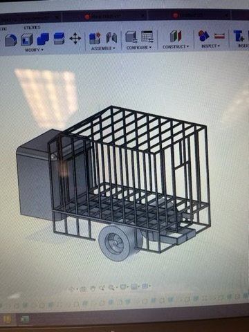

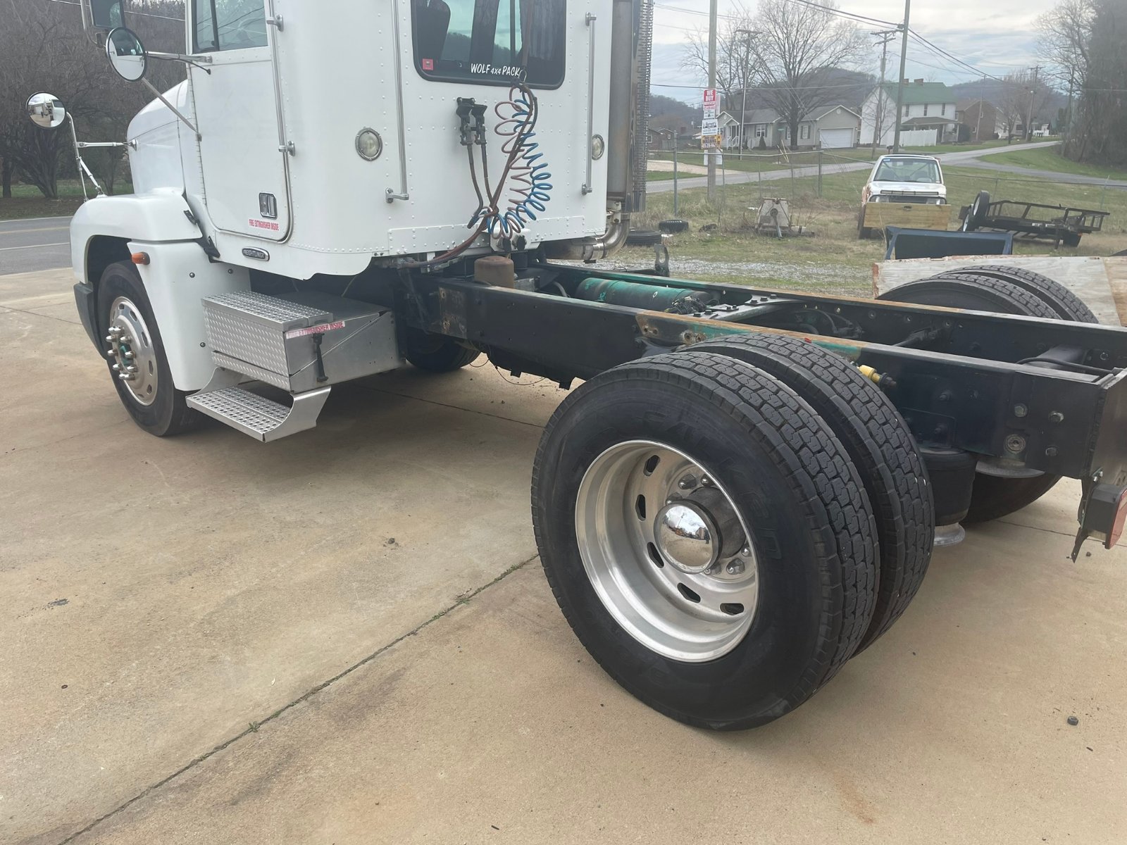

We are building a larger 'tow truck' to pull our enclosed trailers (-which will be used for hauling Model-Ts and parts ;) ) -and with the purchase of a Class 8 truck we are now building a 11½ foot box that will effectively make this truck into a RV Toterhome. l have seen where a slab of wood is used between the frame rails and the box frame to eliminate squeaking & slippage. Does anyone know what type of wood is typically used for this application? Would Ash (-since I have an abundance of that species at my disposal) be suitable for use in this area??

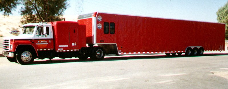

Yeah Craig, with my mini-semi rig that I had back in the late 1990s/early 2000s was just like that where I always had LEOs not quite sure what to think. When we were doing the GreatRace, it was always a hassle even with us being a private vehicle. I have had a couple other rigs since then with my last one a F450 and a 32' trailer, and the LEOs have started to turn a blind eye towards us. In the racing world we play in, there are guys with 50' long toterhomes pulling 40' trailers traveling up and down the roads. These rigs are more than 30' over legal limit, and they roll right past the scales without a problem. Below is a picture of my rig back when we were doing the GreatRace each year, and a box truck we built to haul a car inside. The last picture is of a friend's new rig that is 80' long.
